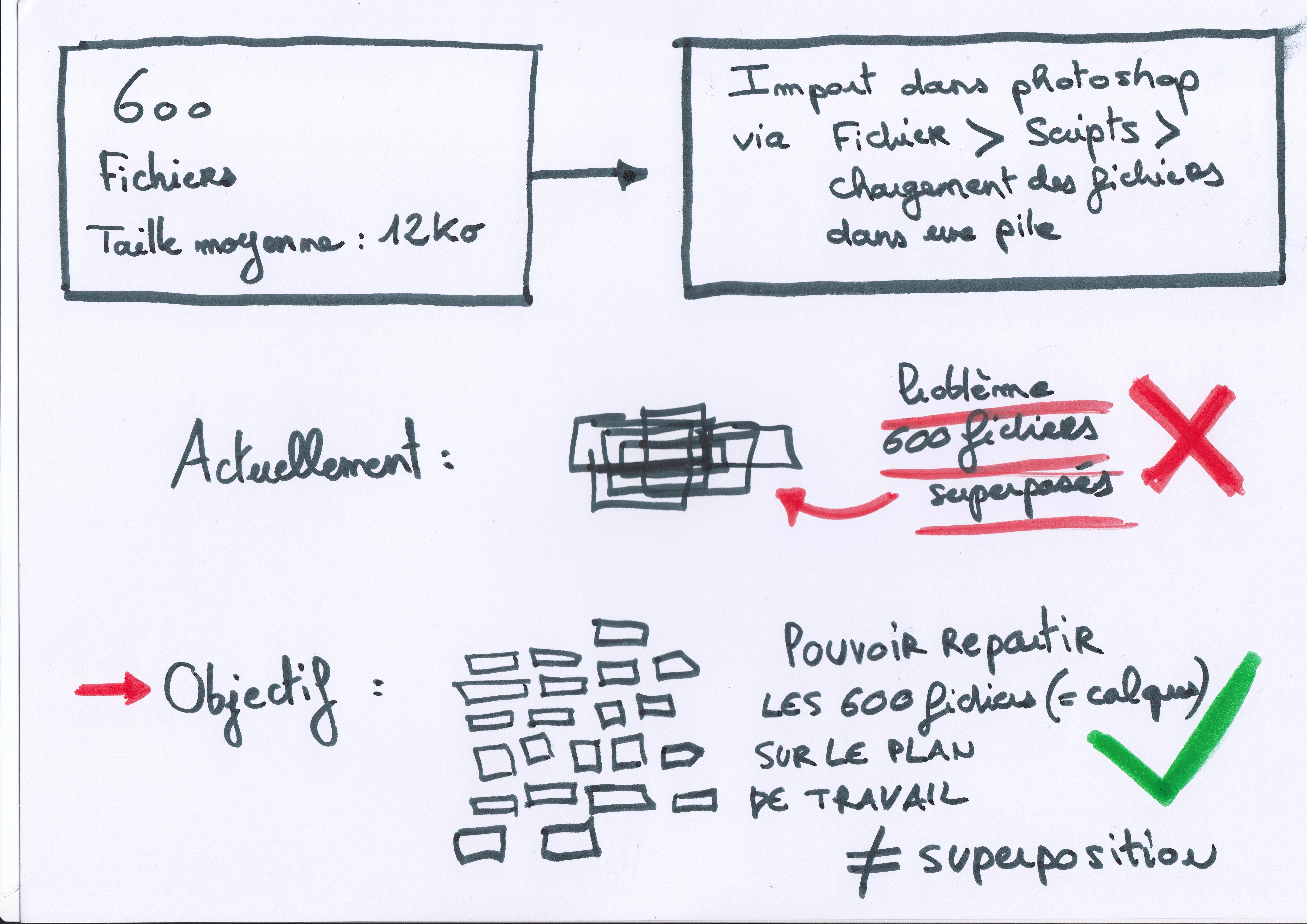

I need to import 600 images per day (12 kb .png on average, small images, but massive quantity)...
I need to spread them on workbench without overlapping theses elements (edit : and keep power to move images one by one after have all spreading). >> Idealy spread and ajust spacing between images as if they were in a board with column and rows - and keep images files separatly in layers - will be great ! An interactive contact sheet is possible ? <<
Until now, I process like this for have theses files in differents layers :
File > Scripts > Load files into a stack > Browser (Selects files) > Press Ok

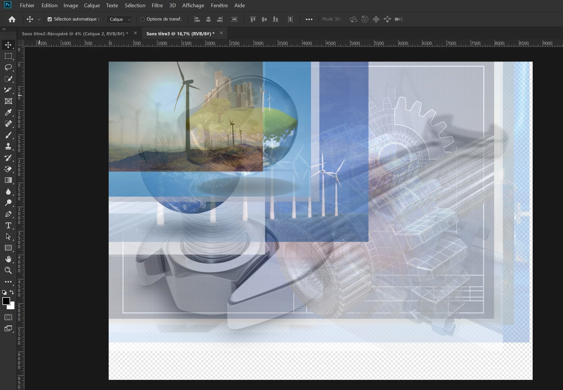

Then, I modify workplan size for have a large space but files in differents layers are overlap.
It's ennoying, I need repeat this operation every day with others files like this so it's laborious to make it one by one with hand.
Does anyone have the answer? I have maked a drawing in french for explain and screenshots for be more clearly.
