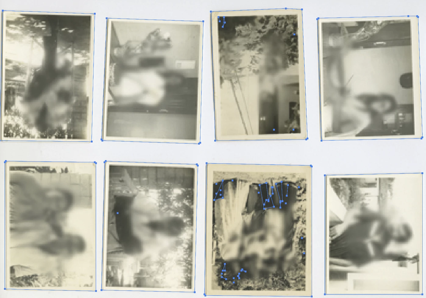

Straighten photos and save photos in same directory.

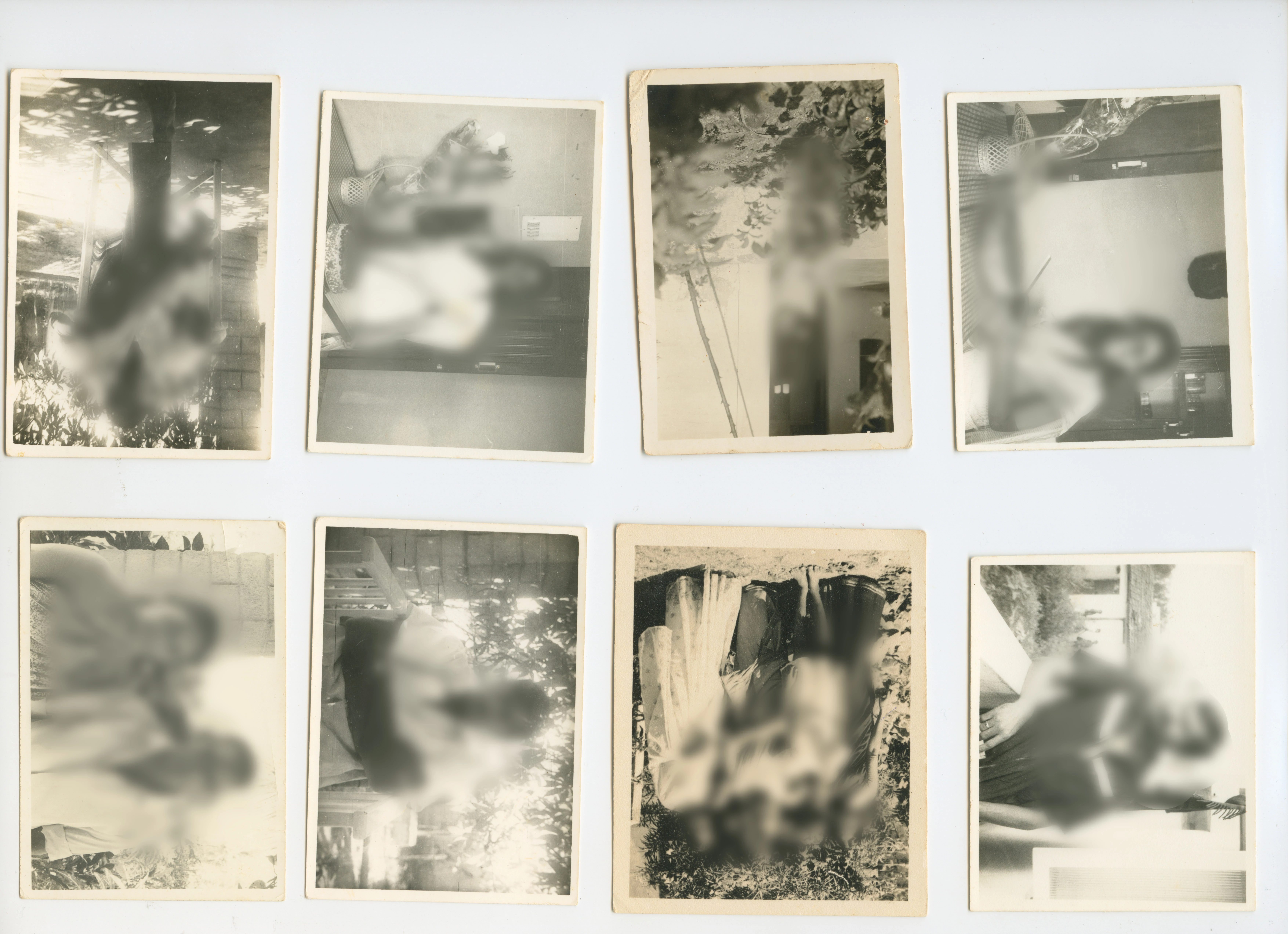

Hi, i have a bunch of photos which are all scanned with 2 or more images in 1 scan. Hoping to use the Automate script Crop and straighten photos.
1. The result was not ok for some photos even when there was enough seperation around the edges.
2. Also it seems i need to save each cropped file.
Looking for a script that would do both the job (crop and save photos ). Thanks.

Aug 1, 2025 7:10 AM UTC

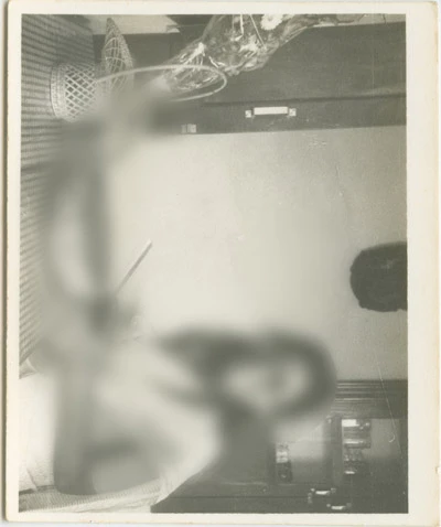

Also would like to rotate the images upright position. Thanks
Aug 1, 2025 9:31 PM UTC
The problem is close to what we did here Straighten multiple layers inside photoshop , but the photos are arranged chaotically that it complicates the task.
Immediately introduce restrictions:
  • we can not recognize the orientation of the photo depending on what is depicted on it. That is, the turn must be made manually after processing
  • we will try to trim the photo at the outer border (taking into account the shadow of the scan because it is difficult to get rid of it).
  • we are not trying to trim the photos with figured perforation or ragged edges

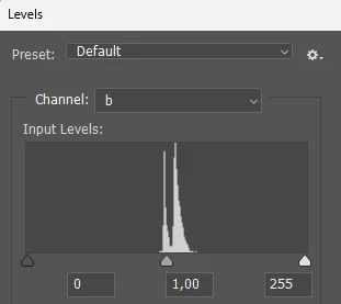

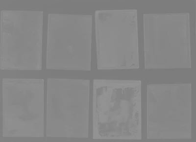

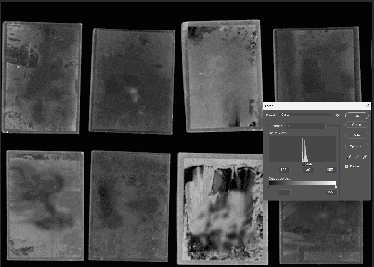

First of all, we draw attention to the fact that there is dirt on the white background, it will interfere with us, so we convert the image into a smart object (so as not to lose details during further processing) and reduce the entire image to the width indicated in the RESIZE_TO = 400 constant.
We can see that the photos are slightly yellow, and the background is white-blue. Convert the image to LAB and take a yellow-blue channel from there, where the contours of the photos are clearly visible against the background:
We want to make them more discernible, but the threshold filter here is useless as the image has a low contrast and at random to find the desired value of the threshold is very difficult, so we call the filter of the levels and look at the histogram:

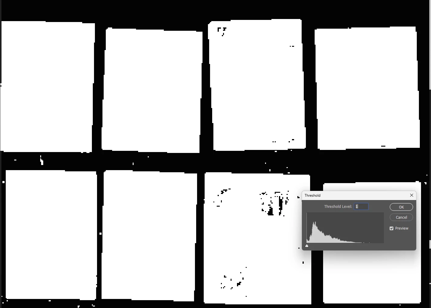

We're seeing two peaks. The right peak is the background, the left is the photos. We get a histogram of whole image, find a peak on the left and its boundaries:
Now we have (practically) a full contrast image and we can use the threshold filter:
Further, everything is quite simple - create a selection based on the RGB channel, convert it in path with PATH_TOLERANCE = 6, return the original size to the image and process each closed path separately. We get a number of closed paths inside the photos, so we simply ignore the selected areas bounding box of which is less than 5% of the area of the entire image (OBJECT_THRESHOLD = 5)
Next, we act as well as with a film – having a frame divide it with several lines with a width of 1 pixel to find the points of intersection of the background and the boundaries of the photo, as well as determine the angle of inclination. The only change is that due to the very weak contrast, I decided not to use the threshold filter, but used the color difference formula (i.e., took the background color at the reference point and then moved along the photo until the dE reached the specified threshold COLOR_DIFFERENCE = 20
In this case, there are even more potential problems than in the case of a film, so I’m not sure if it works at least one more image. Perhaps someone will offer a more elegant solution.

    doc.selectChannel('b');
    doc.makeSelection(0, 0, docW, docH);
    doc.copyPixes();
    doc.convertMode('RGBColorMode');
    doc.pastePixels();
    var levelsThreshold = findMinMax(ch.getProperty('histogram'));
    doc.levels(levelsThreshold[0], levelsThreshold[1]);
    doc.threshold(1);
    doc.makeSelectionFromChannel('RGB');
