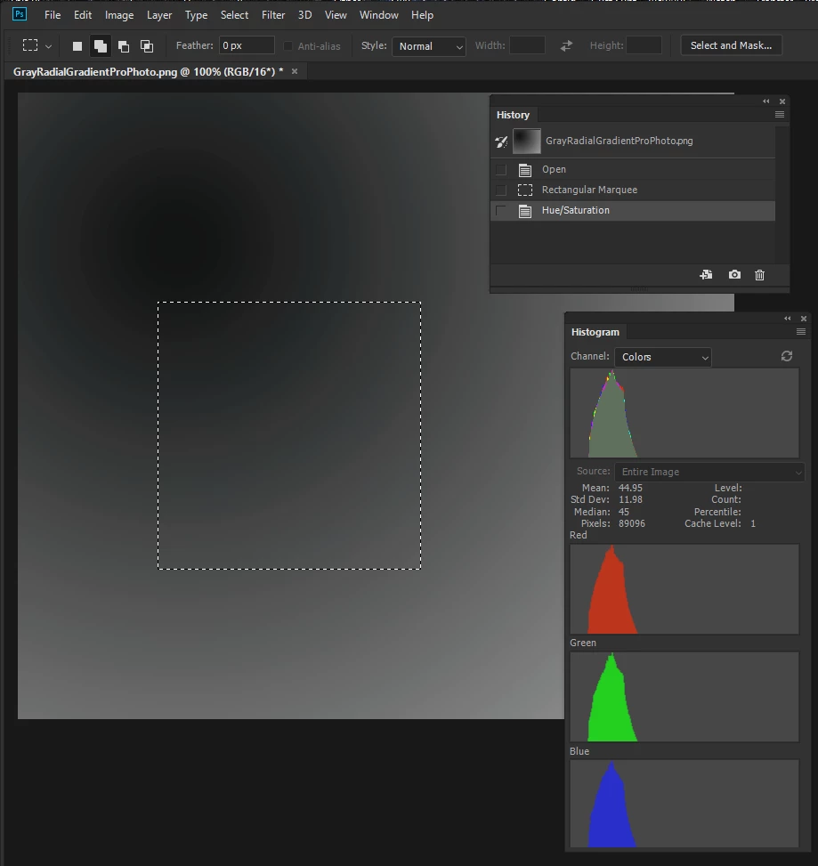

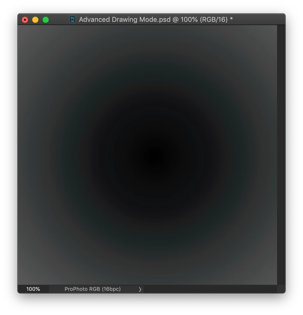

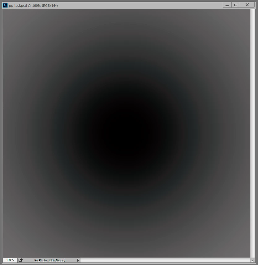

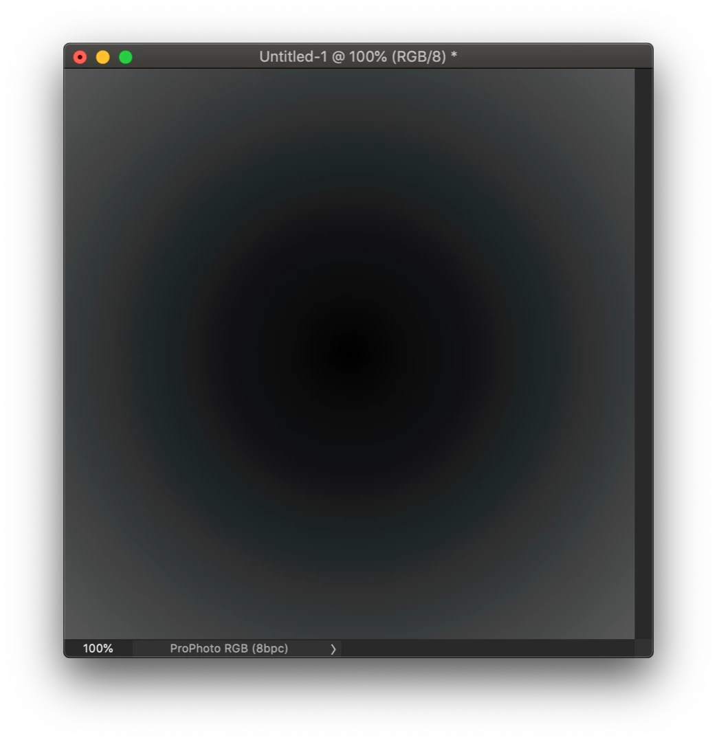

Since Noel is back with us, I thought this header might catch his attention. He was the one who first reported it six or seven years ago.
The reason I'm bringing this up now, is that someone in the Lightroom forum had this problem just yesterday (he was sending ProPhoto files to Photoshop and couldn't understand the cyan cast in his dark grays). There's no doubt it's the same issue.

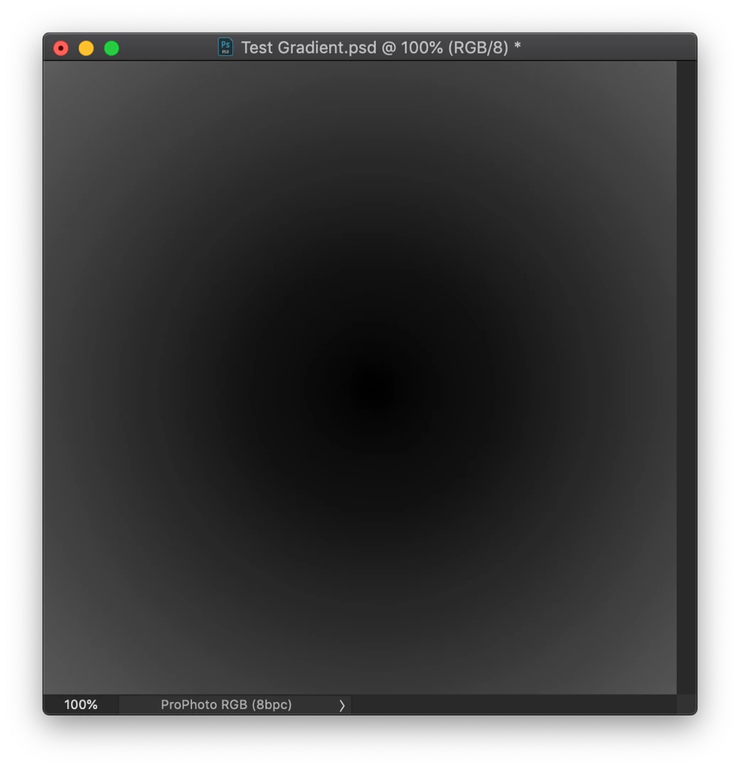

This made me dig up my old ProPhoto test gradient file. I don't use ProPhoto all that much, so I haven't really looked for it in a while. To recap, this is an example of what it could look like (this is an old screenshot that I've kept). Open and view against a darkish background:
But when I opened the test gradient now, there was no trace of it, zero. The gradient is smooth as silk. That surprised me, because while the effect can vary, it always seemed to be there in some form.
Technically, this is an inaccuracy in the conversion from ProPhoto into the monitor profile. This conversion is performed by OpenGL in the GPU when you have the PS preference set to Normal and Advanced modes. In Basic mode it's shifted back to the CPU, which is more accurate so the problem disappears. And you only see it in ProPhoto files because ProPhoto is very compressed in the shadow values compared to other color spaces. The stratospheric gamut has a price, and that's it. With this compression, inaccuracies get amplified.
So what has changed on my system over the last 12 to 24 months? Not much. I still use Eizo Colornavigator as I did then, still producing similar matrix monitor profiles. But one thing has changed - going from GeForce to Quadro, and with that, 10 bits per ch output.
So Noel, if you're reading this - I understand you have Quadro GPU too, and running displays at 10 bit. Do you still see it?
Anyone else?

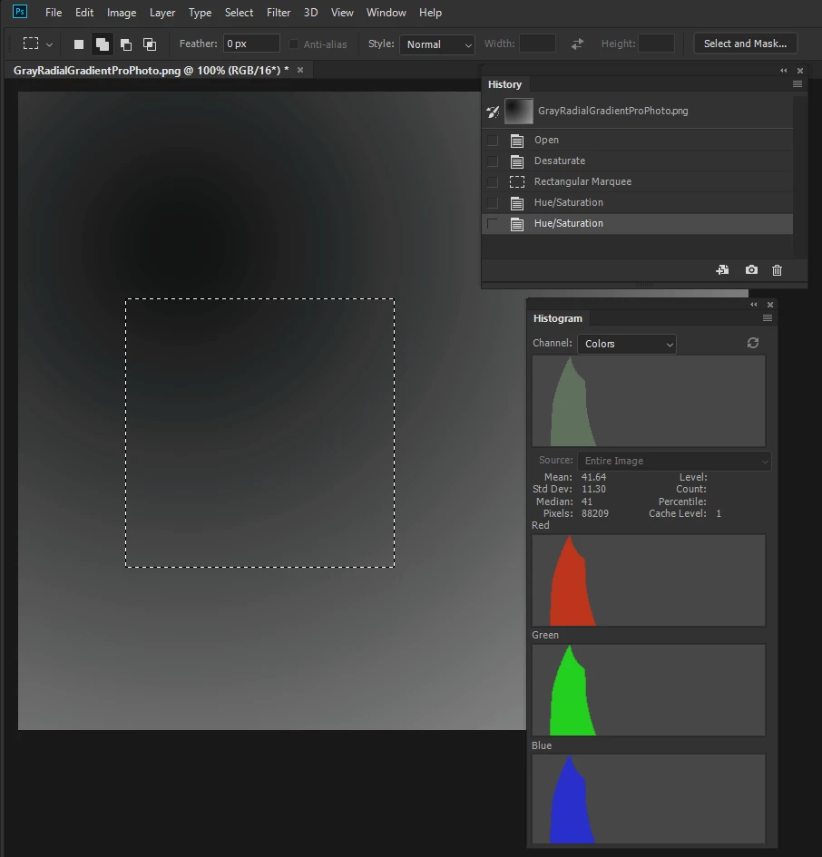

    2019 Feb, the problem still exists, the same banding when doing "Edit in Photo" from Lightroom, but in Lightroom, there is no banding. Since Lightroom recommends to use ProPhoto to Handle File when export to an external app, why it's not working in Photoshop when the GPU takes over, I don't want to set it to Basic.
    Using Win 10 and Geforce 1080ti

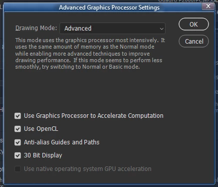

    Hey Dag, I had an idea that's a bit out there...  Here's my sniffer-out.txt file.  Does it differ from yours in any important ways?

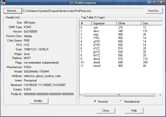

    By the way, I did a little more research on the ProPhoto RGB profile.  According to this page, there's actually a linear section of the tone curves very close to black:
    ProPhoto RGB color space - Wikipedia
    The cutoff for the linear section is 1/512, or 0.001953125.  The designers clearly envisioned it being used with high bit depth data.
    No particular reason for mentioning this, though it's food for thought...  If a particular color-management implementation forgets to account for that section (or approximates it) it would introduce inaccuracies near black...
    -Noel

    Noel Carboni
    October 24, 2018
    Hm, that might imply your gradient isn't pure gray, Dag, BUT...  There is definitely some additional weirdness going on!
    I tried raising the saturation of my grayscale PNG to +100 and got this:
    Then I did it AGAIN and got this cute little result.
    After undoing all the above, I did Image > Adjust > Desaturate it, then two iterations of +100 saturations and got this:
    This implies the PNG actually has some values that are non-gray (by a tiny bit).  And here I thought PNG compression was lossless - but I guess not!  The funny thing is that this little revelation seems to be entirely separate from the ProPhoto cyan cast display bug.
    The plot thickens!  I'm going to save my test image as a PSD and use that from now on.  I hope THAT's lossless.
    -Noel
    rob day
    October 24, 2018
    This is OSX High Sierra with CC2018. I'm not seeing any objectionable banding or color shifts
    Noel Carboni
    October 24, 2018
    It's great to see that it CAN work.  Now to figure out what's common among the systems on which it IS working, and that's proving non-trivial.

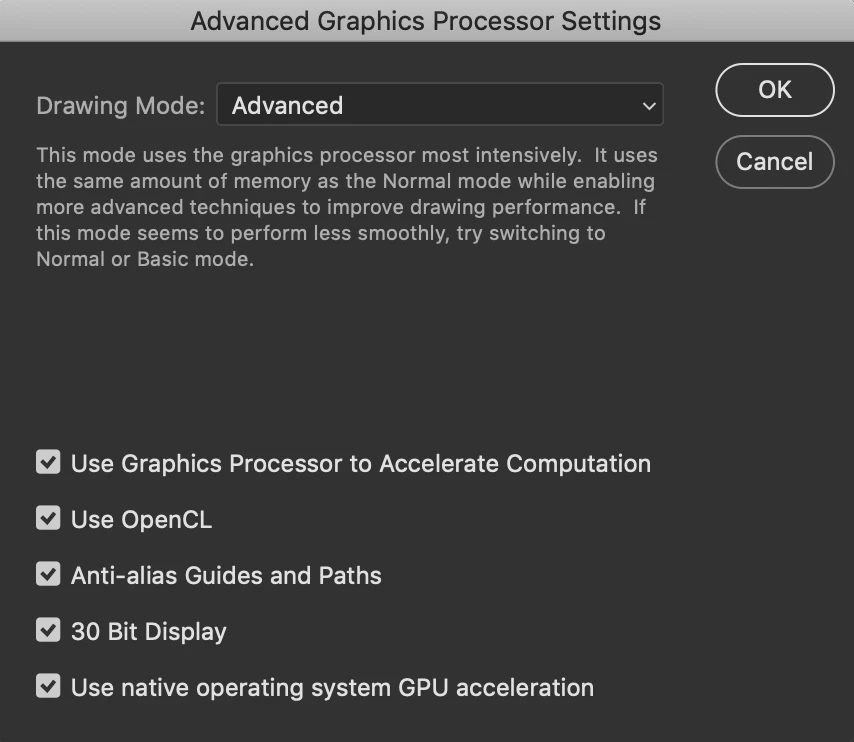

    Rob, some questions, just to be thorough:
    1.  Do you have your Use Graphics Processor setting checked, and are you using either Normal or Advanced graphics mode?
    2.  Did you try two iterations of Saturation +100 on that .png I posted?
    -Noel
    Noel Carboni
    October 23, 2018
    By the way, do you have the Use native operating system GPU acceleration setting available and checked in the Advanced Graphics Processor Settings panel.  It's grayed out for me; I imagine it's only available for the very latest OS versions.
    -Noel
    October 23, 2018
    Yup, uses Metal in macOS (Mojave here)

    D Fosse
    D FosseCommunity ExpertAuthor
    October 23, 2018
    Yep, there it is. That's exactly how it looks.
    (although, to eliminate all variables, you should do it with 16-bit files - but I doubt it will make much difference here. The crucial bit depth limitation isn't in the file, but the display system).

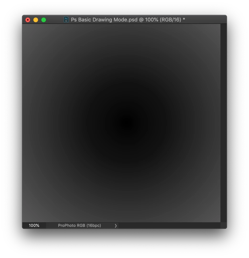

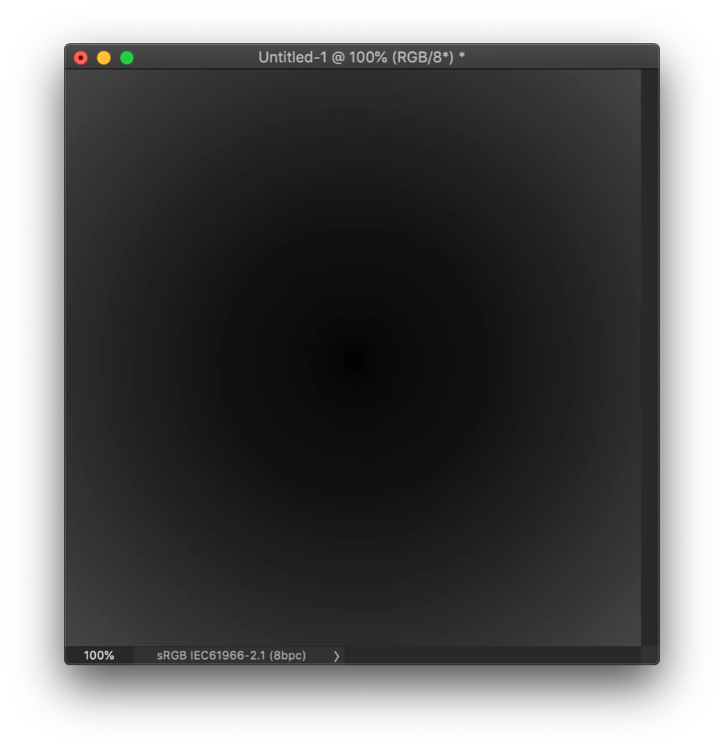

    October 23, 2018
    So this is the same issue as when I export from Lr to Ps via Edit In?
    I'll try one in Basic mode and update the previous post.
    Update, I can't seem to edit the previous post so here's with Photoshop in Basic drawing Mode
    And here are the 16bit files. I always work in 16bit but since yours wasn't I wanted to test with the same settings.
