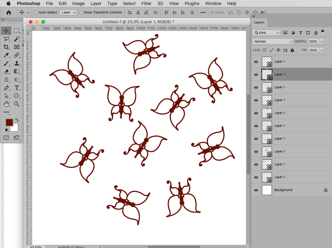

A while ago I looked into »borrowing« a Tool to randomly apply Smart Object instances to clicked points:
https://community.adobe.com/t5/photoshop-ecosystem-discussions/full-colour-brush-dabbing-simulation-script/m-p/9397073

I'd like to create a brush from the full colour butterfly, which I can resize each time I use it.
You could use the Clone Source Panel to scale and rotate the material you picked up with the Clone Stamp Tool.
Have you looked into achieving the task with with Smart Object instances?

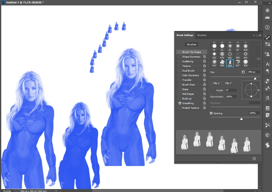

JJMack
November 23, 2021
Not full color but  simple tips do support opacity.
