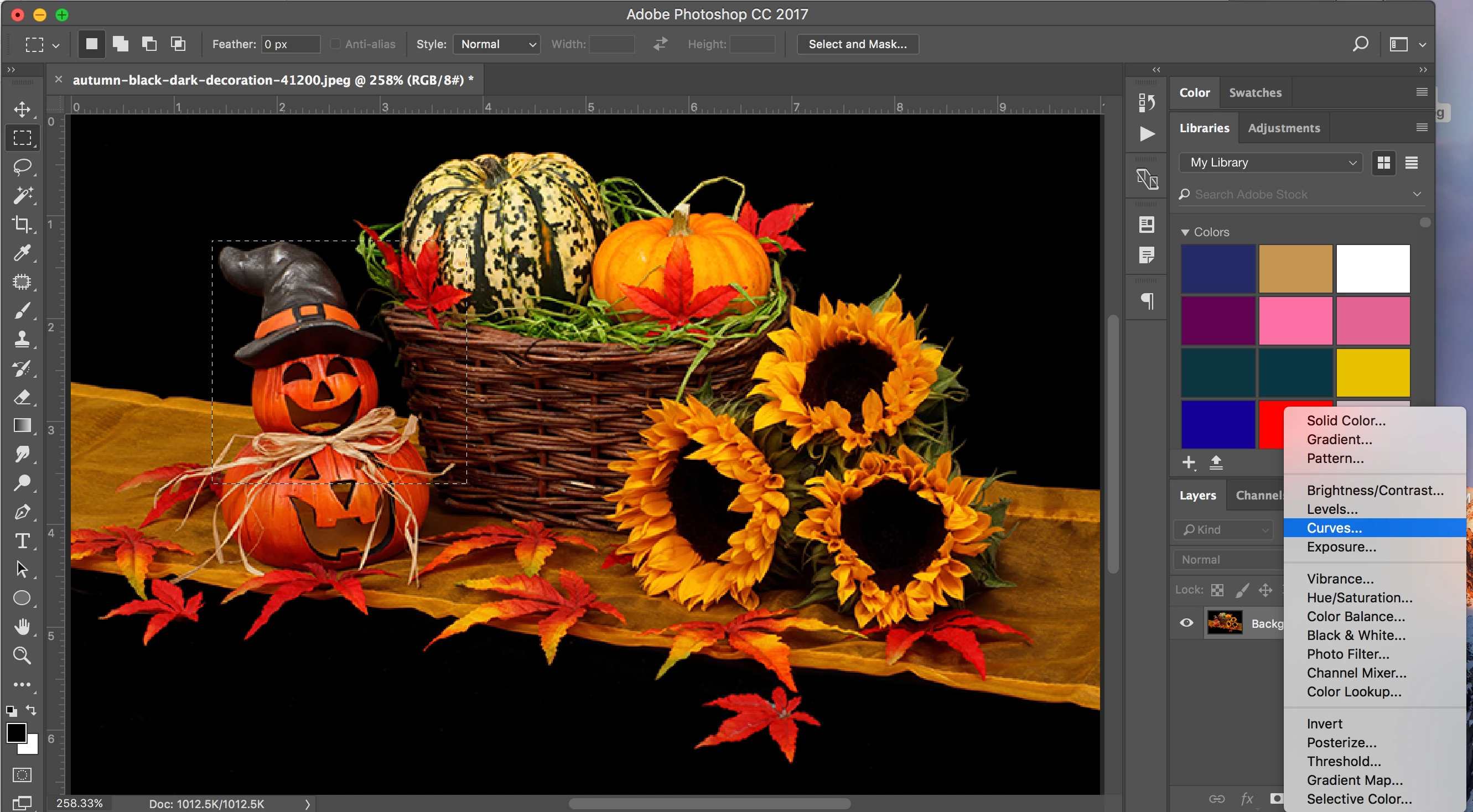

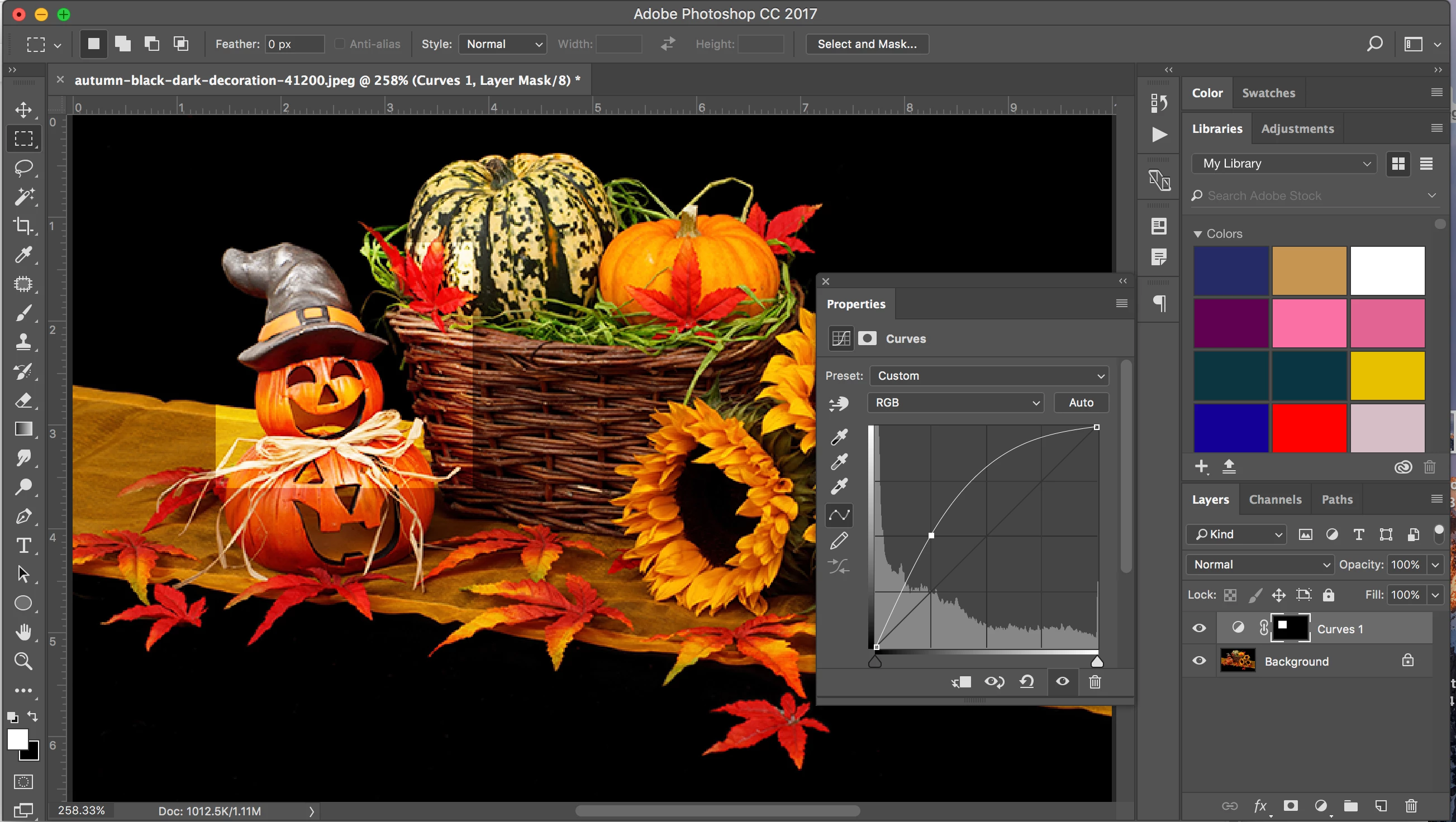

    You should be able to make a selection of the area with any selection tool. Here I just made a rectangular selection over part of the image and go to the curves adjustment.
    Then you make your adjustment and it creates the adjustment layer with a mask over the part of the image you don't want affected.
    You would use the same process for the brightness/contrast adjustment layer, but I am not sure what you mean by the hand tool.
