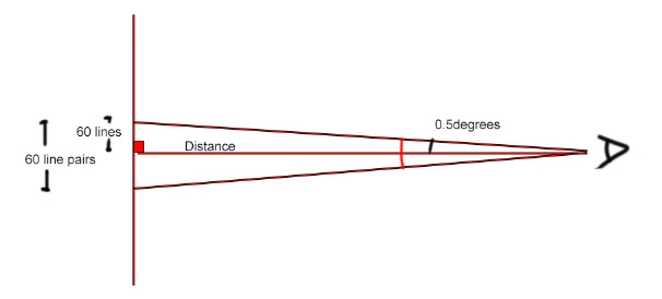

It works for all occasions Bob as long as you enter the minimum intended viewing distance. If that will be less than 2 feet then by all means go for 300ppi.
The maths is based on this  :
A good human eye can resolve 60 line pairs per degree i.e. pairs of black and white lines.  So in half a degree we would have 60 single lines.
Simple trigonometry means that the width containing those 60 lines can be calculated by:
               Width of 60 lines = Viewing distance x tan(0.5°)
Once we know the width for 60 lines (or pixels) we can calculate how many lines per inch can be seen by using 60/Width of 60 lines.
So putting those together gives us
60/(Viewing distance x tan(0.5°)) = 60/(Viewing distance x 0.0087269)  = 6878/Viewing distance
Dave
davescm
December 18, 2019
How close will the images be viewed? 300 ppi is for images seen at close distance e.g holding a book. As we step away our eyes can make out less and less detail.
A simple formula for ppi is :
ppi required  = 6878/Viewing distance in inches
Anything above that is wasted as our eyes just can't resolve it.
Dave
