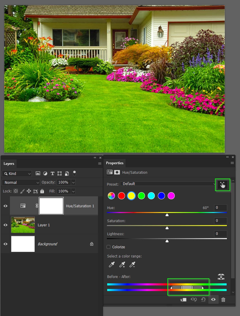

    A Hue/Saturation adjustment layer would work.
    Click on the little hand icon, and then click on the new grass.
    This will select a colour range that you can see via the sliders on the colour bars at the bottom of the properties panel.  You can drag those sliders to expand or contract the colour range.
    Then use the Hue, saturation and lightness to adjust.
    You will still need to mask out other areas of green/yellow with the layer mask.

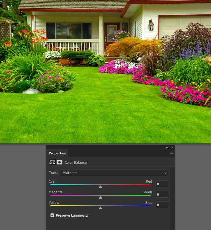

    I quite like Color Balance as a quick fix.  If it’s too red, nudge towards the cyan. If too yellow, nudge towards the blue.  What might be a problem is that it is subjective and relies on the user’s opinion.  OK for someone like me that doesn’t care too much about perfect colour, but for someone in your position Dag, it has to be spot on.  I was thinking much the same thing in the thread about fixing a historically important art piece. It’s more specialised for most of the regular posters here to give reliable advice.  I almost tagged you, and would have done if I thought you’d missed the thread.
