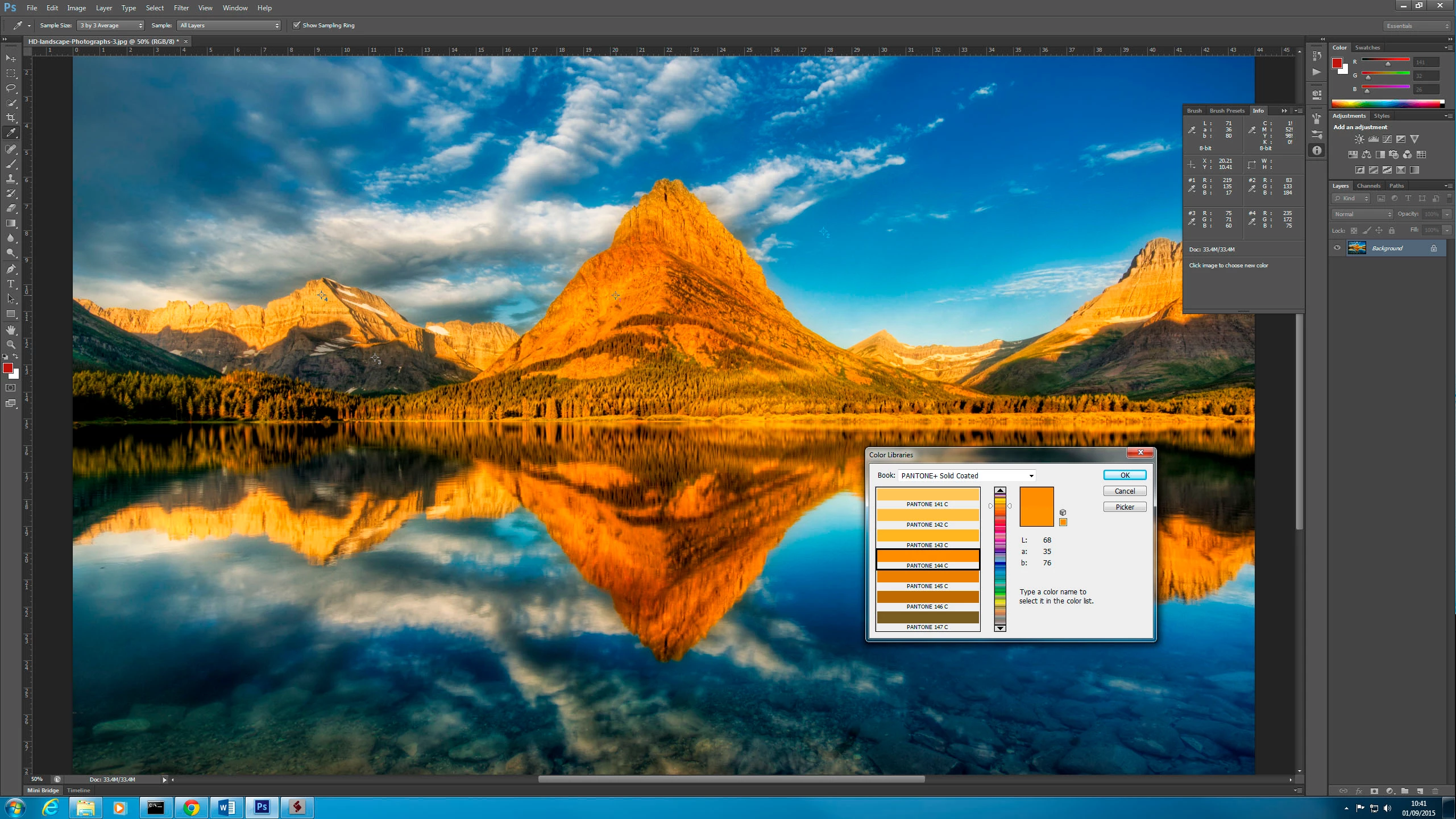

This is my demo picture.
I open Photoshop and I convert the workplace to CMYK. I need to get the color code of a series of pixels (that i whant to select with the eyedropper tool).
Then I want to obtain the position of the pixel (XY) with the CMYK, RGB and LAB values for every pixel that i select and save theses values in a .txt document or excel.
If is it possible, i would like to obtain at the same time the Pantone but if is not possible, i can save the color like a new swatches and then, export the swatches fil and cross the to files to obtain the complete reference of color/pixel.
