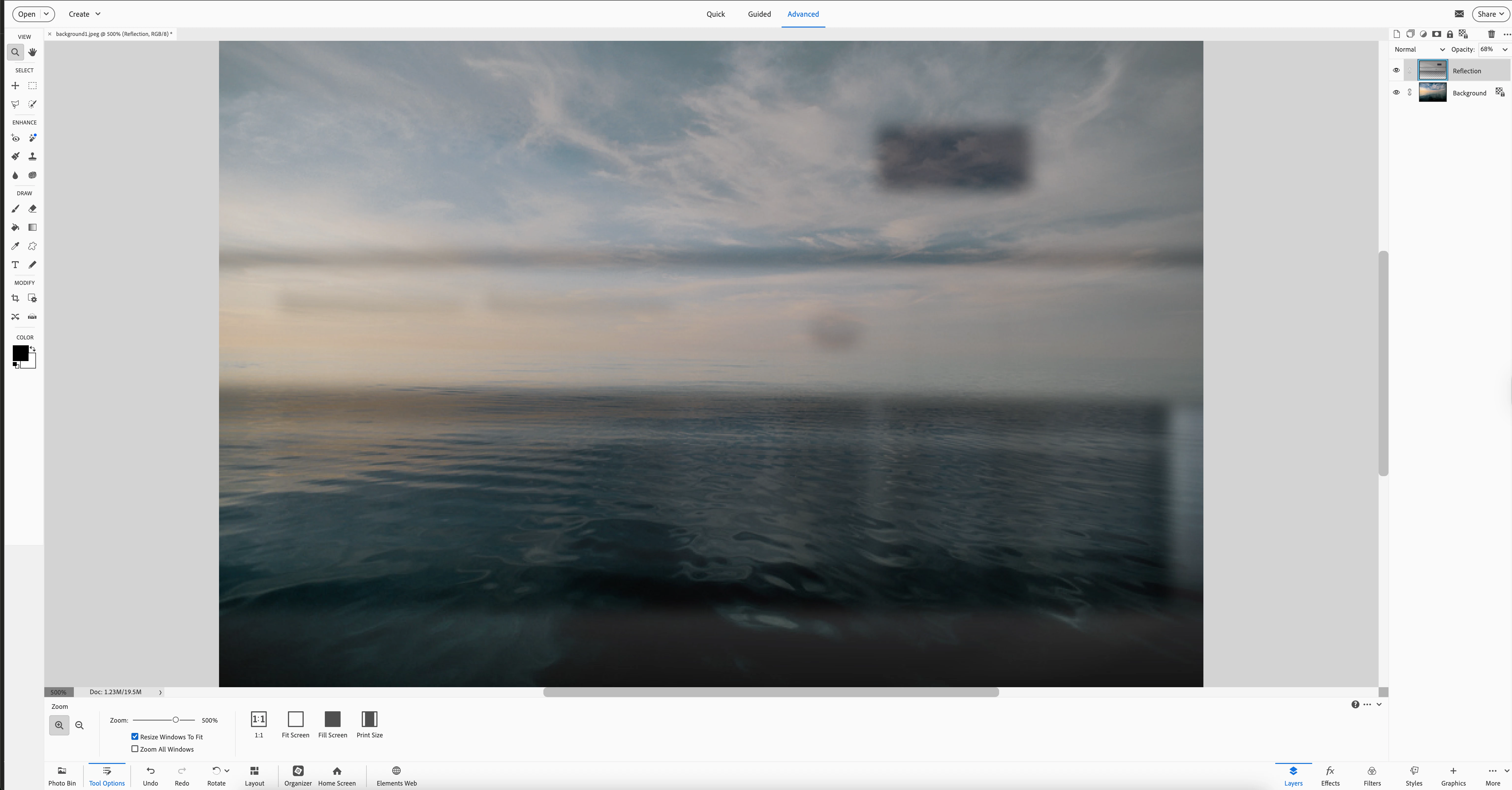

Jul 16, 2025 4:23 AM UTC
@Jeff Arola, as I understand it, the OP's issue is not so much with changing the color in the picker, but in changing the object color when the object is on a different layer than the top layer.
@Seaweed1, have I correctly expressed your issue?  Thank you for providing the screenshot.  Can you explain in more detail what you are trying to do with the Change Object Color tool.  As best I can tell, you have a seascape photo and have created a second layer trying to create a reflection - of what, I am not sure.
What object is it that you want to change the color of?
And are you intending to use a blend mode to affect the ultimate result?
Perhaps there is another way to get the result that you want to achieve.
Seaweed1Author
Jul 16, 2025 5:48 PM UTC
@Jeff Arola, you are correct, that one can change the setting for the Eyedropper Tool before clicking on the Change color. However, that does not change the behavior of the Change color function; it still affects all layers.
@Greg_S. The seascape photo is simply an example; the actual file and image I'm working on are proprietary. To describe what I am trying to do is to change the hue and color of a selected part of an image layer.
I see that the Change Color function applies an Adjustment Layer, which affects all Layers.
Is there another (better) way to do this adjustment?

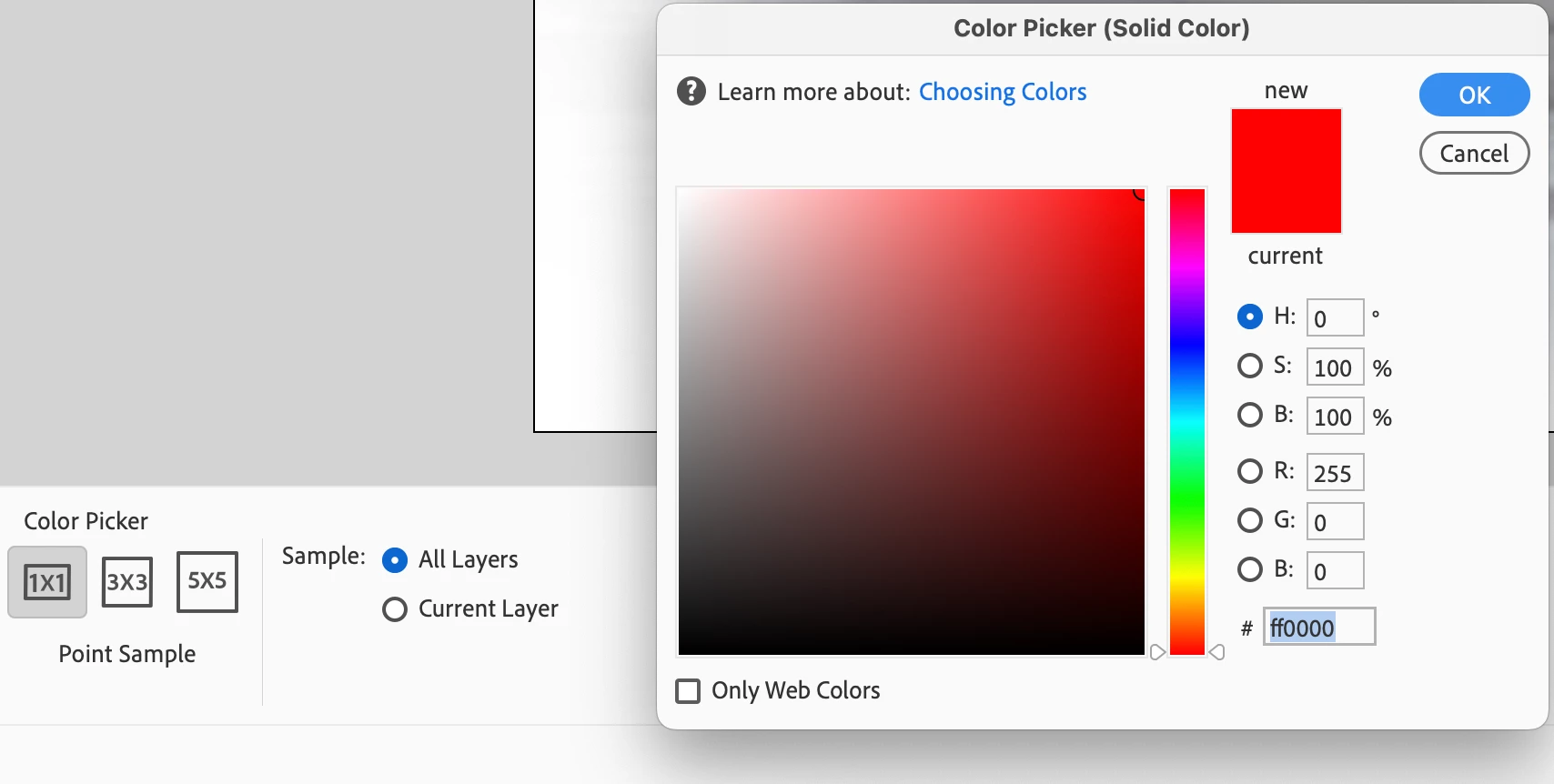

Seaweed1Author
Jul 11, 2025 4:35 PM UTC
As I mentioned previously, once the Color Picker is selected, one cannot change the Sample to Current Layer.

Greg_S.
Jul 10, 2025 7:28 PM UTC
I will investigate whether that is a bug when I have some more time later.  But as shown in your screenshot, there is an option in the Color Picker to Sample Current Layer.  Does that work for you?  If not, please post a screenshot of your Elements window with the layers panel displayed.

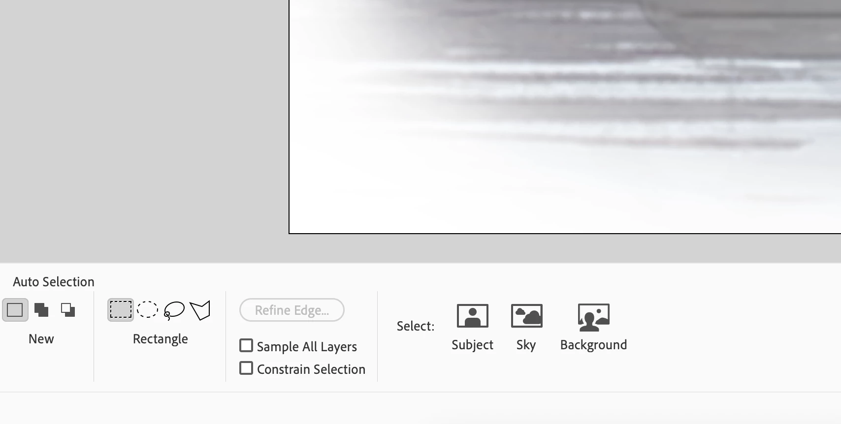

Greg_S.
Jul 10, 2025 7:05 PM UTC
When you make the selection uncheck the option to Sample All Layers.

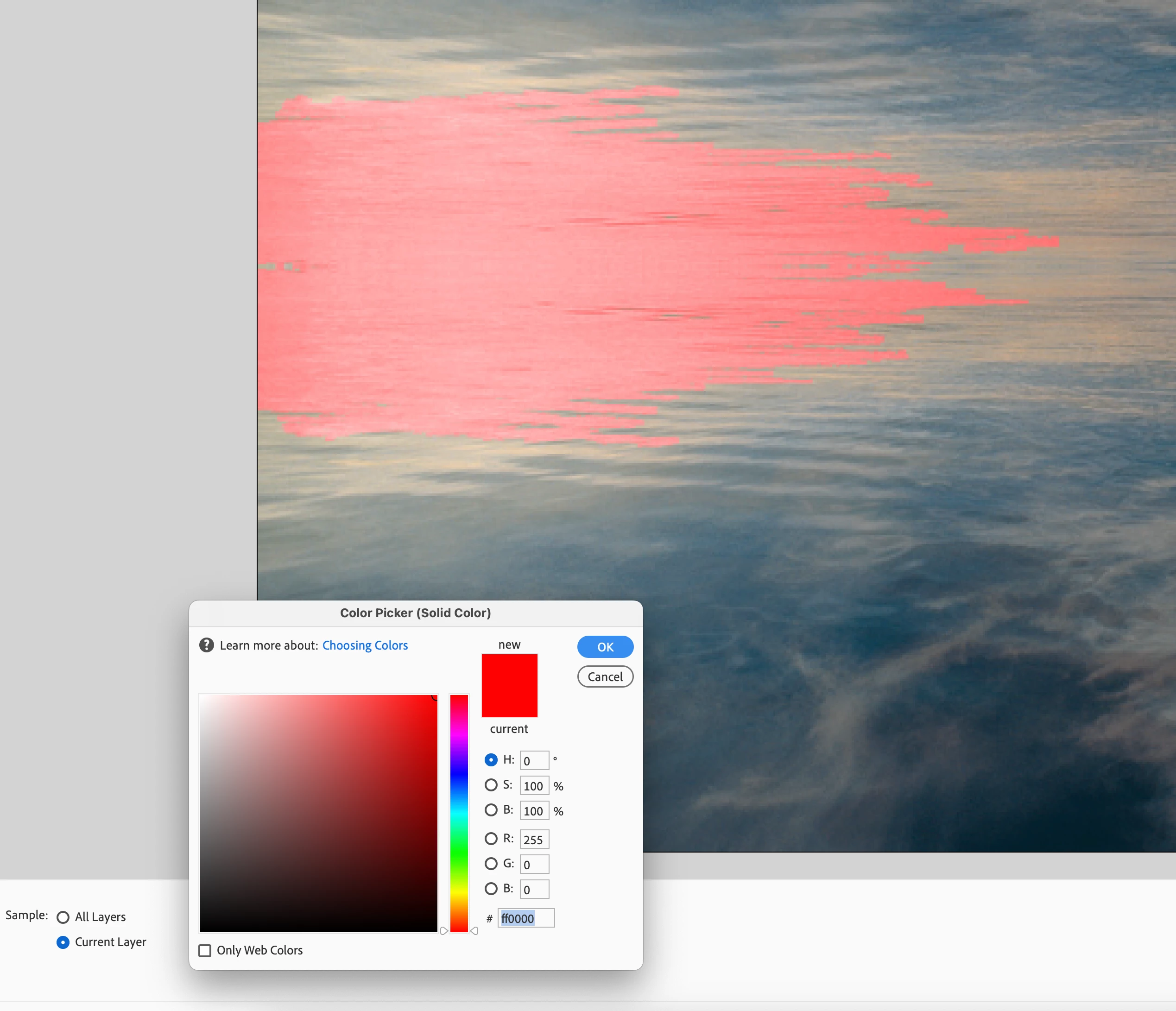

Seaweed1Author
Jul 10, 2025 7:15 PM UTC
Yes, the Sample All Layers is unchecked before the selection, but then switches to checked after the selection.
Perhaps a bug?
