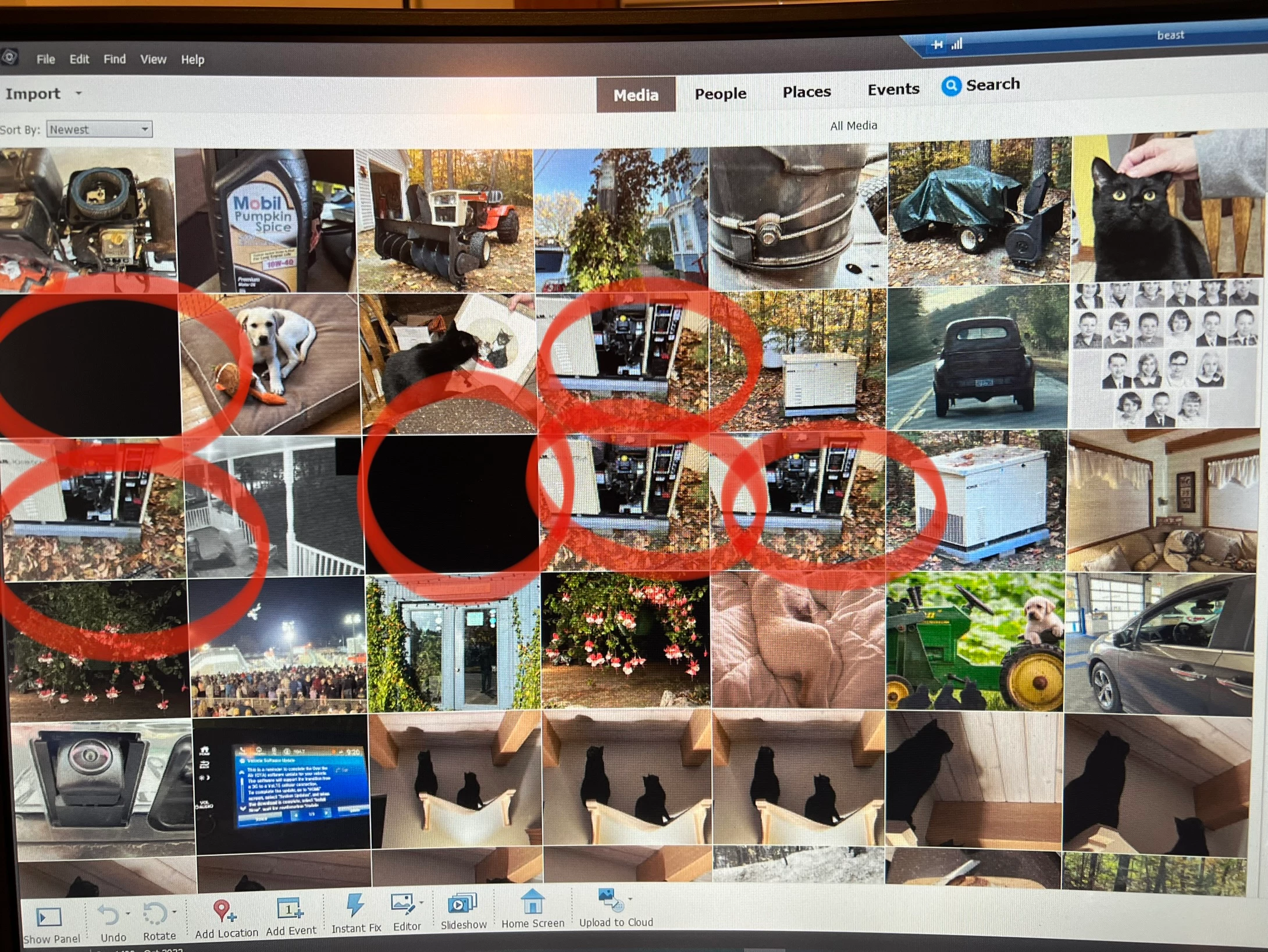

Organizer 2023: thumbnails sometimes show up correctly but change even with no user actions occurring.  Sometimes they change to black (no thumbnail?)  sometimes the thumbnail for one HEIC image will be propogated to multiple other HEIC images.  Different things seem to happen randomly each time.  If you scroll down to other images in organizer, then back up to the HEIC files it happens all over again (with different results each time).

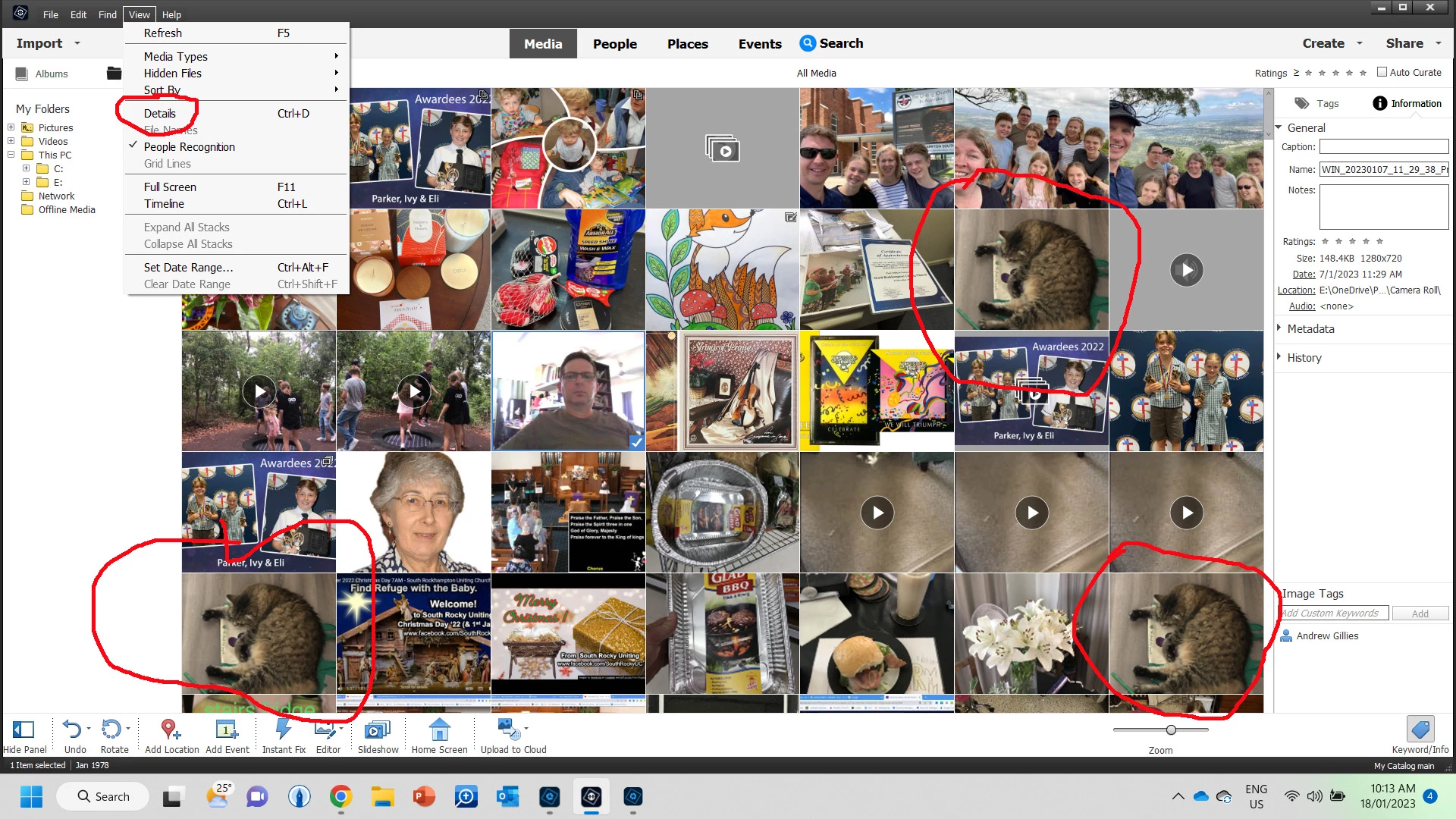

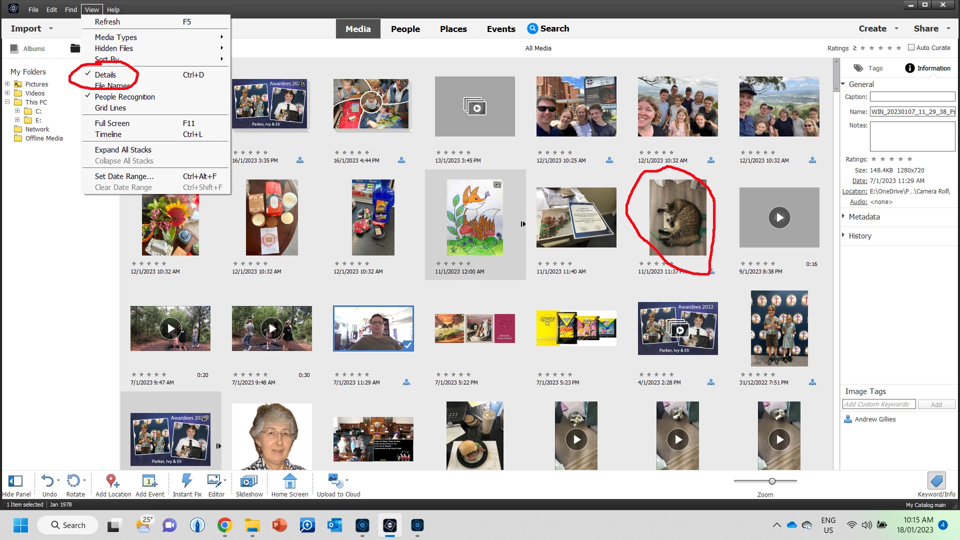

Jan 18, 2023 12:41 AM UTC
Hi again everybody. I may have a very easy partial solution. I have found that the weird behaviour of thumbnails only happens when datails is not ticked in the view menu. The thumbnails appear to be correct in the details view and stable. this makes the program workable. The weird behaviour still should not happen when not in details view and it is VERY annoying but if I am right "Hallelujah!!!" Photos in this post details view not selected and selected. In "not selected" three completely different photos that have the same thumnail due to the glitch. In "selected" the original photo circled with the correct thumbnail.

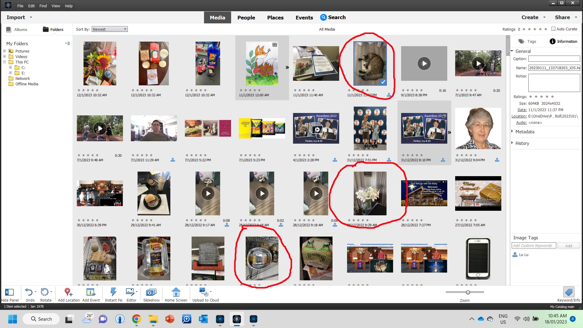

Jan 18, 2023 12:48 AM UTC
Here is the details view with all three correct thumbnails selected.
