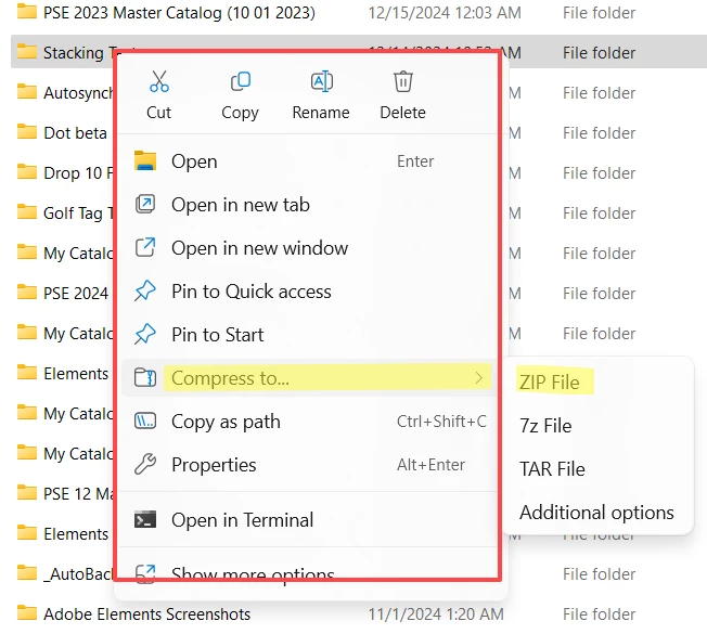

1. Before I did any restore processes, I zipped and then copied my catalog file from my internal C drive to a hard drive, unzipped it, and had it available in case anything went wrong. Thankfully the restores went well and I didn't need to use it. My question is, should I keep this catalog file on my external drive (Elements is still backing up to the original location on my 'C')?  Where is the recommeneded location to keep the cataloge file?

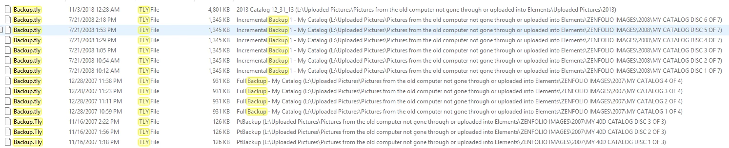

2. I restored a half a dozen TLY Files and I believe I saved one of the TLY Files incorrectly because now when I open my drive I have thousands of Bxxx.XMP files which have to populate before I can access any folders. My question is, can I move these .XMP files, can I delete them, do I need to delete the Restore Backup and do it again? (I have provided a couple of screenshots of what my folder tree looks like)

4. I've found multiple .tyl files on my computer. I didn't name these well (some I did; others not). I'd like to see if I have photos I've lost from the hard drive fail years ago in any of these .tyl BackUps. Can I do a RESTORE of all these .tyl files? Do they have to be done in a certain order (I have 14 dating back to 2008)?
Yes, you can restore every backup you have made to see whether it contains the lost photos.  But, make sure that you are not overwriting any files.  I think I would start at the latest and work my way backwards.  If you always had your photos in a single catalog, any missing photos will be in the backup you created just before the hard drive crash.

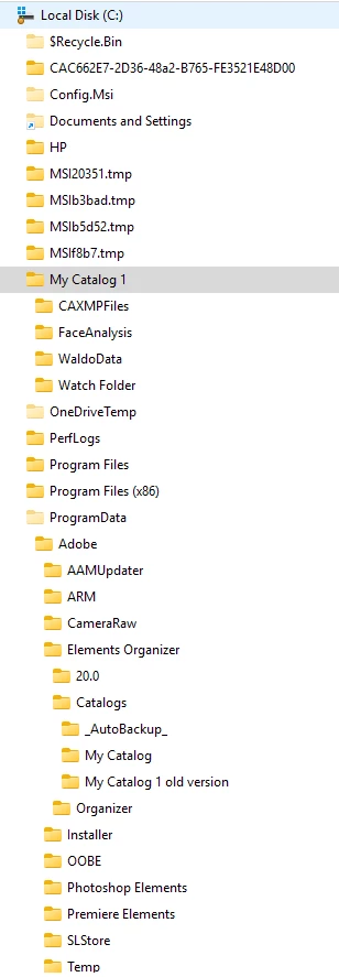

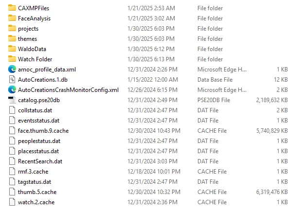

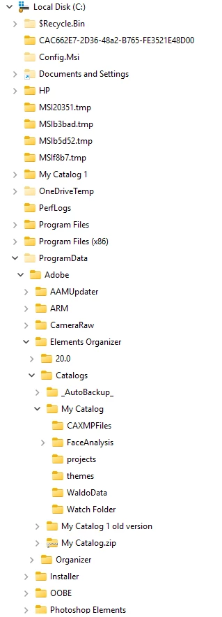

1. I agree on the extraordinary amount of time it took! I did NOT copy any of my photos; only the My Catalog folder. Could it be because the zipped folder was being extracted from my external HDD/NAS which I have on another level of my home? Below I have explained better the drive letters I use.
I went to the PSE2022 default location for My Catalog on my internal HDD/C drive and zipped that folder, copied the zipped folder to my external HDD/L drive (I have two external HDD on my NAS that have been set up as redundant drives - I treat the 2 drives as just one External HDD although one is named L and the other M).  Below is a hierarachy of my internal HDD/C drive. It still appears this way. I have not deleted anything.
Below is what is inside the unzipped folder I copied over from my internal drive/C drive to my external HDD/NAS

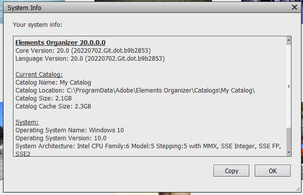

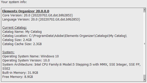

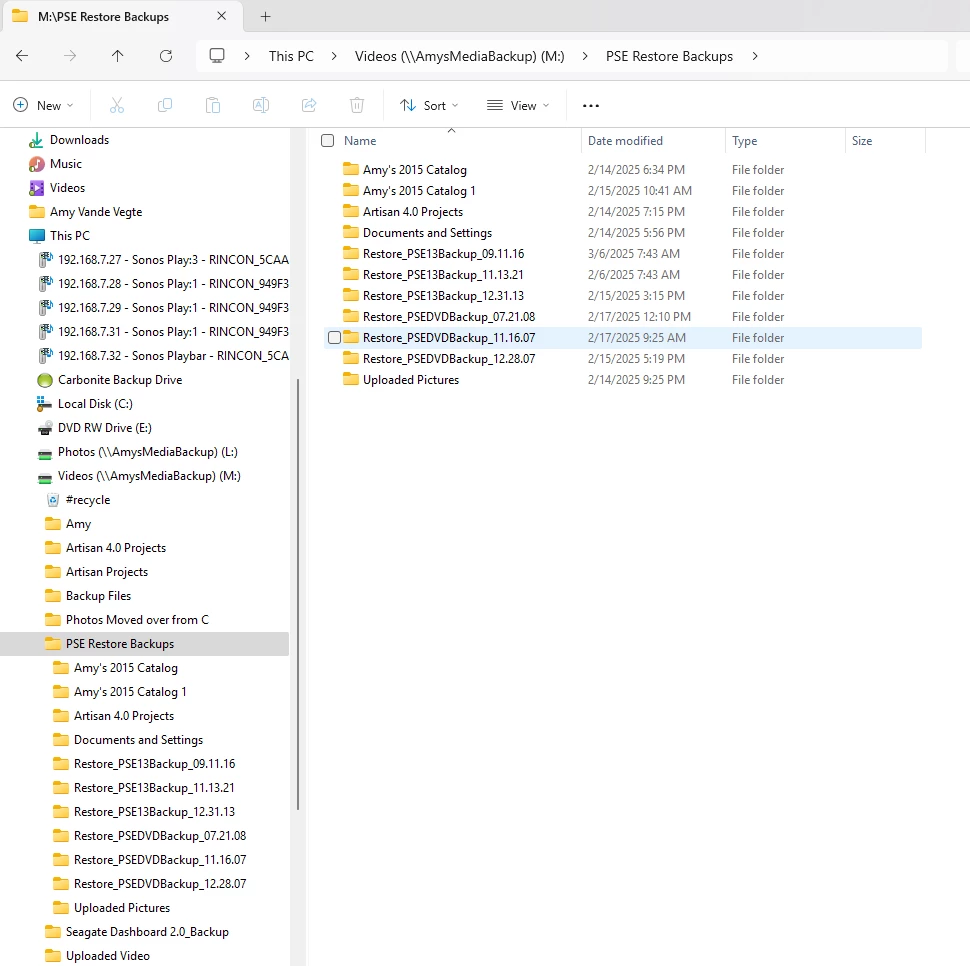

I'm also including a screenshot of my PSE2022 System Information, the old .tyl files and .buc files I've fund on my external L drive in case that helps. I do not have as many .buc files as .tyl files, and I'm guessing that will also be an issue with retriving these lost images?

Once the 'My Catalog Zip' is created, I will copy that file to my external drive (use NAS for this).
I probably failed to mention, that you will also need to Unzip the file once it is copied to your external drive.  I believe you can double-click on it and Windows will ask you whether that is what you want to do.
Once that file is copied over, I will delete the 'My Catalog Zip' created on my hard drive.
You will also be able to delete the copied file once it is unzipped on your external drive.

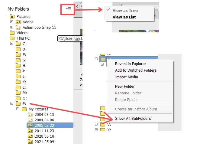

Will I somehow do this import via the “Tree View” and if I have blank folders that contain photos that should be in the catalog, I will right-click on them and select Import Media to import any files that are not already in the catalog?
This would be one way to do it.  But you can only import one folder at a time this way.   The other way would be to Import>From Files and Folders and select all of the folders that you want to import, using Shift+ or Ctrl+ Click to select the folders.  Then click the Get Media button in the dialog.

OK.  So, your old catalog is in the default location and your current catalog is on the root of the C drive which is fine.  Here are my answers to your other questions:

One thing I want to mention since I'll be backing things up differently is that I am not entirely sure if I have all of my photos on my external drive. Some may be on my computer's hard drive. I've always wondered if there is a way to check the photo locations of my files (other than looking at each one individually)?
One way would be to look in the My Folders panel.
  •  Make sure you are in Tree View, not List View - click on the hamburger icon next to the My Folders panel heading and check View as Tree.
  • Right click on each drive or main photos folder where the photos are stored, and choose Show All Sub Folders.
  • If a folder contains photos, it will have a pictures icon displayed rather than a plain yellow folder.  (In my screenshot below, the pictures icon has a couple of faded icons which means that the folder contains only missing files.)
If you have blank folders that contain photos that should be in the catalog, you can right-click on them and select Import Media.  This will import any files that are not already in the catalog.

Ok, this is what I've done: In 'My Catalog' I've reconnected all missing files (there were none). I've repaired and optimized 'My Catalog' (no problems but repaired anyway). I've backed up my program and closed it. I checked my hard drive for enough free space (we're good here) and then went through Windows File Explorer on my hard drive to the Catalogs folder default location (confirmed through Help>System Info) and right clicked on 'My Catalog' folder and told it to create a Zip folder under the "Compress to" option. Once the 'My Catalog Zip' is created, I will copy that file to my external drive (use NAS for this).
Once that file is copied over, I will delete the 'My Catalog Zip' created on my hard drive. I'll then reopen PSE and use my current 2022 version of Elements to perform the restoration of the catalog, working through the prompts of Restoring ‘My Catalog’ to a New Computer via the burned DVDs I found (and in the order they were burned). This procedure found in this HelpX article you provided. I’ll use the third option listed (restore to new location with original folder structure). These DVDs (backed up on a prior version of Elements) will be converted to the current version of Elements. I’m planning to put this on my external drive (NAS). I have all my photos on my NAS and since they’ll be coming off my DVDs, they will be restored to a different location than what they were originally stored on.
When I open Elements 2022, ‘My Catalog’ will open by default and will have all my current files visible and available to me. I will not need to create a new catalog for the restoration of my backup before beginning the Restoring (I hope I have that right that I can work right inside of ‘My Catalog’ for this step), and nothing will be overwritten if I select a new location for the restored catalog (planning on restoring to external NAS). The restored catalog is an entirely separate catalog from my current catalog (‘My Catalog’). The restoration aids my getting back the lost photos. The DVDs will be stored in the new location on the external NAS and can be imported into my latest catalog (‘My Catalog’).
The backup will restore a copy of my old catalog in its condition at the time it was backed up. Once the photos are restored (and I should not have any duplicates imported), I will bulk import them into my existing ‘My Catalog’ (I have a backup of my current ‘My Catalog’ if something goes astray). I still question this part as I don’t fully understand how I will bulk import a catalog that is restoring to the catalog I want to bulk import into. Once I restore the backup, I should be able to identify which folders contain the missing files (I organize by date) and will be able to import these missing photos into my current catalog ‘My Catalog’. Will I somehow do this import via the “Tree View” and if I have blank folders that contain photos that should be in the catalog, I will right-click on them and select Import Media to import any files that are not already in the catalog?
After all of this has been completed and I move the imported files under the date structure I have, I believe I will want to do another backup through Elements to my Program Data’s default location (which, if I understand correctly happens automatically as I close my Elements program and select the backup prompt). If this is all correct and once I’m finished, are there any files I’ve created that can be deleted? Should I be able to delete the new “restored to” location for the backup I created during this process?
Please correct ANY mis-steps I have outlined above. I do not plan to move forward until I’m certain of what I’m about to do. Honestly, makes me very nervous.

Your last screenshot truncates the full path of the two catalog folders.  Can you show a screenshot of the folders in Windows Explorer.  It's possible that the old catalog is within the new catalog's folder.  If that is the case, you should probably clean that up before proceeding further, although it may not be a big deal.  If one folder is within the other, please show screenshots of the contents of each folder.
Before making a backup of your catalog, open the Organizer and select Find>All Missing Files to determine whether any catalog files are missing.  If there are any, you must either reconnect them or delete them from the catalog.  Otherwise, the backup will almost certainly fail as it did with your  first attempt.  I als recommend that you Repair and Optimize the catalog in the File>Manage Catalogs dialog.  Proceed with these operations even if you get a message that no errors were found.
Your current catalog is very large.  It's one of the largest I have ever heard of (and mine is close in number of media files).   So any copy operation is going to take a long time.  But that is why I suggested zipping the folders before copying them to another drive.  Since the zipped copy will be added to the current drive, you have to have enough room on the drive, particularly if it is the system C drive, with at least another 10% of free drive space to spare.
I assume your computer is Windows 11.  If it is, there is an easy way to zip the catalog folder.  In Windows FIle Explorer, right click on the folder and choose Compress to. . . .  from the context menu.  A sub-menu will open and you should choose ZIP.  A new file will be created which you can rename if youi want to, but that is not necessary.  Just make a note of the proposed name so you can find it again.  If you don't see the Compress to option shown in my screenshot below, then select the Send To option from the context menu and choose Compressed (zipped) File.  (I have other zipping software installed so I'm not sure what the Windows options are.)

amyvegte
amyvegteAuthor
Dec 31, 2024 2:42 PM UTC
Below is a screenshot of my Windows folders. I am running Windows 11. I did reconnect all missing files prior to the attempted backup, however I did not to the Repair and Optimize. That has now been completed on "My Catalog". I will run these on the "My Catalog 1 Old Version" next.

Since you have such a large current catalog, I'm going to suggest that you use WIndows File Explorer to copy the catalog folder and your photos rather than using the Elements Backup feature.  The Elements backup is extremely slow.  If you are going to "backup" to an external drive, then I am also going to recommend that you zip the folder before copying the zipped folder to another drive.  In my experience, this will shorten the time for copying the folder, even taking into account the time to zip and unzip it.  You can find the location of the current catalog folder by going to Help>System Info . . .   If you have not moved it, you will probably find the current My Catalog folder in its default location which is:
C:\ProgramData\Adobe\Elements Organizer\Catalogs

I've not done a zipped folder before. I don't suppose you can walk me through that? I could look it up on Google too.
