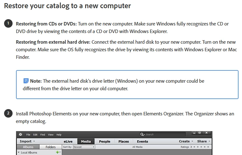

Now, to deal with your current situation, you say that you have a full backup of your catalog (with photos).  You can restore this backup using the procedures found in this HelpX article.  You should probably use the third option listed (restore to new location with original folder structure).  If possible, you should restore to an external drive or to a different internal drive than your photos are currently stored on.  Then, once the photos are restored, you can bulk import them into your existing catalog.  Elements should not import duplicates of photos already in your catalog.

Thank you for your reply! This give me hope! Would you recommend I create a new catalog before beginning this process? I would then have 3 catalogs which is fine but just checking if I should proceed with a fresh catalog? And to be sure I'm at the right stop, is the below image pointing to where I should begin?
