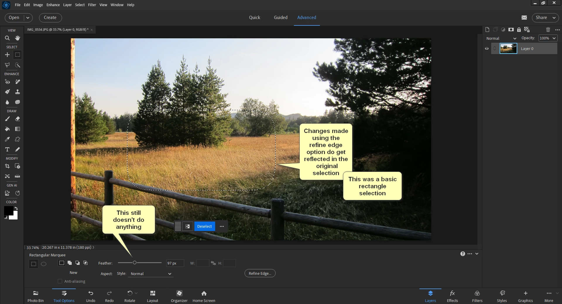

I've installed the update using your method of unintstalling then redownloading.   The slider tool still does not work for me- I have to use  the refine edge options as before.
Having your image in indexed color can affect this (from what I've found online.)
I have tried it in 2025, 2024, 2020 and 2014--- the slider dosn't do anything when using any of the selection tools/ options-   With all of those versions you have to use the feather / refine edges options.
I rarely use the feather slider
Glenn 8675309
Nov 19, 2025 12:44 AM UTC
Something I figured out:   You set the slider then draw your selection.   That seems a bit idiotic to me.

Hi all, the fix for this issue is now available in the latest update of Adobe Photoshop Elements 2026. Please update to the latest build to get this working.

Hi @elizabethg44485247,
Thanks for reporting this issue. It is already on our radar, and the team is currently investigating this.
For now, using the feathering option in Select Menu > Feature and Select Menu > Refine Edge can help unblock you.

@johnp5888287 , it doesn't work like that. Adobe will not tell me if a fix is in the works. A number of bugs have been reported so far. I would expect that some of them will be resolved in an update to the program. In the meantime, I suggest you use the solution posted by @99jon. IOW, use the selection menu for feathering.

No it's a bug. Thanks for reporting it Greg. I've also reported the bug with camera raw profiles.

Make your selection and when you see the marching ants go to the top menu.
Choose Select > Feather then entre a number of pixels and press OK
Press Ctrl+J to place the selection on a separate layer
Click off the eyeball on the background layer to see the selection and feathering
