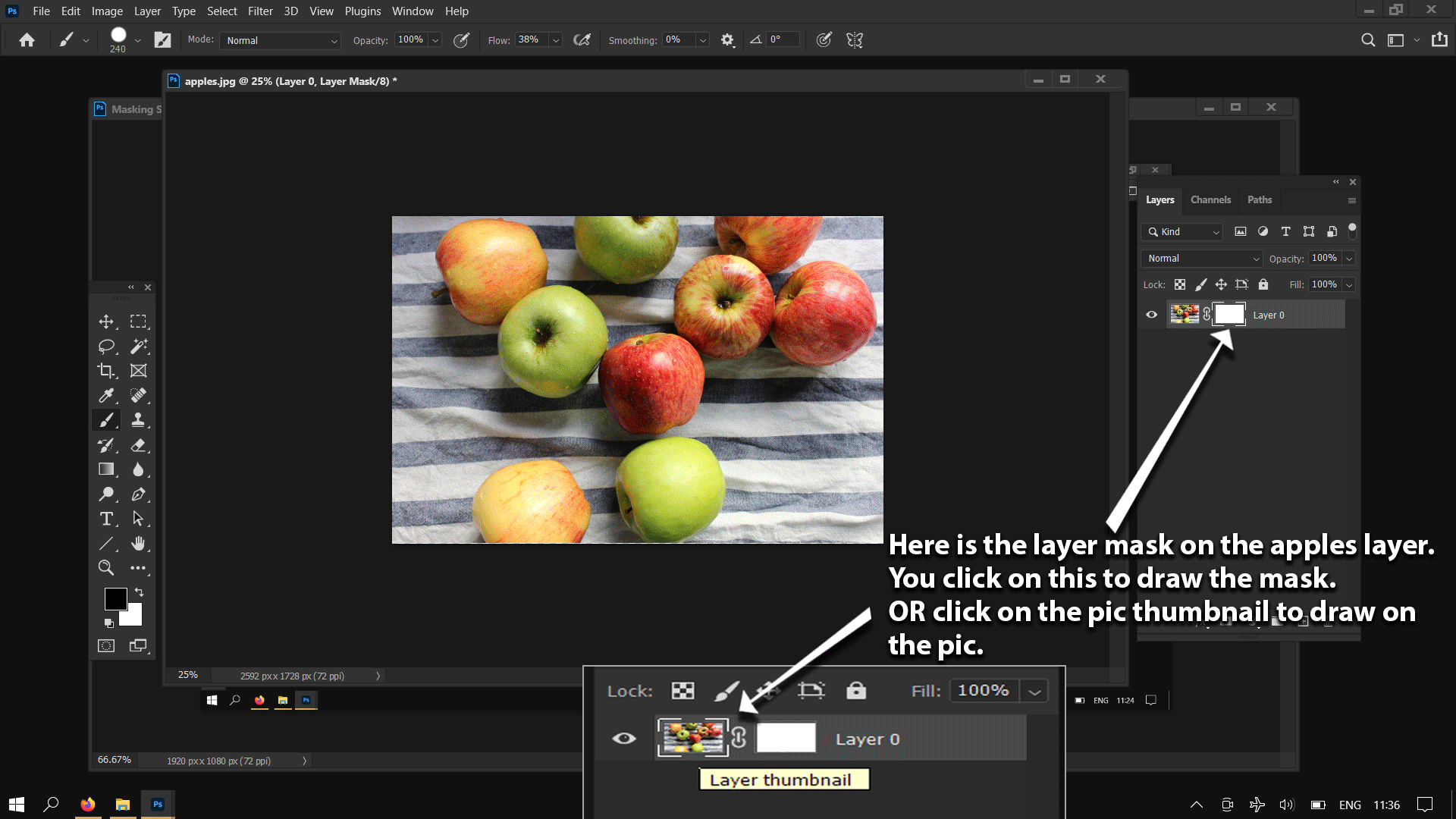

Masks are quite simple.
Where the mask is white - the pixels on the associated layer are visible.
Where the mask is black the pixels on the associated layer are transparent and the layer(s) underneath become visible.
If between black and white (i.e. gray) then the pixels on the associated layer become semitransparent.
That is it ... nothing technical .. nothing magical.
The screenshot below is Photoshop - but as mentioned early, most image editors work the same way
Dave

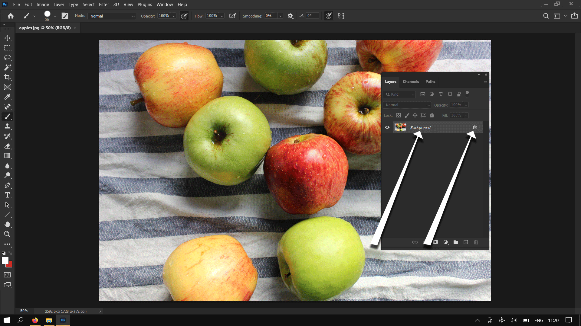

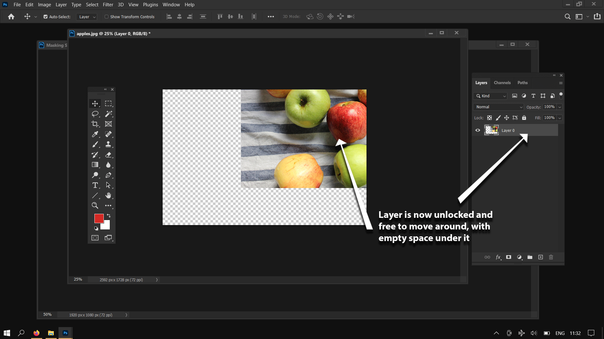

Ro Hackett
December 29, 2020
I would also add, don't use them on a background layer (background layers are locked and a mask will show through to whatever is set as the background colour). (Double click the background layer and hit OK which will make it a regular free layer).

Have a look at these screen shots to see how the basics work.
Open an image in photoshop it will open as a background layer. Here's some juicy apples.
 Now you have one single apple so it is always a good idea to keep a copy of the original image on another layer that is locked and hidden, or to keep it saved as another file, because it is now gone from this one. 😎 😂

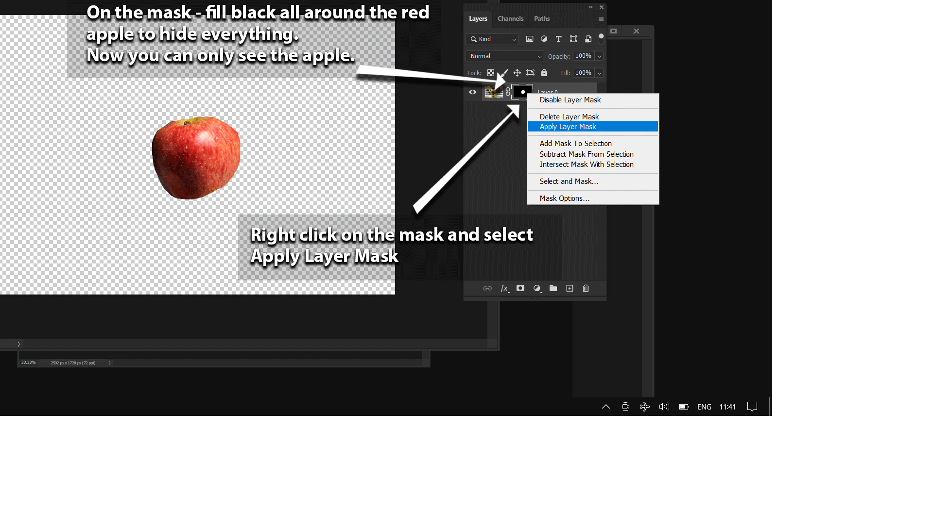

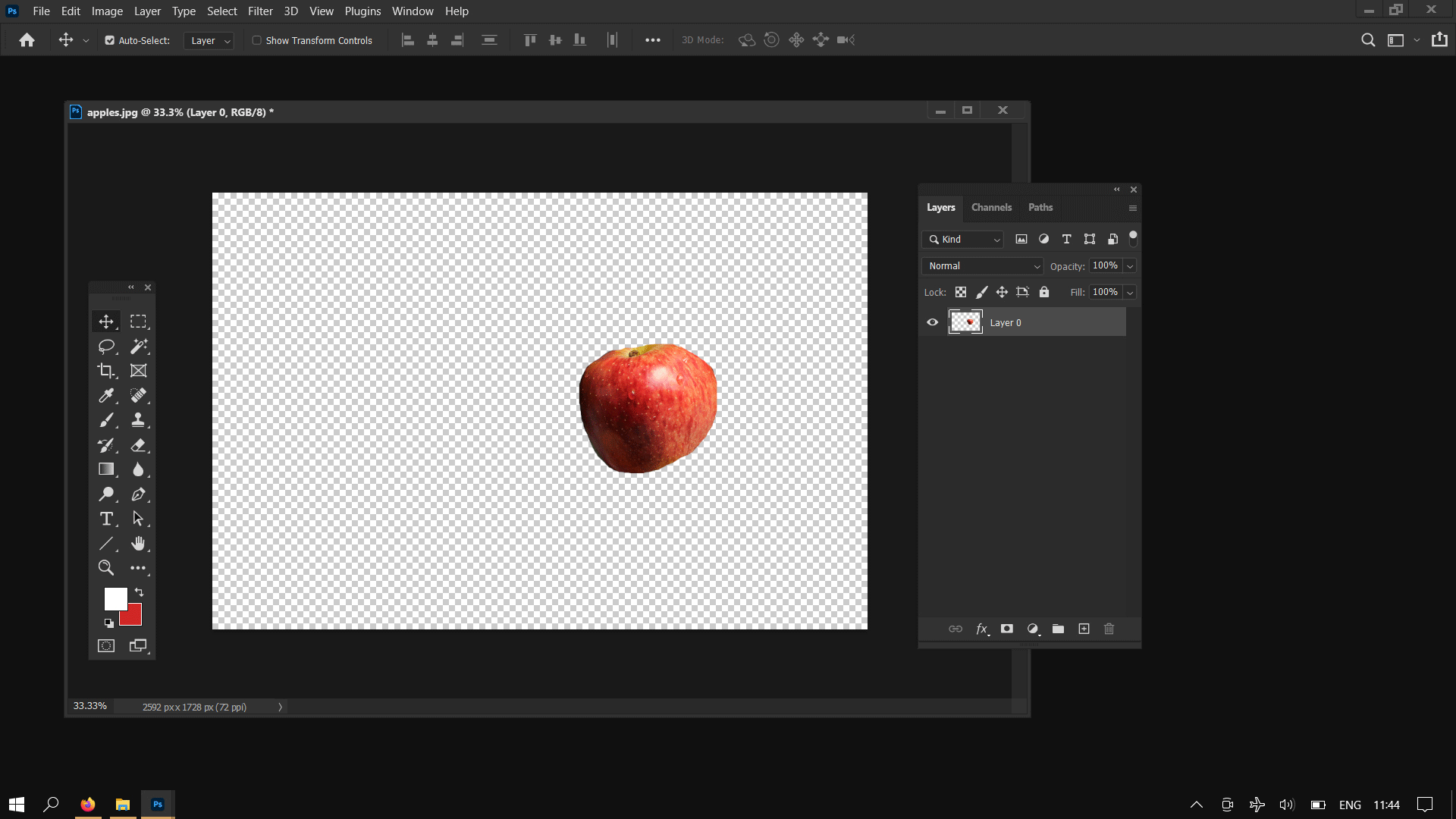

Well if you ever feel you like to try it once more... when you have a mask you have made on an image... right click the mask layer and select 'apply layer mask'... now the mask is gone and the image is changed. Be careful merging ALL layers. Keep a copy layer of the original full image on a layer but hide it and lock it and instead select 'merge visible'
