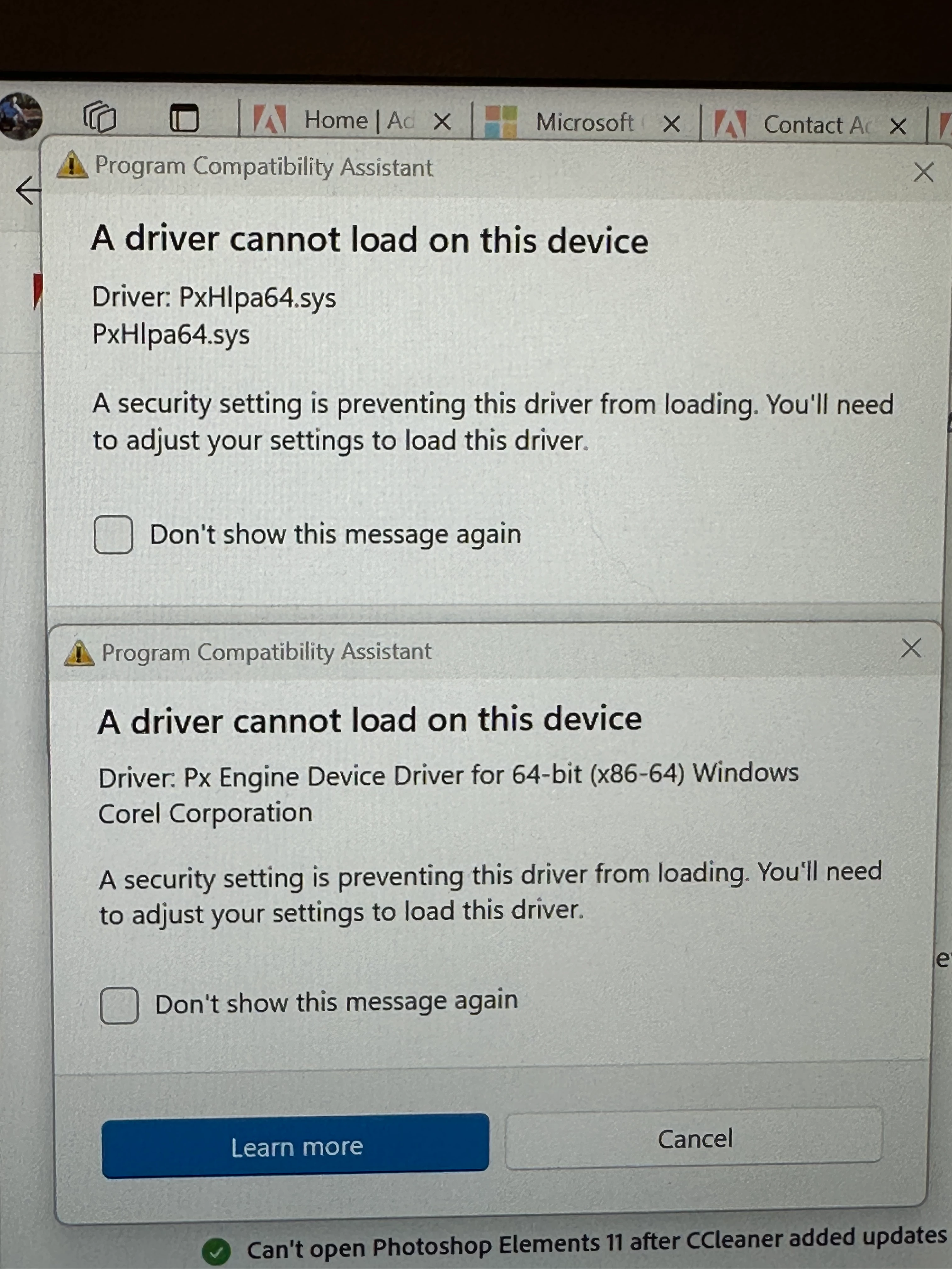

However, attempting an install of PE12 today (15/08/25), on a new laptop I purchased a couple of weeks ago, resulted in the error message:-
"A security setting (i.e. Windows 11's "Memory Integrity" feature, also known as "Core Isolation") is preventing this driver (i.e. PxHIpa64.sys) from loading.  You will need to adjust your settings to load this driver".  That is, turn off   "Core Isolation" which then leaves your PC vulnerable to security risks from exploytation of 'older' apps you may still be using.
Basically PE12 and possibly other early PE versions, will have this problem because, they are not 'signed' for release and use with W11 by Microsoft, because of their age.  And the PxHLpa64.sys driver is very old, therefore considered a possible security risk.
In closing, it is the PxHLpa64.sys driver conflict decribed above being locked down by the "Core Isolation" security function, which is preventing Windows 11 from successfully booting to the login screen or causing other issues when executing the program, namely rebooting in repair mode.  This may be an issue, by which controlled PE12 installation experimentation may or may not find a solution.

However I did locate and rename the PxHLpa64.sys file installed in C:\Windows\System32\drivers to ZZZ_PxHLpa64.OLD.  I used the ZZZ to relocate the file to the end of drivers listing.
After renaming the ZZZ_PxHLpa64 file i closed the displayed error messages using the "Don't show this option again" and rebooted the laptop.  The laptop rebooted successfully to the login screen.

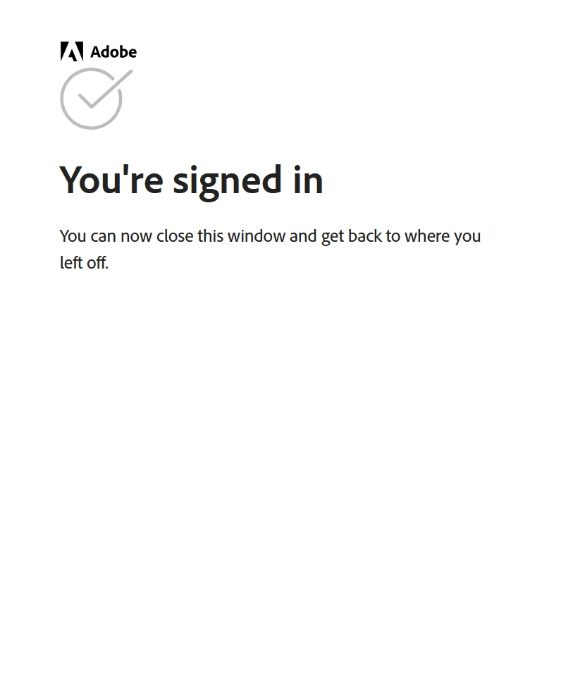

After login I opened PE12 using the desktop shortcut.  On selecting the PE12 option to open, the Adobe Sign in now dialogue opened to sign in and activate PE12, which did.
However. after signing in the message displayed, (see below) may or may not open the PE12 activation dialogue.
In my case, after numerous attempts to sign in,  it has became a circular loop back to the Adobe sign in dialogue.
Does anyone have any idea on how to get past this circular loop back to the Adobe sign in page???

Exactly the same thing happened. This is the screen message that came up during the install. Factory reset number 3 coming up. I guess it's just not going to be possible to load PSE12.
