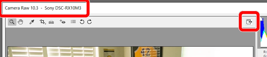

@elizabethj24522967, clearly the computer gremlins have been playing with your machine.  I am curious what version of ACR is now working for you.  If you can successfully open a raw file, the version number appears in the top left of the ACR Editor.  If you cannot see the version number, you must be in full screen view and can restore the window by clicking on the toggle button shown in my screenshot:

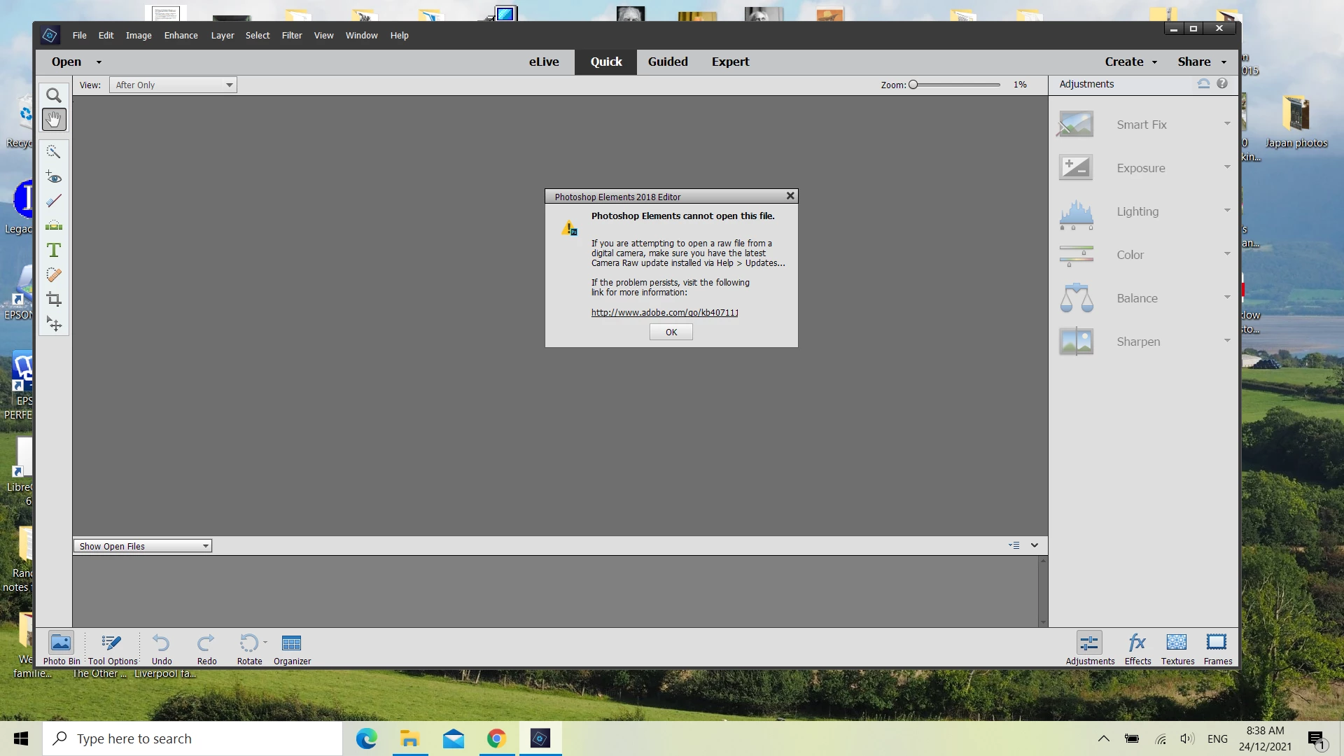

At the moment all I can do is open the jpg images on that editing etc page. I cannot get to the raw histogram etc page. The screen shot is what shows when I click on my ORF file.

Thanks for your response. When I start up Elements 2018, it tells me there is an update, but when I try to install it, it goes to an error page and then tells me my serial number is either wrong or out of date. So I contacted Adobe and they said Elements 2018 was out of date and not supported anymore and they couldn't and wouldn't do anything, but told me to contact this forum. I didn't think I need support as everything had been working fine, until the update. I can still access the standard parts, but not the RAW. Although I am an amateur, I do like to have control over the final image results from RAW.
