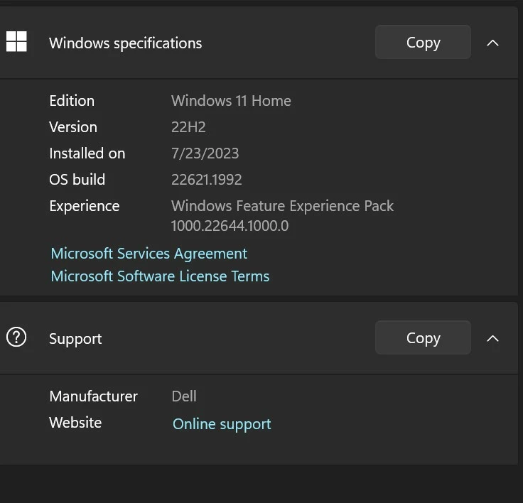

A Windows 11 failure caused my system to brick. After a effort by Dell Premium Support, they determine that the system had to been erased and Windows 11 and its updates had to be reloaded. Once this was completed, I then had to reload my apps and data files. I have dowloaded Photoshop Elements 2022 Version 20.0 LS30_win64.exe, but I have made no attempt to install it. My data backup was maintained by iDrive.com. I recovered the photo folders and files, returning them to the same logical heirarchy in which they were located before the system failure.

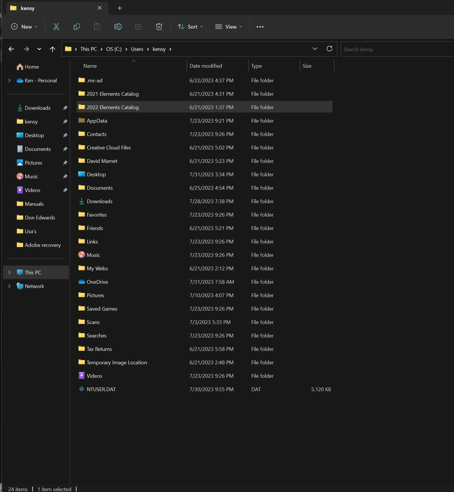

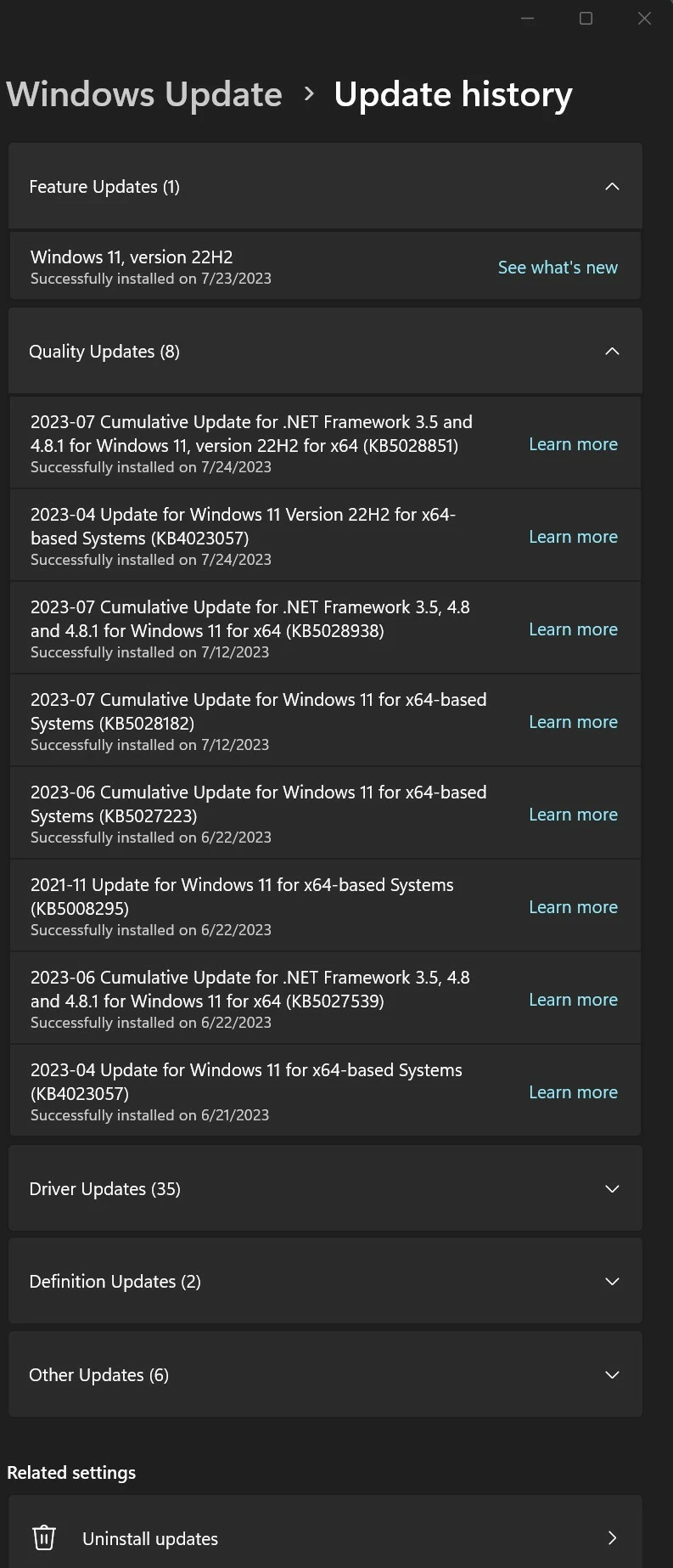

Attachments 1 through 4 show the folders, files and paths. Attachments 5 through 7 provide Computer and OS details.

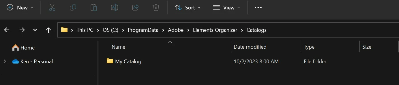

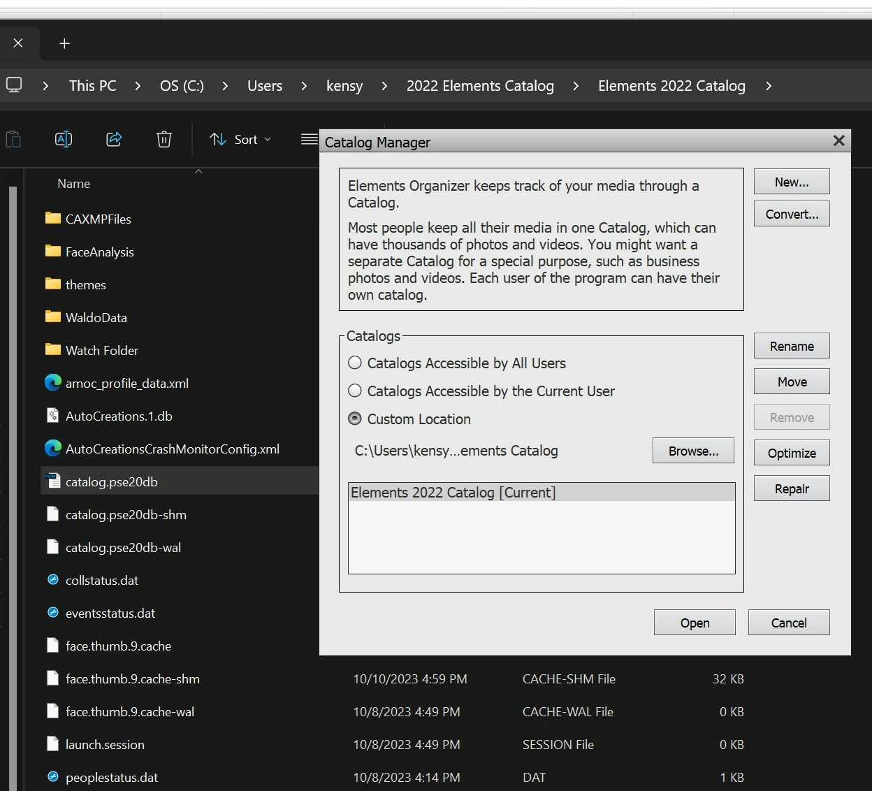

    Oct 12, 2023 6:28 PM UTC
    OK.  So, the catalog manager is showing a single catalog in the custom location.  If you click on the radio button for Catalogs Accesible by All Users, are there any other catalogs besisdes one named My Catalog?  And if you open those catalogs, do you have anything besides an empty catalog?
    In any event, with the Custom Location catalog selected, have you tried performing a Repair and Optimize.  It may take a while to perform each.  And even if you get a message that says no problems were found, complete the Repair anyway.  Also perform the Optimize.
    And, in future, if you get the abnormal exit message, it doesn't hurt to try again.
    KPS1941Author
    Oct 12, 2023 8:15 PM UTC
    I clicked on Catalogs Accesible by All Users, but it showed no catalogs. I will try Repair and Optimize tonight or tomorrow.
    Thanks!!
    KPS1941Author
    Oct 14, 2023 11:40 PM UTC
    Greg,
    Everything looks just fine! I really appreciate your patience and the help you have given!

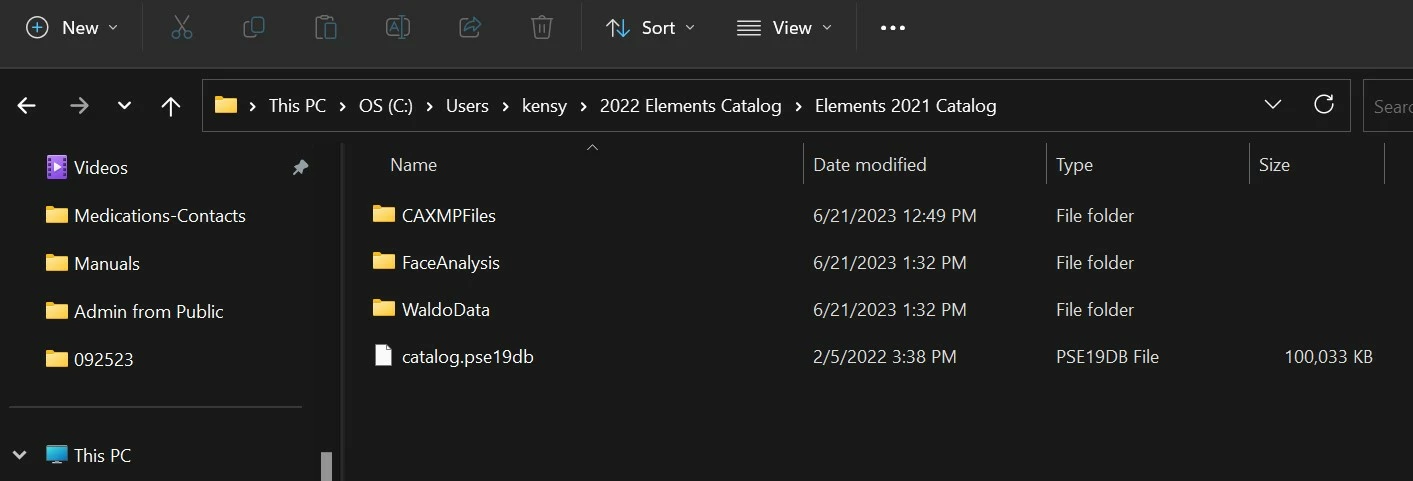

    KPS1941Author
    Oct 12, 2023 4:28 PM UTC
    Thanks, Greg.Everything was helpful and I expect it will be useful in the future.
    Here's what I did:

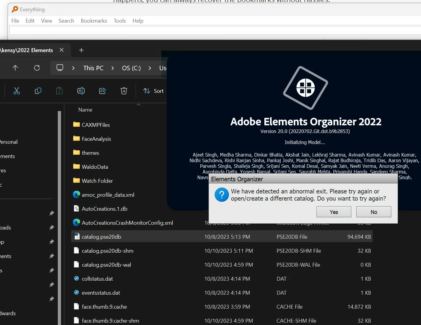

    I installed Premier Elements 2021, then double-clicked on “catalog.pse19db.” It opened in Premier Elements 2021. I did a cursory check and everything looked good. Image files and tags were up-to-date only to Dec 2021; that’s not ideal, but it’s better than starting from the beginning.
    A short while earlier, I attempted to open “catalog.pse20db” by double-clicking it. That failed and Elements 2022 crashed; a crash report was sent to Adobe, together with my notes on the background. I thought I should try that again, so I could document the results. This time after double-clicking “catalog.pse20db,” I received the following:
    I selected “No” and received this:
    I then selected “Elements 2022 Catalog (Current),” the  I received this:
    My question is can any of the buttons here be used to resolve the problem with “catalog.pse20db”? My hope, of course, is that solving whatever problems with it will restore my files and tags, etc., up to this year.
    If not do you see any other course of action?
    Ken

    Sep 27, 2023 10:15 PM UTC
    Ken, I'm sorry, but your folders are a complete mess.  So, first let's see whether there are any catalogs where they are supposed to be.  What is in the following folder:
    Also, have you tried opening the catalog.pse19db file shown in your second screenshot.  In this regard, do you have (or can you reinstall) Elements 2021 on your computer.  If so, try double-clicking on it and see what happens.  Interestingly, it is slightly larger than your Elements 2022 catalog.  If you don't have Elements 2021 installed, you can try converting the catalog in Elements 2022.  Go to File>Manage Catalogs and use the Convert button.  You will then have to navigate to the Elements 2021 Catalog folder and the catalog should show up in the conversion dialog.  If not, make sure that the box is checked to show previously converted catalogs.
    Also, it might just be easier to contact Adobe support. With your permission, they can take control of your machine and see what is going on in the folders easier than we can do on the forum.  But, if you decide to do this, you should do so soon, because the time for support of Elements 2022 may soon be running out.
    KPS1941Author
    Oct 4, 2023 1:15 AM UTC
    Greg,

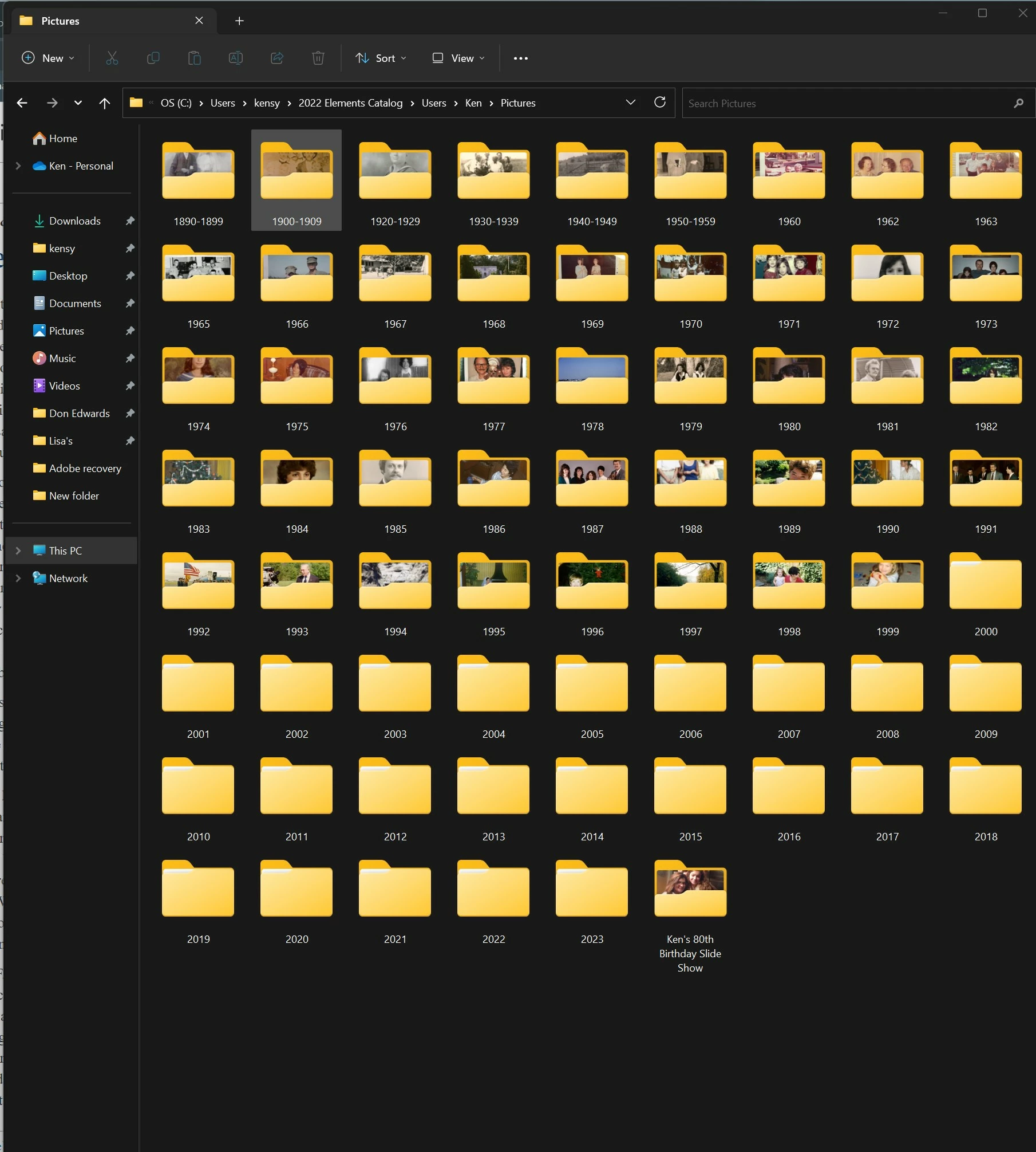

    Here is the screenshot you asked for. The only item in that folder is “My Calendar.”
    Here is a screenshot of the contents of “My Calendar”:
    Meanwhile, back to the odd path of OS (C:)>Users>kensy>2022 Elements Catalog>Elements 2022 Catalog:
    Regarding catalog.pse19db, please note that its date is 2/5/2022. Later that month I installed Elements 2022 and discovered that, for whatever reason, I had lost all of my photo tags. It was at that point that I decided to just go ahead and retag all the photos. The date on catalog.pse20db is 6/19/2023, shortly prior to when my computer bricked.
    I didn’t retag my photos using Elements 2022 in the same manner as they were with Elements 2021, so I’m not surprised that catalog.pse20db is smaller than catalog.pse19db.
    Given the date on catalog.pse20db, plus the other support folders and files in the folder Elements 2022 Catalog, it seems to my admittedly ignorant eyes, that catalog.pse20db is the better of the two catalogs to use. What do you think?
    The option you suggested of using Manage Catalogs to restore seems reasonable. What about using Manage Catalogs in Elements 2022 to connect to catalog.pse20db? If this seems to you to be a reasonable approach, how exactly would I do this? (Would this still a conversion?)
    Thanks for all you help!
    Ken

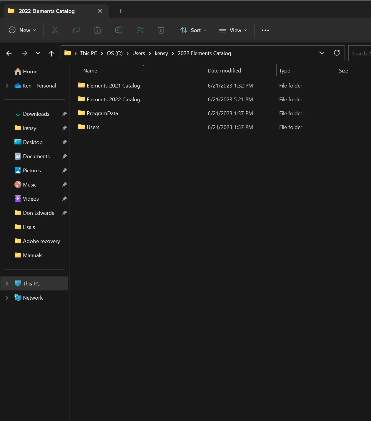

    Greg_S.
    Sep 24, 2023 12:49 AM UTC
    Hi Ken.  Sorry for not getting back to you before now.  I have taken a fresh look at your problem and your screenshots.  They have raised a number of new issues in my mind.  I don't know whether we can salvage your catalog, but let's give it another try.  (In future, if you are posting a screenshot, please do so within the body of the post rather than as an attached file.  It is far easier to view and compare that way.)

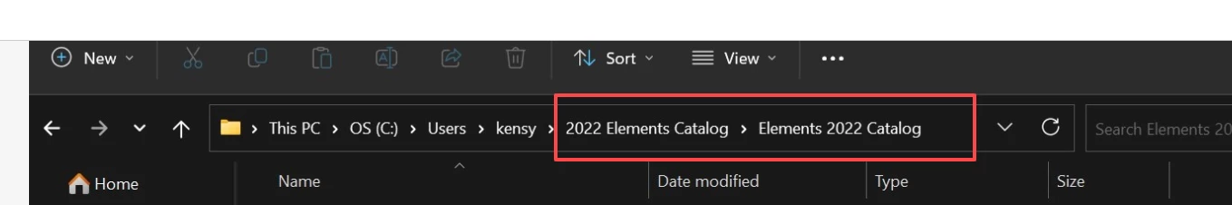

    So, going back to your original post, I see a number of issues that need to be resolved.
    • First, your media files have been put in an unusual (and unsuitable) location. Was this intentional before the crash or was it a result of you restoring computer backup folders/files without really paying attention to the original location?
    • The above screenshot demonstrates that you have duplicated the folder path within itself.  It also strongly suggests that when Dell reinstalled the OS, a different User account name was applied.  So, although you have said previously that you replicated the earlier Pictures folder hierarchy, that does not seem to be the case.  As a result, the hierarchy is different and the restored catalog will not know where the photos are.
    • The default location folder for Elements catalogs is shown in one of your screenshots.  Please show us the contents of the folder I have highlighted in the following screenshot:
    • The Elements 2022 Catalog folder is contained within a folder named 2022 Elements Catalog.  Again, something seems to have gone wrong with restoring folders from your backup files (or at least is causing confusion for me, if not for you).

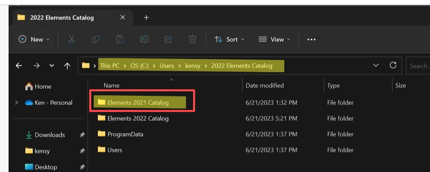

    • One other possible ray of hope:  Your prior screenshots show that there is also an Elements 2021 Catalog folder (within the 2022 Elements Catalog folder.  What are the contents of this folder?  Perhaps there is a valid catalog that can be converted in Elements 2022.  Even if it is an older catalog, it may save some work if all else fails.

    KPS1941Author
    Sep 27, 2023 12:13 AM UTC
    Greg,
    I'm not certain what Dell did, but the hierarchy appeared at that point to be the same as it was before the computer bricked.
    When I accessed my backed-up files on the iDrive cloud storage, I selected download to the original logical location. Based on a local offline copy, I found no errors in that operation. The peculiar file paths are the same as they were in the original file system. I first noticed them in a previous version of Elements. The tags for the Elements 2022 (Version 20.0) system (pre-crash) were built on that pecular file structure. I encountered no problems with Elements 2022 since I installed it in February 2020. Here's the screen shot of the folder you asked for:
    Let me know if you need shots of the folders within these.
    FYI, here's a shot of the Elements 2021 Catalog within the folder 2022 Elements Catalog:
    And here's Elements 2022 Catalog within the folder 2022 Elements Catalog:
    I'm fairly certain when I was tagging photos before the crash, that I was interacting with this catalog.
    What do you think?
    Ken

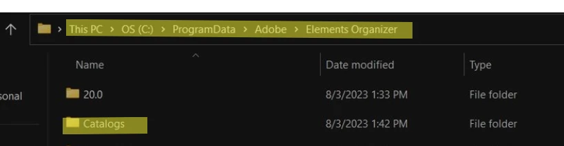

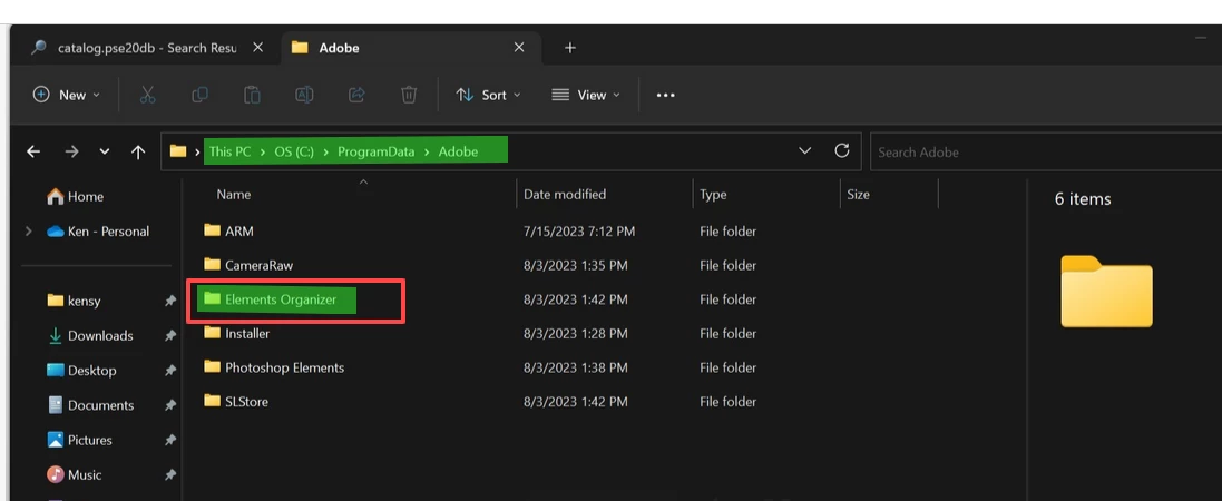

    Aug 4, 2023 3:15 AM UTC
    Your latest screenshot shows that the opened catalog is named the default My Catalog.  However, earlier, you said:

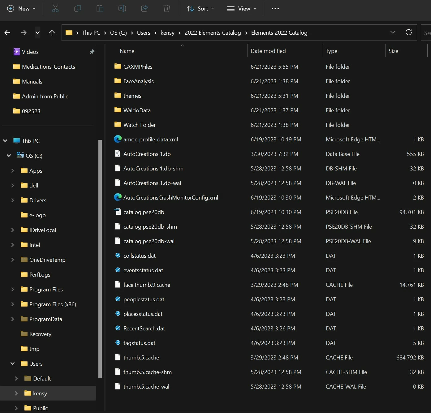

    I've located the file named "catalog.pse20db". Its size is 94,701 KB. It is located in the folder "Elements 2022 Catalog". Here is the path:
    "C:\Users\kensy\2022 Elements Catalog\Elements 2022 Catalog\catalog.pse20db"
    Normally, the catalog name is derived from the folder containing the catalog.pse20db file.  In your case the catalog should be named Elements 2022 Catalog.  That suggests to me that you double-clicked on the wrong file.
    How was the C:\Users\kensy\2022 Elements Catalog\Elements 2022 Catalog folder restored to your new installation?  Please give us a screenshot of the contents of that folder.
    KPS1941Author
    Aug 5, 2023 6:43 PM UTC

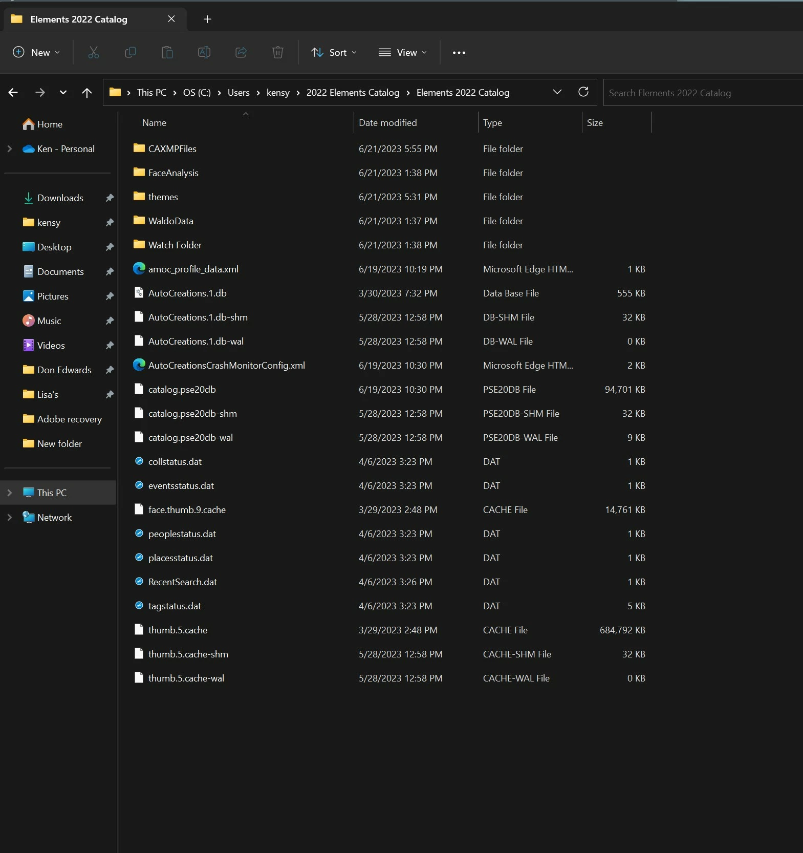

    The file structure and content was recovered from the latest backup data stored in the iDrive (iDrive.com) backup database for my computer. It was restored to its original path in my computer. The Organizer screenshot I sent was what was immediately displayed when I double-clicked "catalog.pse20db" in the path:
    The contents of the Elements 2022Catalog is attached in #1 Elements 2022 Catalog Screenshot 2023-08-04 201409. Would it be helpful to you to see the contents of any of the subfolders?
    Also, I've attached #2 Adobe ProgramData Screenshot 2023-08-04 202954. Back on Aug 1, I mentioned that the Adobe ProgramData folder contained only the folder "ARM." #2 shows a series of folders created on Aug 3 when I double-clicked "catalog.pse20db." Would it be helpful to you to see the contents of these folders?
