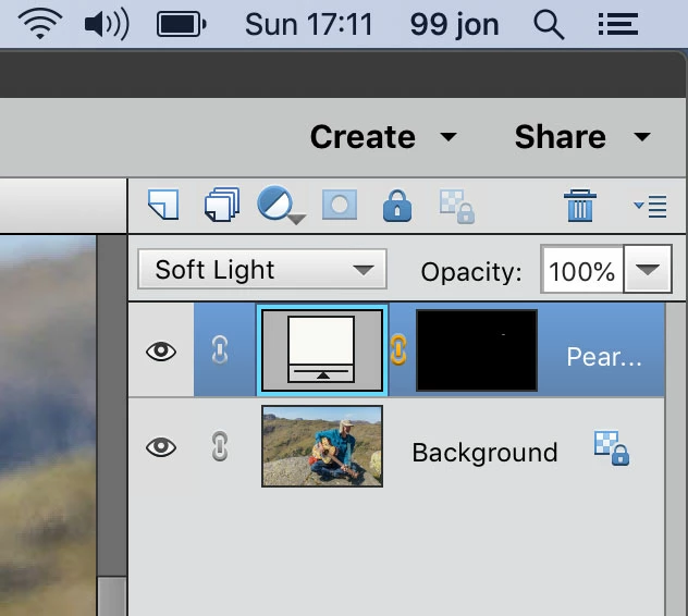

Works OK for me on Mac. If you are using the Quick workspace after selecting the teeth with the tooth brush tool (marching ants) click the Expert button to switch to that workspace. Then click the layers button at the bottom.
Ensure you don’t have the black mask selected. Double click on the layer adjustment thumbnail so that it is highlighted in blue - see image below. Then click top left with the color picker to choose white.
