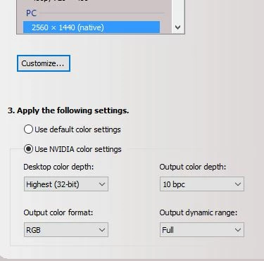

March 22, 2019
This isn't true. The GTX 1080s and 2080s do support 10-bit if the monitor supports it. The 980s may as well, too.
The option to turn it on is on the Nvidia Control panel under the change resolution tab. Under #3 change the option to Use Nvidia color settings and you will have the choice under output color depth to change it to 10-bit.
Here is a screen grab:
