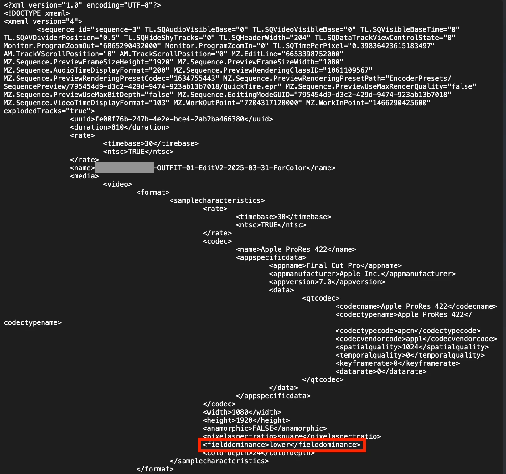

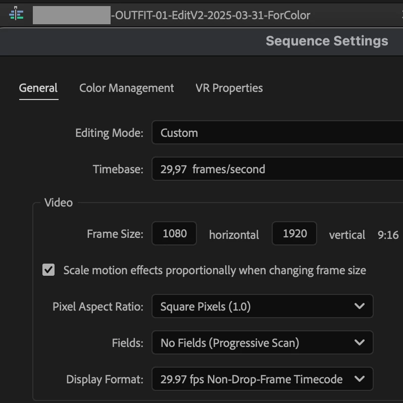

29.97 fps sequence set to ’Fields: No Fields’ exports in FCP XML as ’fielddominance lower’
I was exporting xmls of my 29.97 fps sequences between Premiere Pro and DaVinci Resolve but I couldn’t understand why DaVinci interpreted them as 59.94 interlaced, when my sequences in Premiere are set to Progressive Scan. I checked inside the xml files and all of them were exported with the <fielddominance> tag set to ’lower’.
Is this a bug or am I misunderstanding something?
Thank you.
