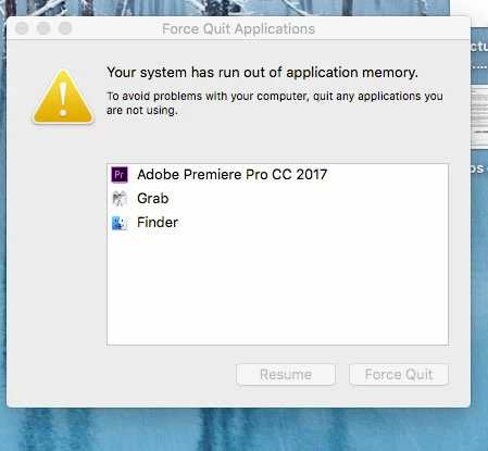

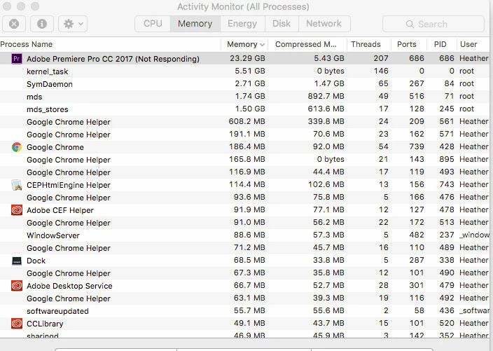

#1, (DYNAMIC LINKING AND MEMORY LEAK) We were discussing the dynamic linking in another forum post, I said I had already gone through the trouble shooting process with customer service with remote desktop and you asked if I wanted to escalate it further. For the moment I'm going to hold off but I may reply in a few days to that question. I saw somewhere that if you uninstall and reinstall the creative cloud app, it may alleviate any problems you have. I did do a "repair" to the creative cloud app and I haven't tested the dynamic link yet, because I have a few corrections I need to do to the file I'm working in.   But I think there is a bigger issue with this and that is a memory leak, which seems to have been a problem in the past wth the cc when I searched it.

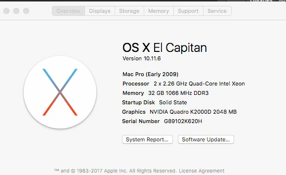

#2, (DRAGGING WITHIN PP) I do work on a desktop MAC that was put together by my son a few years ago it has 2 Dell monitors.  One of my monitors I just changed out in December. And recently my ability to drag within Premiere pro was not working. It had me completely stumped for several days.  I read somewhere on this forum a random fix - to drag the window to the other monitor and back. I also read that there was a problem if you had a particular type of monitor, which I don't have. So that is a pain in the ass. What's up? I drag pp to the other window and back again and it works again. But sometimes I have to do it every few minutes. It's just stupid.

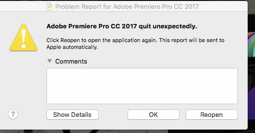

I opened my file and did a few edits, saving after each one because it is so unstable I don't want to lose my work. 3rd edit I did it locked up. I get about 10 minutes of work and its over. But guess what? this time it actually gave me an error. It has something to do with dragging the clip.

Stability - all day long I'm dealing with this (below) all FREAKING day long. Yes it is a large file, It's my docu series - yes I've been using the same file for a long time but converted/upgraded with new versions, but there are over 19 hours of footage that I need to reference including stock footage. (which I have the program and assets and cache spread out on different hard drives) Sometimes all I do is drag a clip audio or video longer,  and it locks up, perpetual spinning wheel.  I have to save every few minutes so I don't lose everything. I like premiere and have a lot invested in premiere but this is unbearable.  THIS ALL STARTED a month or 2 ago. But the updates aren't usually backward compatible so I don't want to revert or I'll lose a bunch of work.
