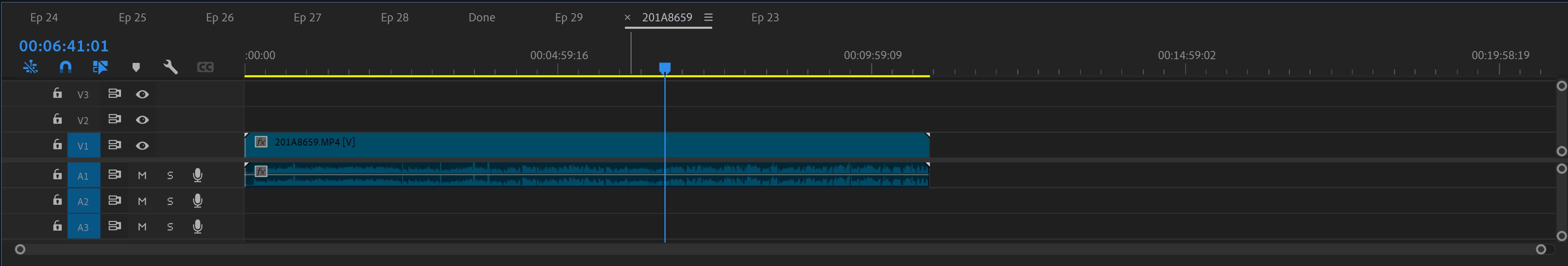

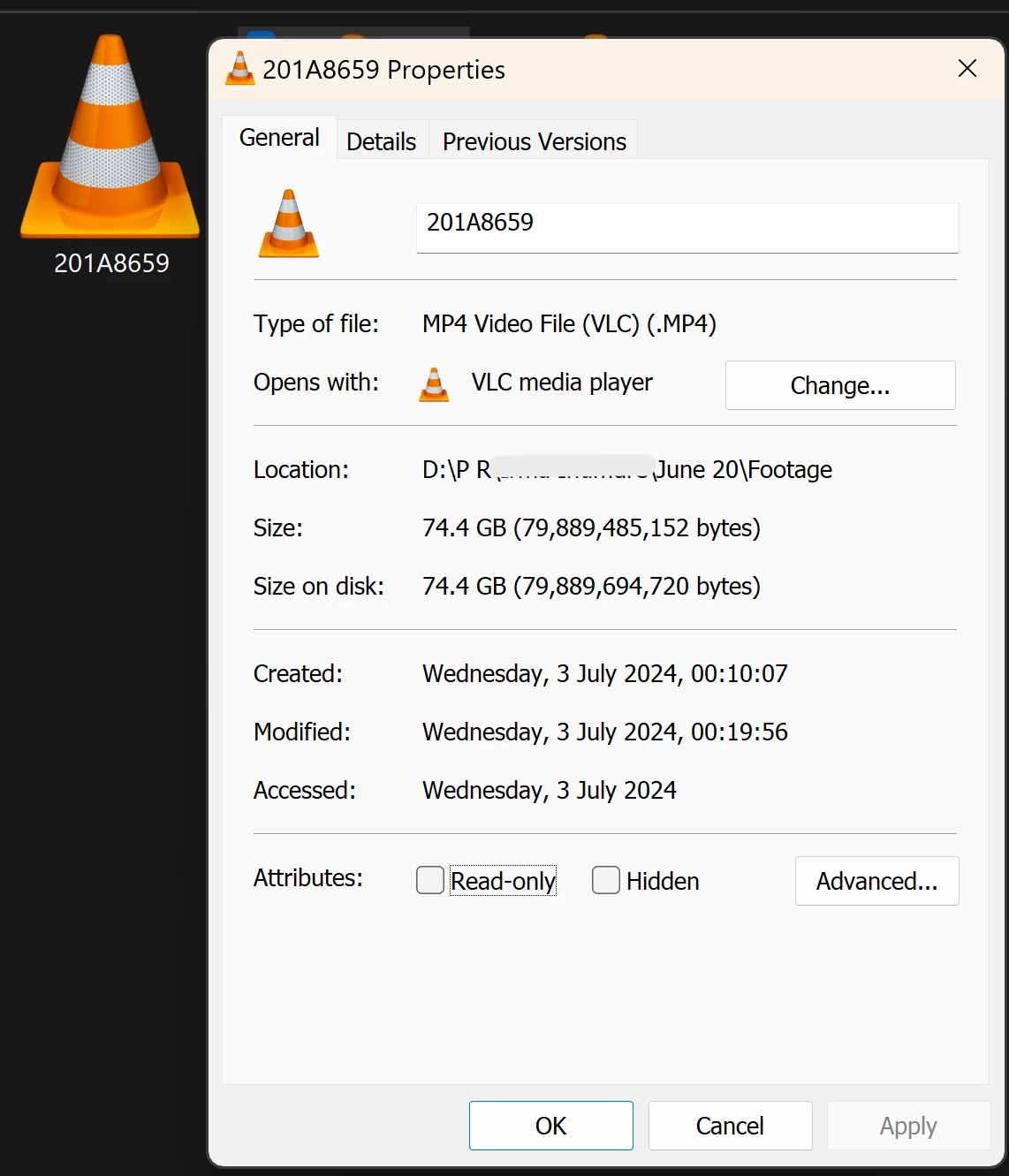

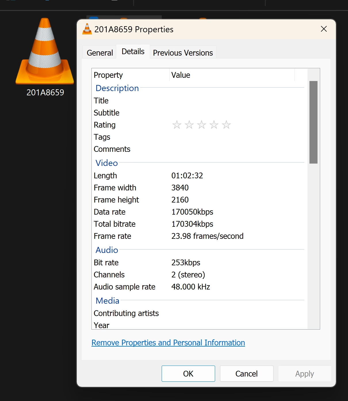

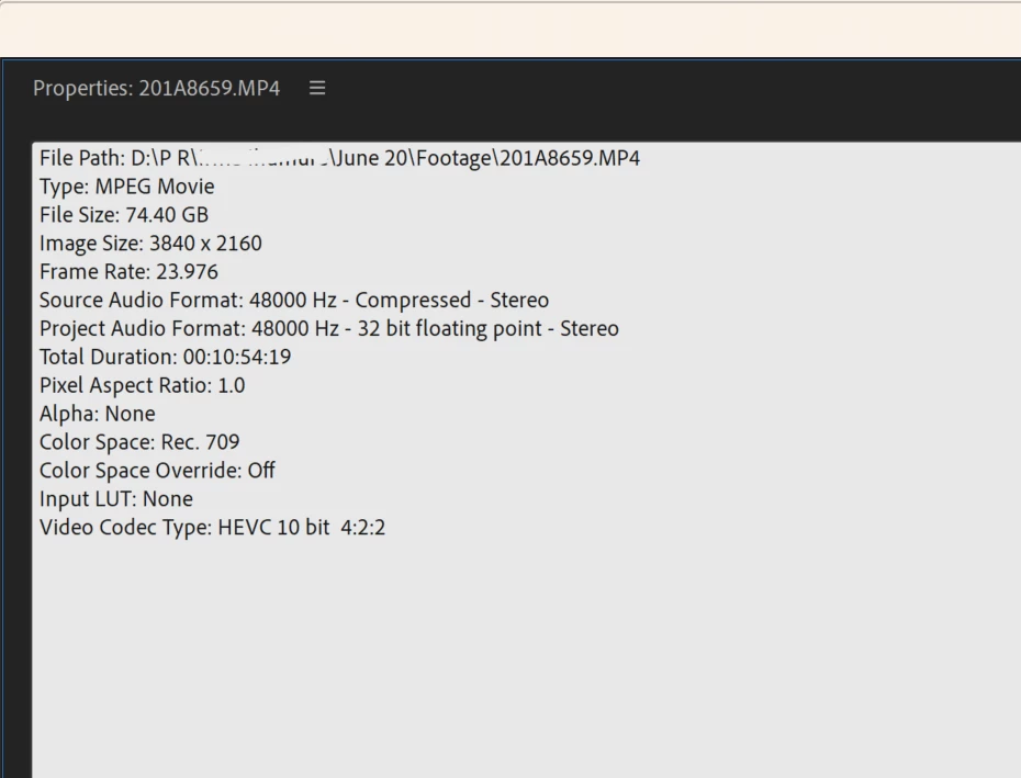

Has anyone encountered an issue with long 4K log files from a Canon EOS R6 MK II not playing fully in Premiere Pro? My 1-hour 4K log video (74GB) stops playing after 10 minutes when imported in premiere pro 2024 or adobe encoder, even though the full duration is detected when you check the details in the file's "properties" while in explorer/finder. I tried converting with HandBrake, but the issue persists. Any advice to fix it or similar experiences. I have attached the screenshots. Thank you so much for the assistance.
My editing setup: 11th Gen Intel(R) Core(TM) i9-11900H @ 2.50GHz 2.50 GHz, RTX3080, 32GB
Please note that while importing this file, it makes the PC run so slow and sometimes causes premiere pro to crash.

First, the free utility app MediaInfo is the standard around here for file data reading.
Second ... I'm wondering if that is a "spanned clip" ... in other words, the camera breaks the long files into shorter bits filed separately in the file system on the card.
Spanned media works if and only if it is both uploaded to the computer properly, and imported into Premiere properly.
So copying the folder structure from card to computer is required, to ensure getting the needed data files included. And at times using the MediaBrowser panel to import the media into Premiere.
