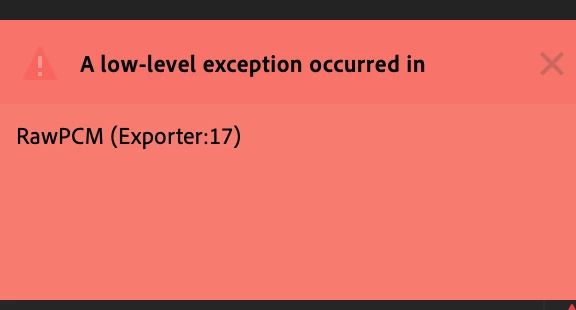

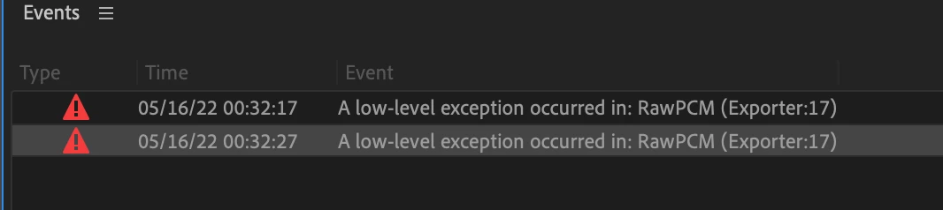

I am trying to automatically translate my audio sequence into Spanish (as I did before) and when I click on "Create Transcription" it generates the error: "A low level exception... Exporter 17"
Only with the Spanish language.
does anyone know how to fix it? has happened to them?
Thanks a lot!
Correct answer yosoyelcapi
I found an origin that generates the problem in my case... I solved it by removing the effects of the Audio Track Mixer, clean audio and I can only generate the subtitles without error.
In case of having effects, it keeps giving me an error.
