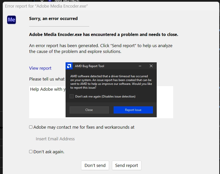

Adobe Media Encoder Crashing
The Media Encoder is crashing consistently whilst trying to export a project to MP4 video format. I had the project at around 15GB for export but crashed consistently .It didnt like a Warp Stabilizer preset so deleted that from the project. No go still crashed. So then I cut the project in half Part 1 and Part 2 as speparate projects. Tried part 1 at 7.42 GB with 6 sequences for a total duration of around 31 minutes, crashed at 3mins 58 sec into encoding roughly about 2/3 the way complete. It also causes the AMD Graphic to crash as well . I have had soo much drama with this lately and at the point of looking for some other editing program as this is so frustrating.

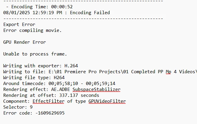

Well I continue to try and Encode this video with mixed sucess after breaking it into three part I was able to complete Pt 1-2 and thought I was on a roll but unfortunately got ahead of myself because when I tried the last (Pt3) continued Fails and Error Crashes.Today I tried turning the project into four parts but still fails and crashes. I have taken out AE Intro , put it back in, uninstalled PP and ME and reinstalled but still Fails Encoding The longest it has encoded this time is 54 seconds and the Fail report seem to be always the same Error Code 1609629695 Have attach the Failed Message

Hi @JP2512 -
Thank you for the screenshot. It looks like you’re running into a GPU related error with an effect at the timecode shown. This often indicates that certain effects are conflicting in the current order.
We recommend trying one of the following:  Reorder your effects in the Effect Controls panel, or Nest the clip, then apply Warp Stabilizer to the nested sequence
For more details, please see this article: Order of Effects matters

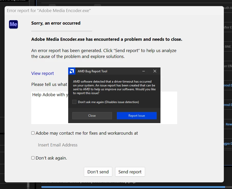

July 31, 2025
Hi Jamie
Well we have decided to have more torture. Today I notice that in this project I have two short AE Intro clips that were  "green" in the original project sequence, but seem to on the whole playback okay. I then decided to remove them completely from the the sequence. I then started a new project and using the Media Browser import the four sequences into the timeline. After each import render and playback the sequence doing after all four were added to the timeline. The playback on the last started to be choppy and hang but did play (Total Project 16 minutes ) I then exported the project to Media Encode via PP ,started encoding, hung crashed , Error Report. Have sent that through just minutes ago. Anothe session of frustration
