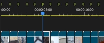

  • Issue - When adding clips from a bin to the timeline, via "Automate to Sequence" to match the 'markers', there's a gap / blank space of 1 frame. Image below.

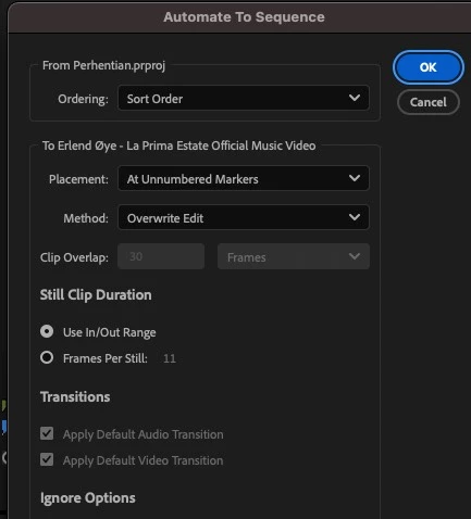

    2. Go to Clip > Automate to Sequence
    3. Click OK after the below, especially for Placement is "At Unnumbered Markers"
    4. The clips would then be placed into the timeline.

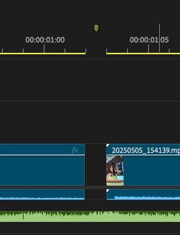

  • Actual result -  Clips are placed to match the Markers, but there is a blank of 1 frame. (see below, there is a tiny gap on the yellow line)
