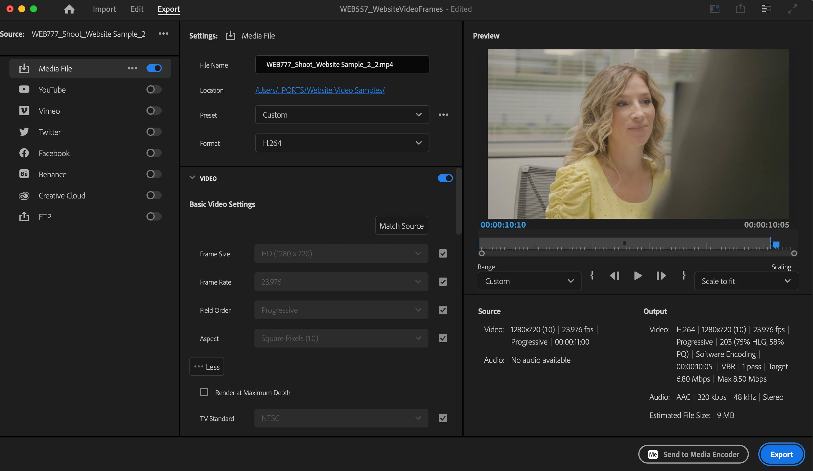

I don't want, and also don't think you should have to, set in and outs for 15 videos to not have a black frame added to to the end of your video. Adobe should definitely have an option to export to the end of the video frame.

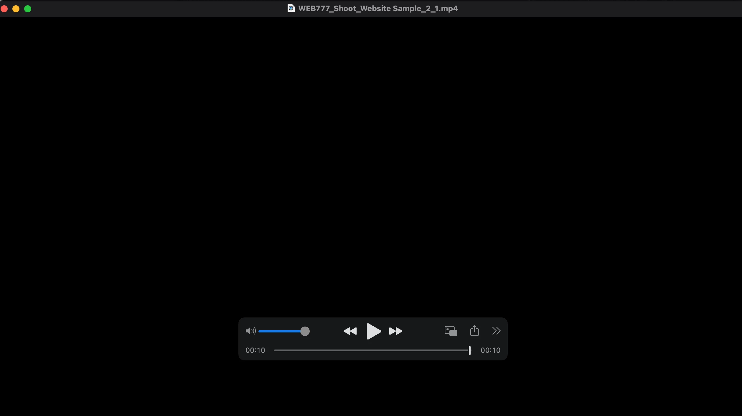

I did turn to doing this all manually and attached is an image of my settings. I am custom changing the in and outs and export custom field to export earlier in my clip to get rid of the black frame at the end. Although I can change the amount of time in the clip, they all end with a black frame. Any idea why?

Figured it out. H.264 is for some reason adding black frames. Quicktime, software encoding and the "Work Area" gave me what I wanted.
