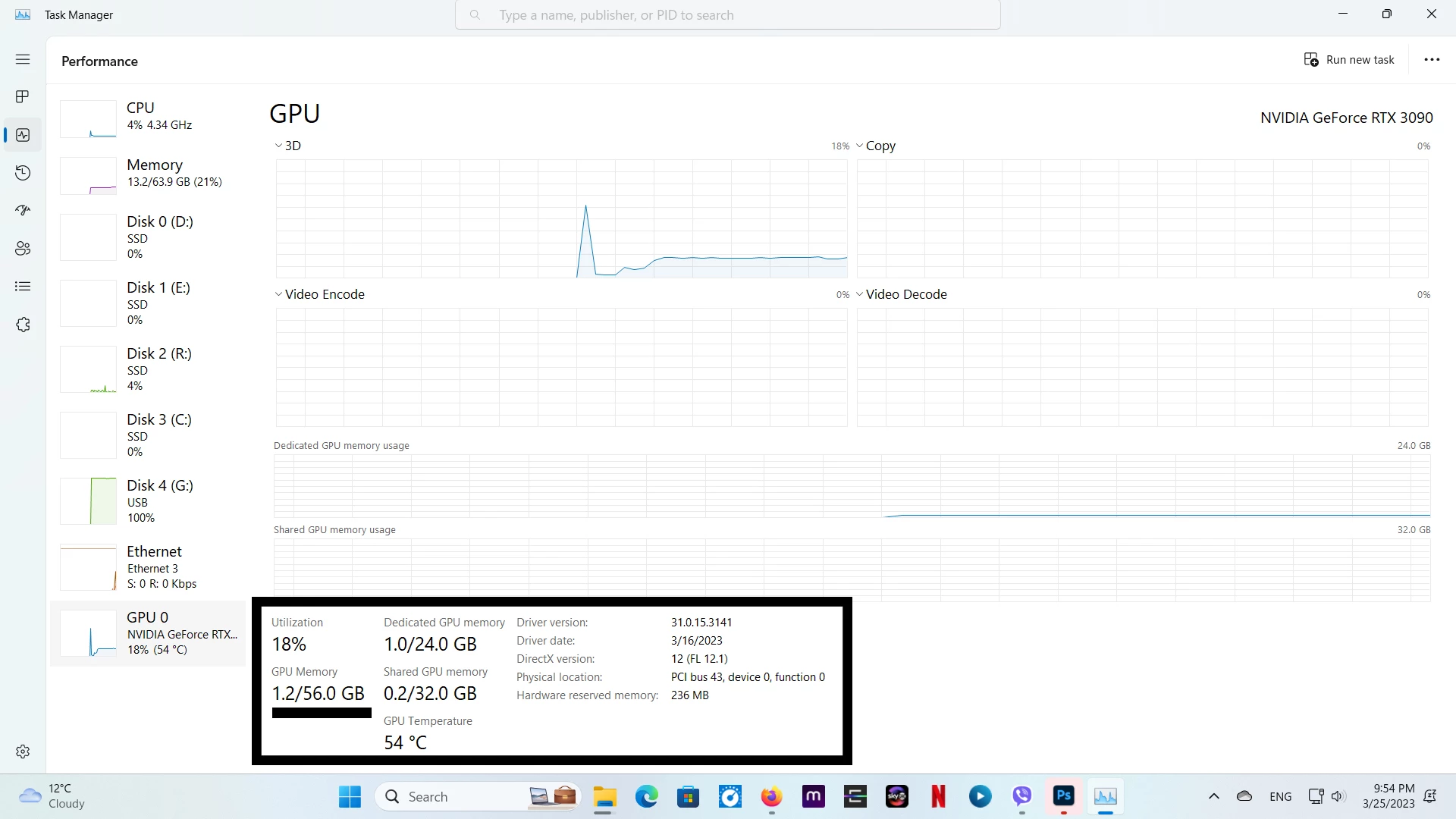

Let's start with solving problems with NVIDIA cards, my experience is as follows. In order to effectively use the power of the system itself and the Adobe Premiere pro program, you have to make a few modifications and you have to have a little patience when setting up the system itself. Because many of you do not know how and in what way to properly uninstall the nvidia driver so that problems do not occur. Here is the link: https://www.youtube.com/watch?v=F8OLhUAPDq0
the way drivers are properly uninstalled, my recommendation is to turn off the internet in this procedure, the simplest way is to remove the cable and your computer, before that prepare a program called DDU and the desired driver. As you can see from the picture I am uploading, windows always allocates half of your RAM memory to the graphics card, so in my case 64 GB of RAM memory is allocated half to the card that has its own VRAM memory, in my case 24GB VRAM, try to confuse RAM and VRAM. What is important is to prevent any possibility of the Premiere pro misinterpreting what is RAM and what is VRAM, because he sees the total amount, which for me is an incredible 56GB, meaning GPU 24GB and the shared RAM half of 64 equals 32GB, giving a total of 56GB. with some it will be less because they have less RAM in their computers or they have a GPU with less VRAM. in order to increase the possibility that the system does not run out of resources when importing huge 4K files, it is necessary to increase caching on the system hard disk, that is, on C. here is the link: https://www.youtube.com/watch?v=gx6ffIMSy28
I increased from the allocated 76gb to a safe 189gb, which means that you must have a fast and large system disk, at least 1 terabyte, in my case it is 2 tb.
Another tip, any overclocking program or monitoring of computer parameters leads to system instability, so you must not use HWMONITOR or MSI AFTERBURNER. No overclocking or undervolting is allowed if you want a stable system.
