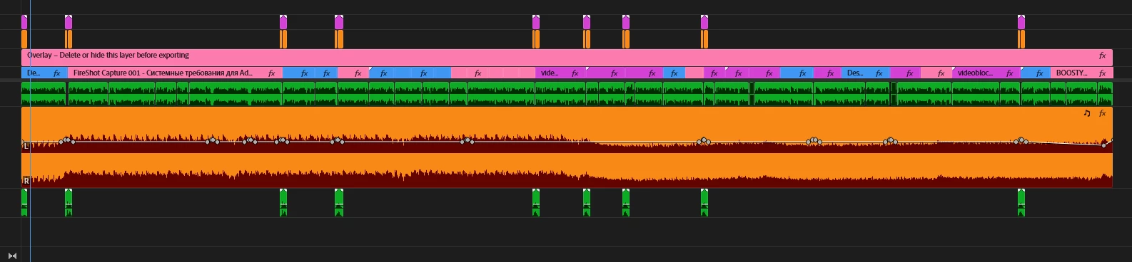

Seems like this problem cannot be resolved. As far as I understand there IS some audio transcoding once the export starts and the only problem that all Premiere Pro users have with it is Premiere Pro showning 0% progress during this process. Media encoder on the other hand shows this progress fine. So cannot Adobe just make the progress bar work as it should - i.e. show the actual progress of the audio rendering?
I had a simple project yesterday. It was an hour long screencast in h264 recorded with NVidia overlay. So after I cut it in quite a lot of pieces I still had to wait for this audio files rendering to finish which showed 0% all the time. It had no effects, overlays, text layers, anything, just obe video clip with the sound:
I restarted the process several times thinking that my export just froze. In fact Premiere Pro was doing this audio rendering but in the background showing 0% till the process was over. Should the process have shown the actual progress, I'd have had no questions. So this 0% progress is the only thing that should be fixed. We - Premiere Pro users - can wait another 3-5 minutes if we actually see what is going on

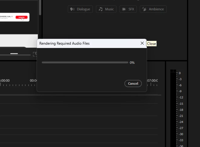

Never thought I'd see this problem again... But, here it is in version 25.1:
It stays like this for 2-3 minutes in a short 1 minute project for the social.

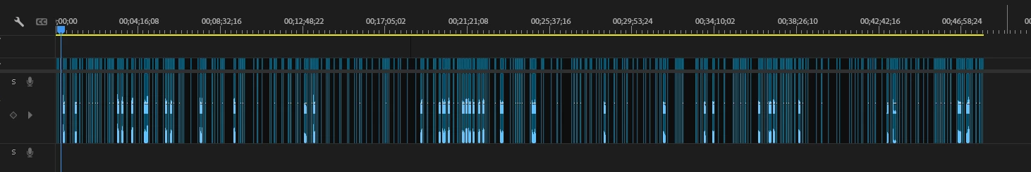

There's just these several mp3s and a voiceover done in Premiere pro, the yellowish one is a music track:
Haven't had a big project yet, so I'm within temptation of an hour wait...
It's a freshly installed Premiere Pro on a freshly installed Windows by the way.
