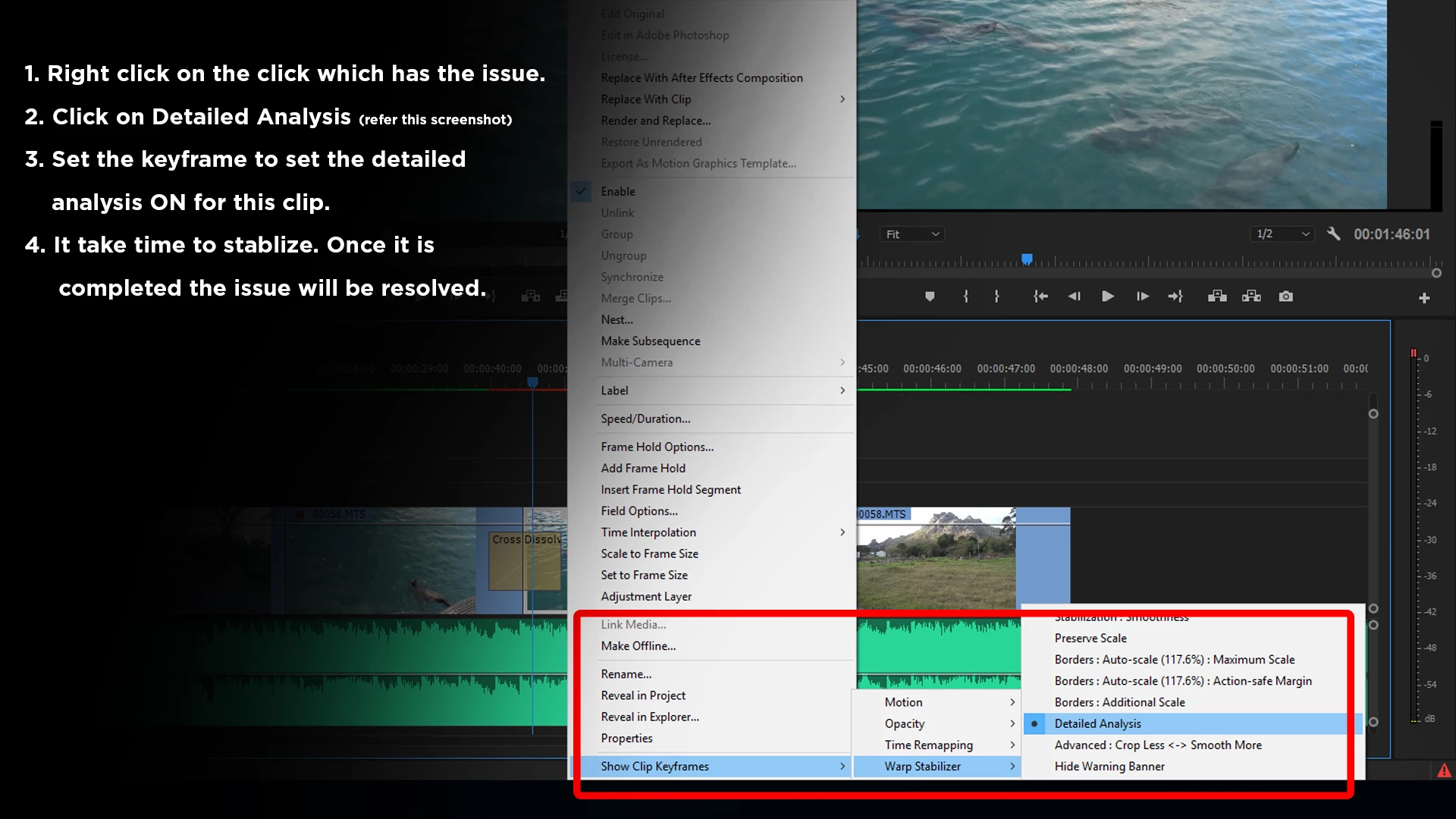

June 18, 2018
I ran into the same problem and the workarounds above did not work so I found another workaround.
The issue seems to be caused by clips of different dimensions where you have to nest. What I did is put the clip in a new sequence on its own and matched the sequence settings to the clip, ran the warp stabilizer, and exported the clip and re-imported the stabilized clip. I often find that life gets too complicated for premiere so this kind of helps it not have too many steps to work out.

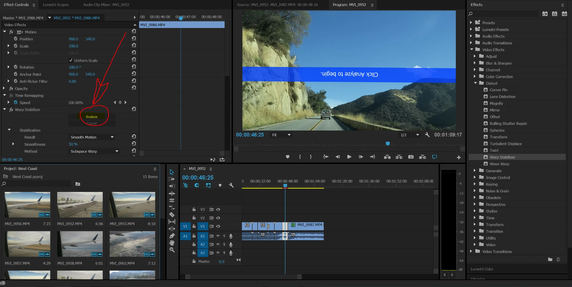

January 8, 2017
It did that because I rotated the video 180 degree (was shot with the camera inverted).
SomiddhoBosu
January 7, 2017
The <Analyze> button is in the "Effects Controls" screen.
January 8, 2017
Wow, is the "Click Analyze to begin" message upside down? Is it me or is Adobe not focusing enough on their core products? Premiere is LOADED with issues. I'm just back to Premiere after working for the last few years in FCP and I'm not impressed.
June 18, 2017
The clip has been rotated 180 degrees. Look in the motion properties. Not premiere.
