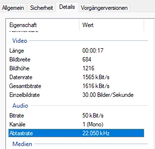

R Neil Haugen
June 24, 2024
That looks like you have an issue with the frequency of the file ... that is pretty low at 22Khz. If you changed that so that it was 44.1 Khz or 48Khz, it would probably work fine.

The problem happens when there is a mp4 file with mono audio. In my case they are usually from Instagram, but I think I also had another situation. The audio sounds deeper, slowed and barely understandable.
