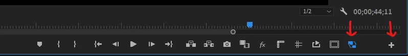

    Is this media from a phone, by chance? If so, you may be seeing some symptoms of Variable Framerate. I've seen that type of skipping before with the combination of VFR and interframe media from phones. If it sounds like that could be your issue, you can learn more about VFR here: https://community.adobe.com/t5/premiere-pro/faq-how-to-work-with-variable-frame-rate-vfr-media-in-premiere-pro/td-p/10348229?page=1
    I also wanted to add that - if it's not VFR-related - you may benefit from transcoding the media into a better format prior to editing, or even just make proxies of it. With the clip you're having trouble with you can right click, Reveal in Project, then in the Project Panel right click, Proxy>Create Proxies... And I tend to use the ProRes Proxy preset. It's an intraframe codec (better for editing, easier on your CPU). You'll need to make sure you toggle proxies on (By hitting the plus sign in the Program Monitor you can add the toggle for proxies to your list of buttons beneath your Program Monitor. Pic attached.) When you go to export, the proxies are turned off and the original media is exported.
