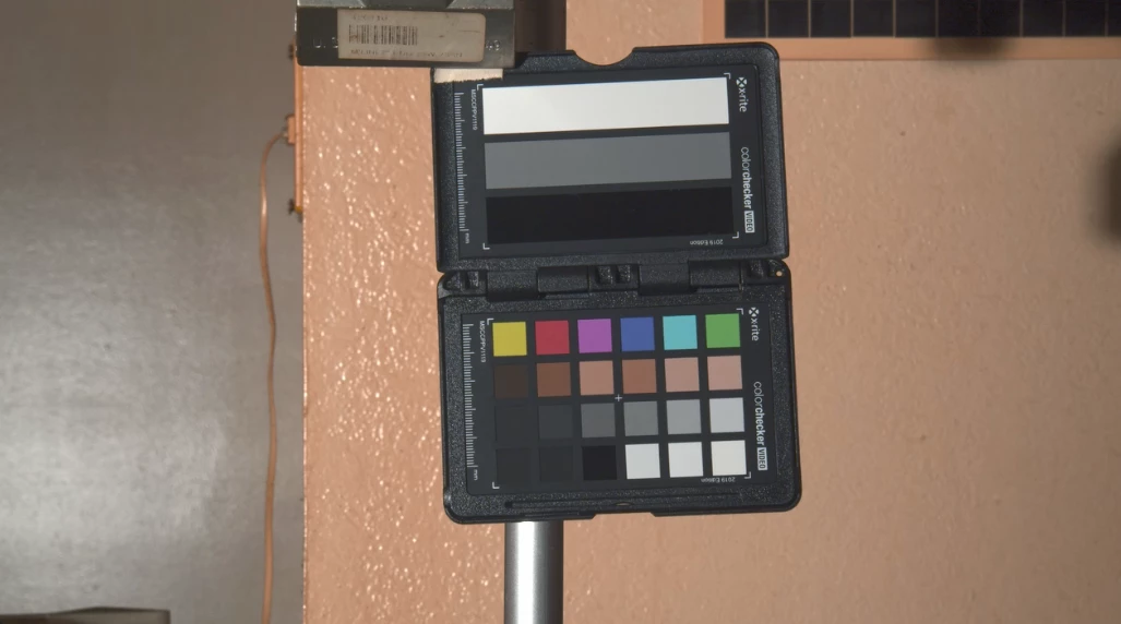

I just ordered an x rite color checker passport video from B&H, Been watching some youtube videos to try and get a heads up on how to use with resolve 15 cause I only have CS6 creative suite ( very old ).
Is there a way to use the chart with Lumetri ( with masks etc. ) to do auto correction like fcp and resolve?
Like, you tell it the source color space and timeline space and export space and do an auto correction ?

I'm curious... you say you made mask around chart and did auto color in basic tab... but I have questions.
I used a Lowel DP light ( tungsten ), 1k watt, 32k color temp.. and shot it with bmpcc braw 4k.
Then used the mask thing here and it came out pretty good.

August 14, 2020
got the chart late yesterday, shot it, stuck it in resolve, used the x rite color mask on it, and it came out really good with the auto 'match' feature. Then messed around with back wall a little cause it's ugly ( desaturated it a hair ). I'm happy with it.
R Neil Haugen
August 14, 2020
In Premiere, they don't have an auto-recognize feature, however as I noted ... just make a rectangular mask around the chart, then hit the 'auto' button in the Basic tab, and it does a pretty decent job of getting to 'neutral'.

August 7, 2020
Salvo ...
Just tested using a mask on a clip to limit the viewed part to the Xrite video color-checker, then hit the "Auto" button in Lumetri's Basic tab. It actually did a pretty good job for an 'auto' setting for white balance, white/black and contrast. I was surprised how tightly the color patches matched in hue vector to the appropriate Vectorscope boxes.
So ... it is useful in Premiere as-is, definitely.
