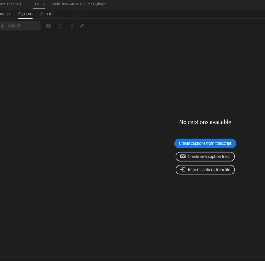

Not a problem! Thanks for getting back to me. The "Captions" and "Transcript" are technically loaded into one of my panels, since I'm using 3 screens, but they're inactive and not running at all. For good measure, I completely removed from from my panel and the problem still persists.

Thanks @Hung5E08, any chance you have the captions panel open, or is transcription running in the background?

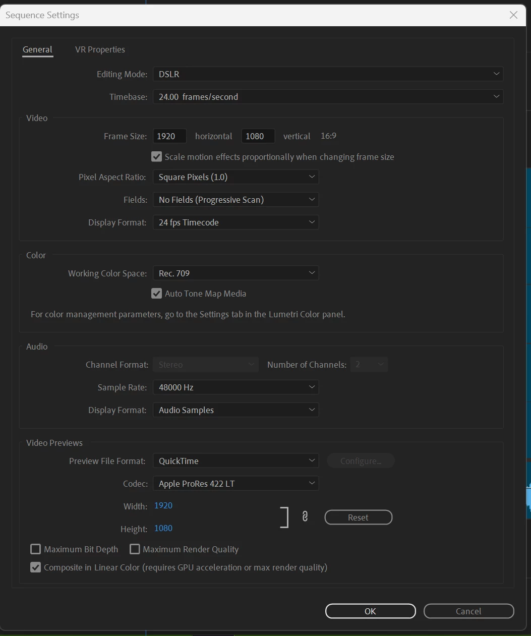

Hey Todd,
Thank you for the response!
- I'm on Windows 11
- I posted details of my current timeline in a screenshot. It's the same settings for all my projects
- For this highlight project I'm working on, all sequences within the project have the frozen timeline indicator
- I opened a few others projects that I worked on a few weeks ago, and got mixed results. Some projects will only have smooth playback with current indicator on smaller sequences, under 5 mins and little videos on the timeline. Another project has extremely laggy timeline indicator, but not completely frozen like I'm currently experiencing. Overall, this issue seems to affect a majority of the stuff I'm working on.
- My media formats are almost all ProRes 422, with some ProRes Proxy and H264 files mixed in. H264 files that I don't convert tend to be smaller and straight from camera, so they're not problematic.

Hi @Hung5E08,
What OS are you using, what are the sequence settings, does this happen with any sequence, with any project? or is this more specific?  What are the media formats you are using?
