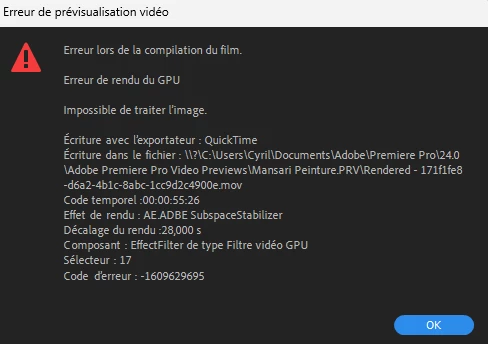

Erreur de compilation avec l'effet "Stabilisation"
Bonjour,
Je travaille sur Premiere Pro, est il m'arrive d'utiliser l'effet "stabilisation" natif au programme. J'utilise à la fois Premiere Pro 24 et 25, et j'ai un bug qui m'apparaît à CHAQUE FOIS que je fais un export et que j'ai utilisé l'effet stabilisation, et je n'ai aucune idée de comment le régler.
Je vous mets ici en pièce jointe mon "erreur de compilation de film", si quelqu'un a des pistes ou que je dois donner plus d'informations pour le comprendre, c'est très volontiers, car ça commence violemment à m'irriter 😕😕 Je vous remercie d'avance

Hi @Cyrille Fragni�re - Are you using the game driver or the studio driver for your 4080 Super?  If you open the Nvidia Control panel it should tell you.
That error is Premiere telling you that you are running out of VRAM. This page explains how the effects order in Premiere is worked out. (an article from the makers of Neat Video)
I would recommend following the order of effects in this article and then let us know if that helps.

- I have the same issue on two different projects in Premiere 24 and 25. I'm not switching between, otherwise the different projects (like the one on 24) won't work with 25.
- Adjustment layer : Just another one "Lumetri" but not on every rushes. And for "stabilization", it's on 80-90% of rushes, but just some of them make the bug report happen
- Plugin : No Plugin
- In a project : I could render properly IF i deleted the adjustement layer "Stabilization" in every rushes that made trouble and ended with Bug Report (I had some rushes with stabilization that didn't make a Bug report, I let them, and some rushes did, so I deleted the layer). 20 rushes had stabilization on and it made no trouble for the final render. Very strange...
- Works if switching Renderer to Mercury Playback Engine Software Only. It render properly... Thank for that. But it takes 4-5x times more time than ever, it slows my workflow. Every layer I put on a rushe (Like "Lumetri"), it makes the timeline red and need to "pre-render" to see it properly in preview. Final Render with it = 9 min. Before, just 2 min. Why it is like that, I loved the set up before.. ?

  • Actual result -  Made a lot of bug report, but in some rushes indepently (make a bug in 00:16 for the "AE.ADBE SubspaceStabilization", I deleted this part, so make a bug in 00:56 for the "AE.ADBE SubspaceStabilization", I deleted this part, so make a bug in 01:34 for the "AE.ADBE SubspaceStabilization", so on... Till I can make a proper render, but with somes rushes not entirely stabilizated

We're sorry about the error. Please let us know more about the system specs (CPU, GPU & RAM). Also, for testing purposes, have you tried switching Renderer to Mercury Playback Engine Software Only to check if it's rendering properly?
