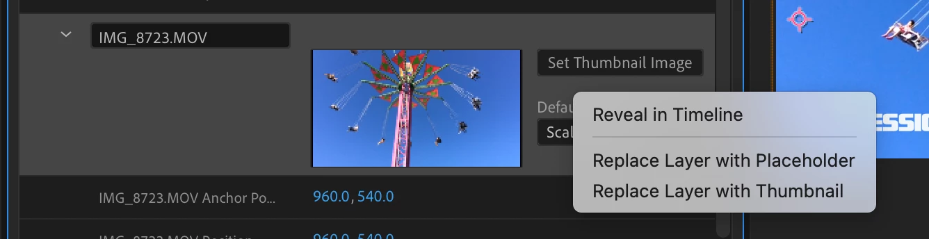

  • Last option... is you can right-click on the MR Control in the EGP in AE and you will get the option to replace a video with a thumbnail or Adobe's default thumbnail.
    •  this will ensure that you don't bloat your mogrt with a video that takes up a lot of memory.
