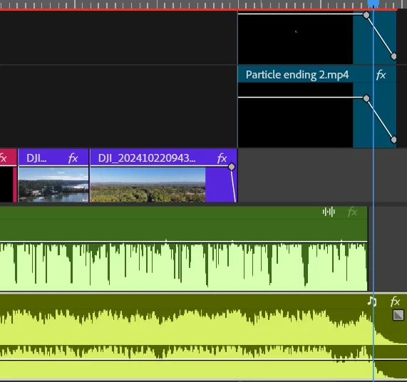

  1. Issue one: I have the last heavy note of my audio tracked lined up with the end of the voiceover (see attached image). However, when I export it, the music track ends 4 seconds earlier than where it is supposed to. This is a huge difference. I did use the Remix Tool to change the length of the track, which I have in every video I have made in the last year or so. I have  never experienced this.

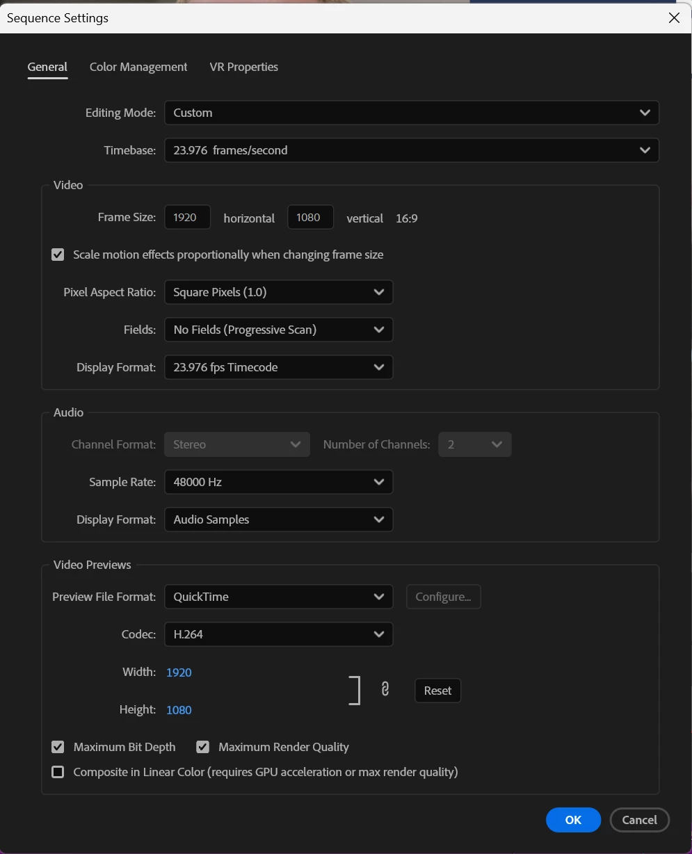

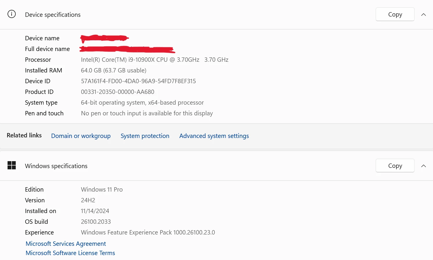

I'm really not sure if these are related and what caused them. I have never seen this before. Unfortunetly I'm on a PC for these projects. I have attached screenshots with my PC info, Pr version, and my sequence settings in case I'm missing something.
