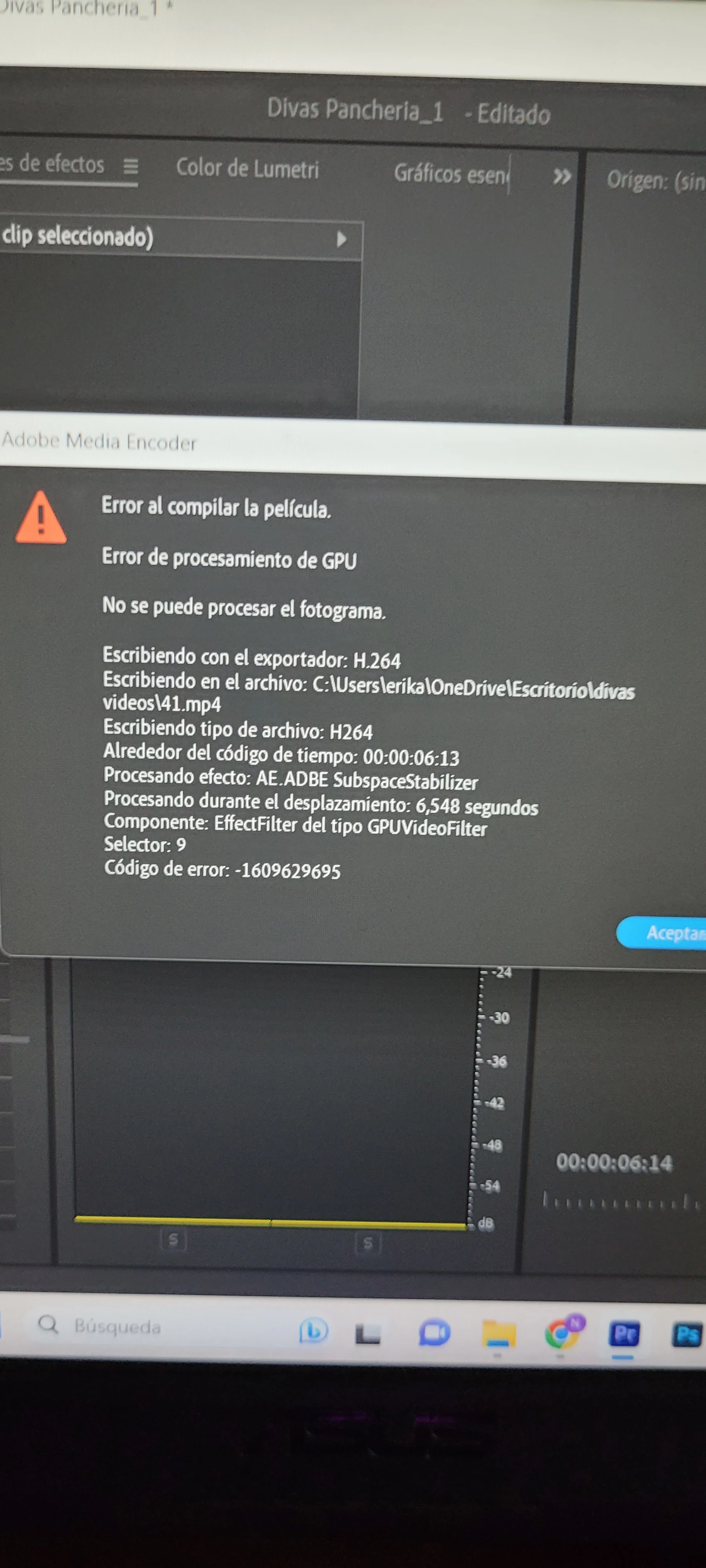

May 21, 2023
Hola! Uso pr 2023, instale la version 2022 y tengo el mismo problema, hace un mes que no puedo trabajar. Encontraste la solucion?
China
Hello! I use pr 2023, I installed version 2022 and I have the same problem, I haven't been able to work for a month. Did you find the solution?
  • Ty Chini
Kevin J. Monahan Jr.
May 22, 2023
HI Erika,
I received your message and it looks like you have an unknown error for exporting footage. Is that right? Check the Warp Stabilizer effect at 6:13 in the Timeline. If you remove it, can you export then? Let us know. You may need to adjust the effect, shorten the clip, or work around the issue in another way. I hope the advice helps.
Kevin
