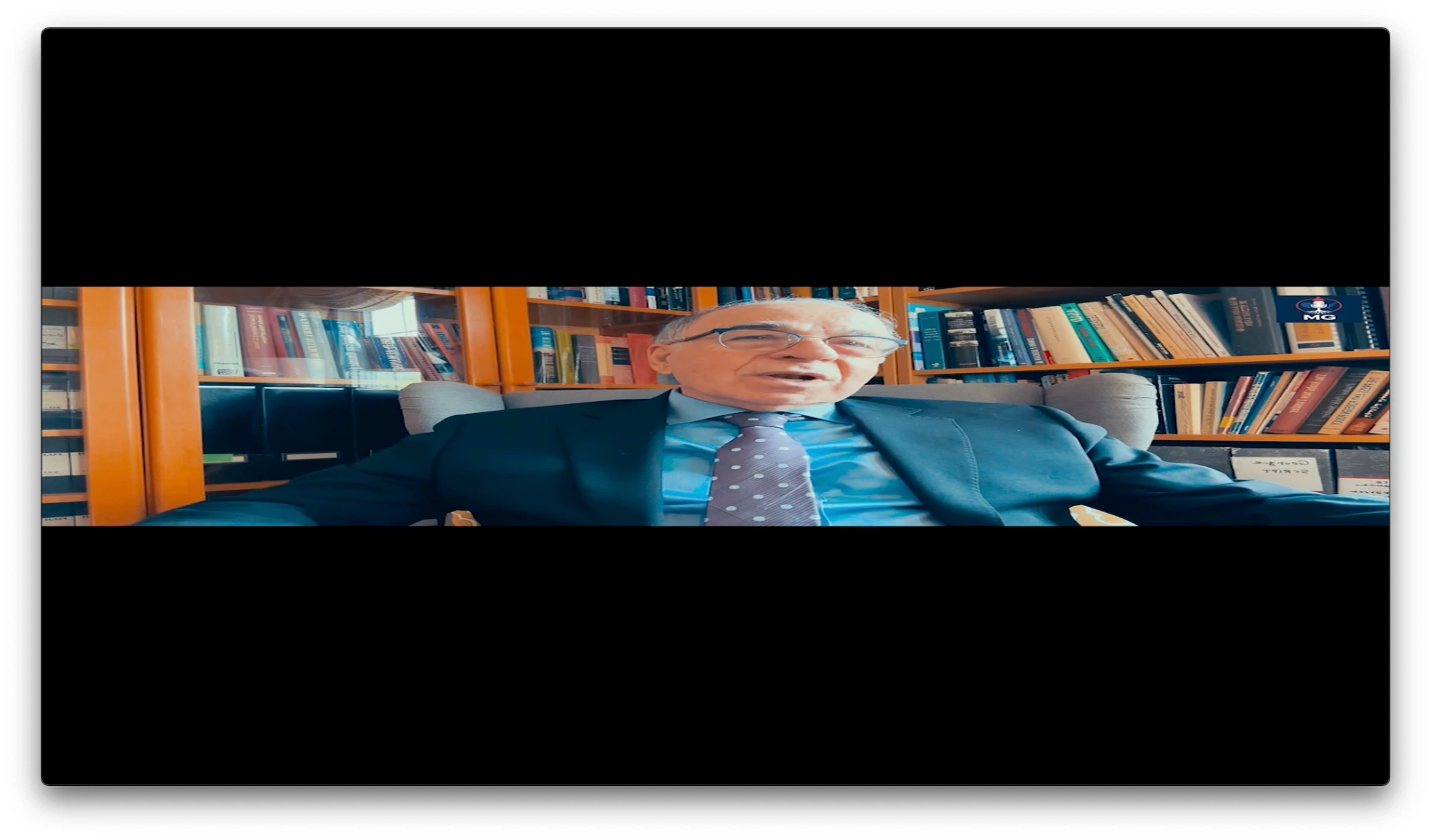

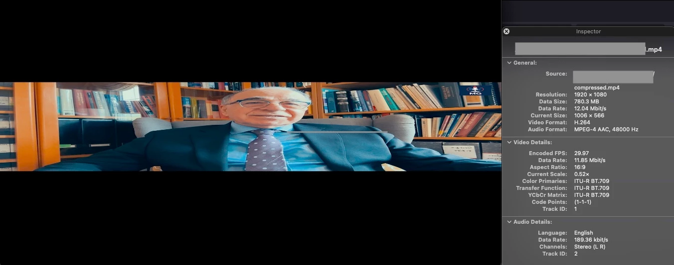

After a batch export to H264 using Media Encoder, the video result is distorted, compressed, squeezed),
the frame size is indeed 1920 X 1080 but the content is not! it is scaled down on the Y axe, (please see pict.)
This happened a couple of time so far, any explanation please? is this a bug?

May 5, 2025
Simply restarted premiere. did NOT clean any cash or preference.
Worth maybe mentioning, there were 3 sequences in the batch export in Media Encoder,
only one was distorted, the rest were good.
Also this distortion did NOT happen to the same sequence, but it happened to random ones.

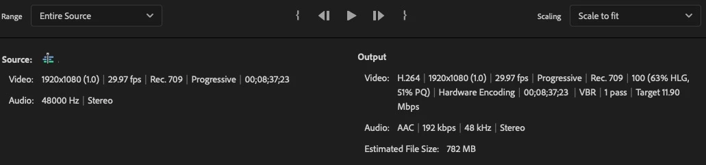

Thx Rach for your reply...
I cant upload the video for copyright issue and for it is +750Mb.
Attached are the render settings. Using these SAME settings, I exported again and the output is good!

Hi @JM VOA,
Thanks for the message. Welcome to the forums. From the image, it looks incorrect.  Can you send your sequence and export settings to see if anything strange is happening there?  If you have time, please give the team a few more details.
