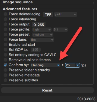

R Neil Haugen
October 25, 2023
That's in the Preferences/Settings window ... the little gear icon in the upper left corner. Rather well hidden ...

October 25, 2023
I am in shutter encoder now, uploaded my files. I am not seeing any option to "set frame rate mode" as it looks in the screen shot you sent.
