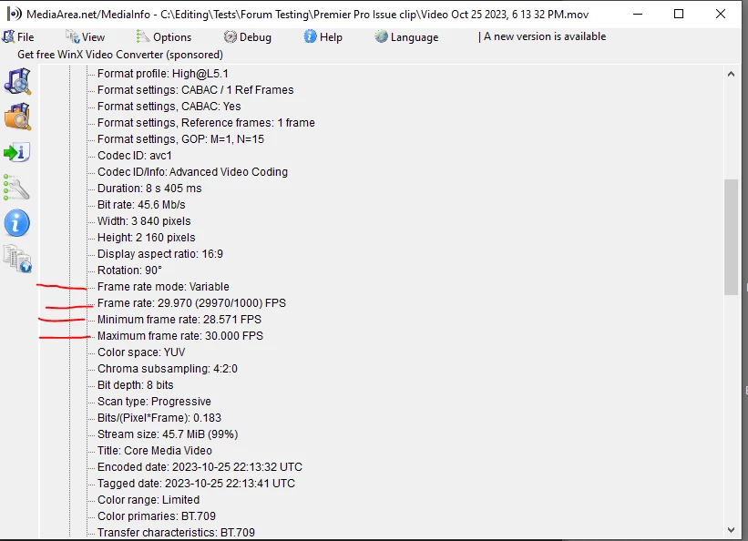

I just downloaded the clips, dropped them on MediaInfo icon ... and both still show as VFR clips. Basic framerate of 29.970, with range from 28.571 to 30.0 fps.

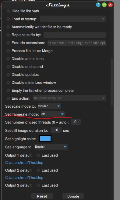

Apparently, the S-E people moved the option to change to CFR from the codec options (after you choose a codec) to the Preferences settings ... the one underlined with red below:
After setting that option to CFR, it actually produces CFR footage.
