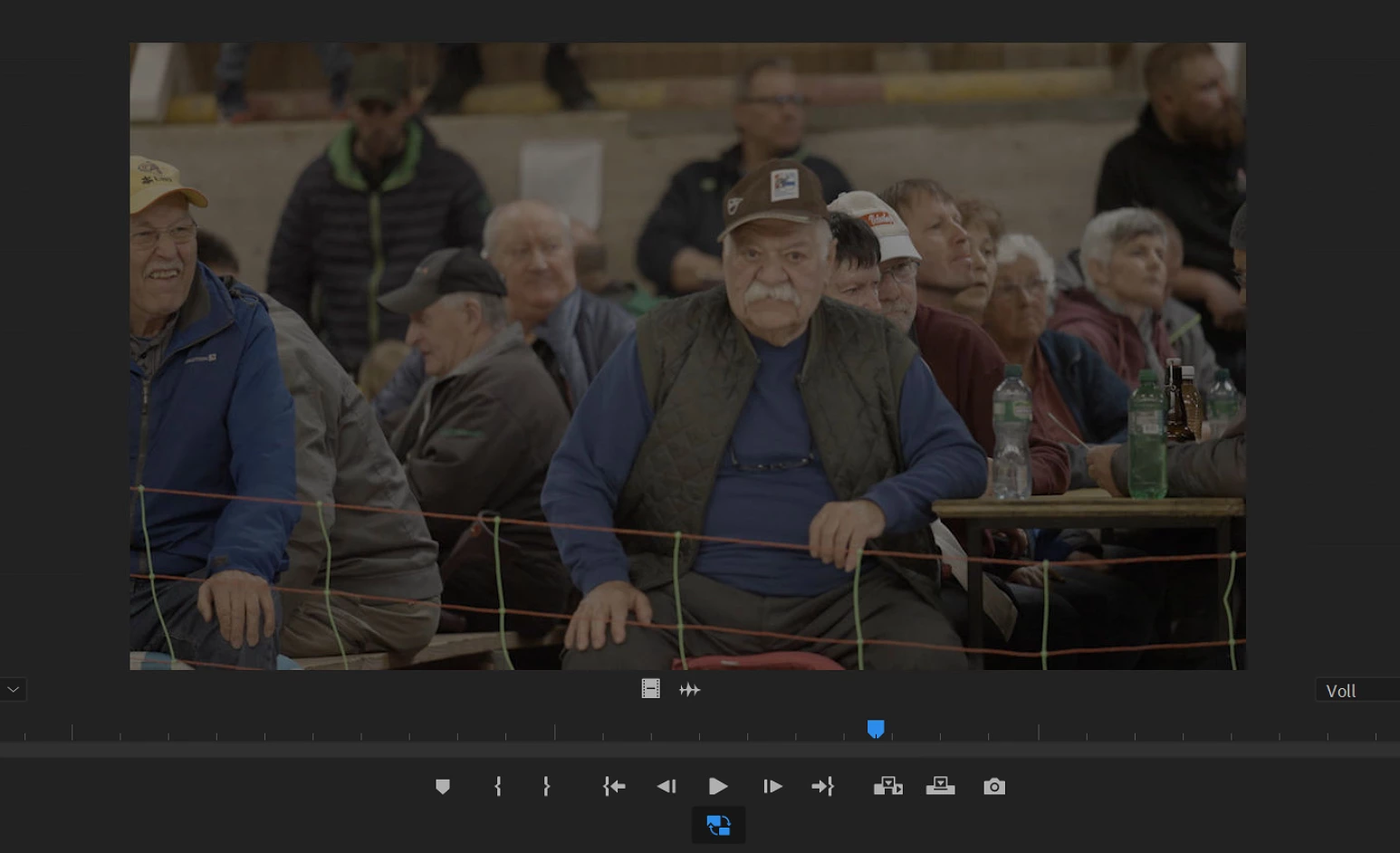

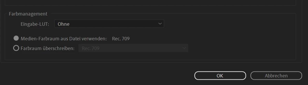

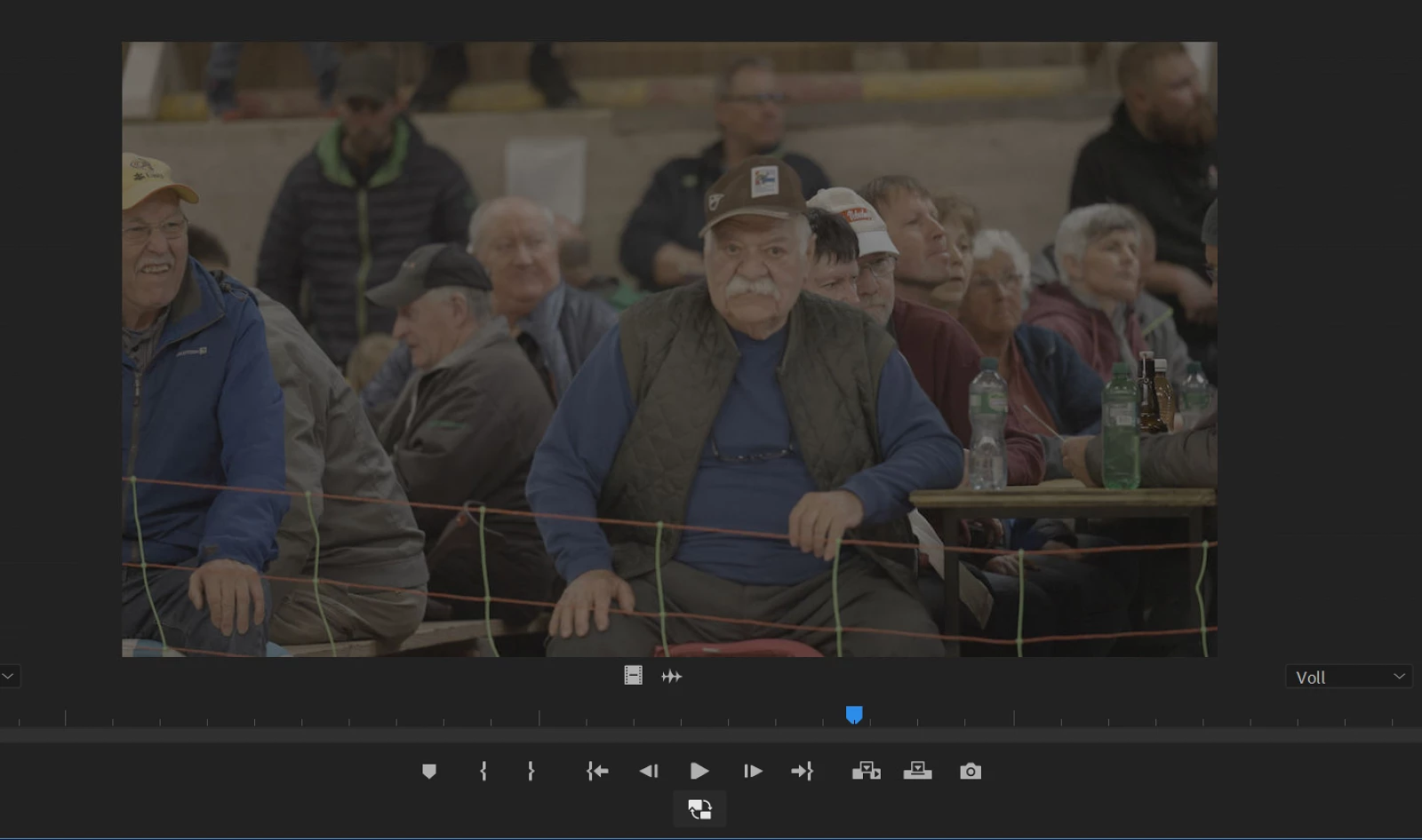

Stoeff Gerber
Mar 16, 2022 3:32 PM UTC
Hi There
Since the Update to 22.2, my Proxys from S-LOG 3 Footage are darker than the Original S-Log3 Footage.
Does anybody has the same issue?
I generate Proxys with Premieres default presets.
