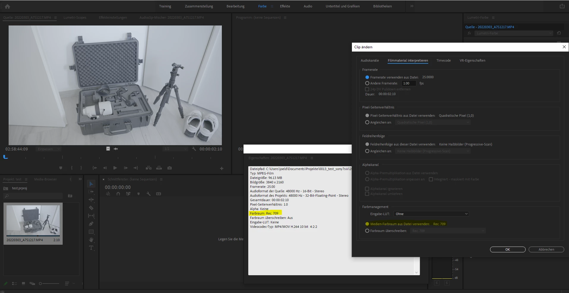

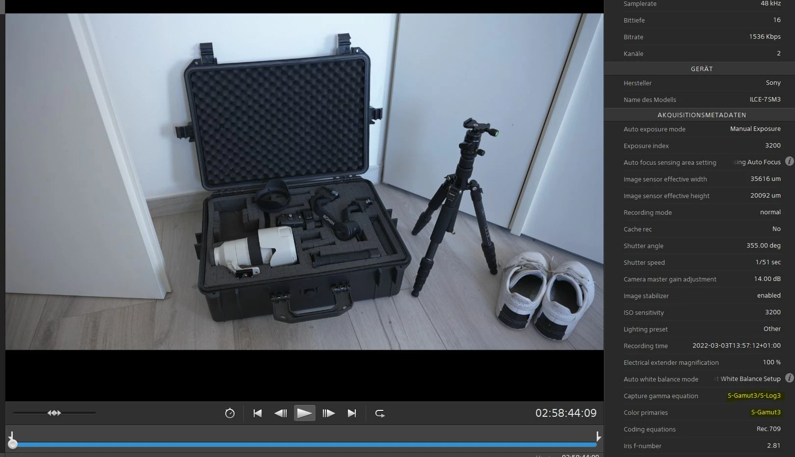

Mar 3, 2022 1:41 PM UTC
My problem is that the new Premiere Pro Version 22.2 doesn't recognize my clips as S-log3/S-Gamut3 color space.
So I can't transform it in Premiere Pro. Meanwhile, Catalyst Browse of Sony recognizes it. See Screenshots. What I'm doing worng?
R Neil Haugen
Mar 3, 2022 4:46 PM UTC
It is 'recognizing' it as Rec.709, and showing the log-encoded nature of the media. You'll need to do a normalization process manually probably for the first clip, and you can then save a preset or even LUT with that for further clips.
Apply the preset to the clips in the bin, bingo bango bongo done.
Neil
Everyone's mileage always varies ...
Aug 31, 2022 1:38 PM UTC
Neil, having same issue as issue as above with Sony a7s3 MP4 S-log3/S-Gamut3. Can you give further deatil on "normalization process manually probably for the first clip, and you can then save a preset or even LUT with that for further clips?"
thank you!

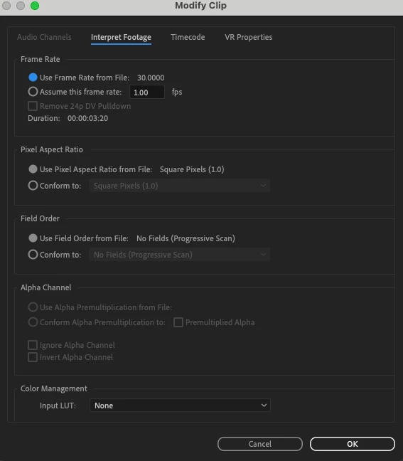

Mar 1, 2022 9:18 PM UTC
I need expert help, please...
I have read in great detail how to solve the color managment problem in v22; by changing to HLG in the sequence settings or by forcing the footage to Rec709 by using the interpret tool.
Some background. I started this project in v22 and have made ZERO updates during such time. Over the past 4 weeks I assembly edited (15) 20 min sequences shot on 2 Sony FX9s.  Everything was seemles and I was unaware of the new color managment. I finished the edit and the color correction using Lumetri.  Everything was fine and looked fantastic.  THEN...I opened up the project and evrything is BLOWN OUT.  I have read how v22 has been changed, the problem is I made no changes or updates. All of a sudden this happened.After hours on the phone with Adobe techs they are no closer to finiding a solution for why this all of a suddend happened. After 2 days of trying to fix the problem, then Premiere reverted back to the 709, today I opend the project and it's blown out again...it keeps switching back and forth and I don't know how to finish the project?
Second problem, I can not interpret the S-Log footage and force to Rec709 using the modify and interpret dialog box.  I originally created merged clips with the sound mix team. This greys out that modify feature . Is there a fix or workaround for that?
I'm at a loss on how to proceed, I cannot even give to the client for review the way it looks. Do I just XML and finish color in another program (losing weeks of work) or Do I overcut my edits with the original footage as to allow me to use the interpret feature that is currently greyed out?

charlottec59583283
Jan 11, 2022 2:29 PM UTC
 Why doesn't my version of Premiere 22 have this option?
R Neil Haugen
Jan 11, 2022 5:11 PM UTC
Which version of Premiere? 22.0. ...? .... what?
Neil
charlottec59583283
Jan 11, 2022 5:28 PM UTC
I'm running PP v 22.1.2 showing up-to-date on CC
