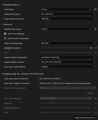

The problem I have is I’m editing HDR on an SDR monitor and my edit timelines are all different, I have screenshots to send you to show you what I mean, but I will try to explain. Please see the 4 different devices I filmed on.
  1. DJI Action 4 in SDR = Timeline is Rec 709 and all good
  2. Drone (DJI) in HDR = Timeline is Rec 2100 HLG, Display colour management on, Extended dynamic range monitoring on, colour setup is Direct HLG, output colour space Rec 2100 HLG, yet the footage is blown out on screen.
  3. Phone, Google pixel in HDR = Timeline is Rec 2100 HLG, Display colour management on, Extended dynamic range monitoring on, colour setup is Direct HLG, output colour space Rec 2100 HLG, yet the footage is blown out on screen.
  4. Sony Z90 HDR = Timeline is Rec 2100 HLG, Display colour management on, Extended dynamic range monitoring on, colour setup is Direct HLG, output colour space Rec 2100 HLG, the footage looks great on screen.
All four timelines will be merged to make a trailer, I have exported some blown out clips and once played after export, they play great on an HDR TV/Device, can you help please?

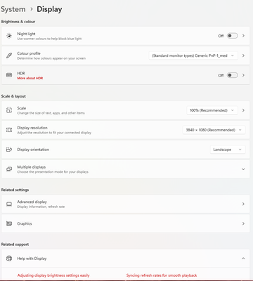

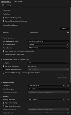

You don't mention two things:
Is the monitor and OS set to disply HDR? In Windows you typically go into monitor settings for that.
And is auto detect log and auto tonemapping both on?

Where do I find the auto detect log & auto tonemapping pls
