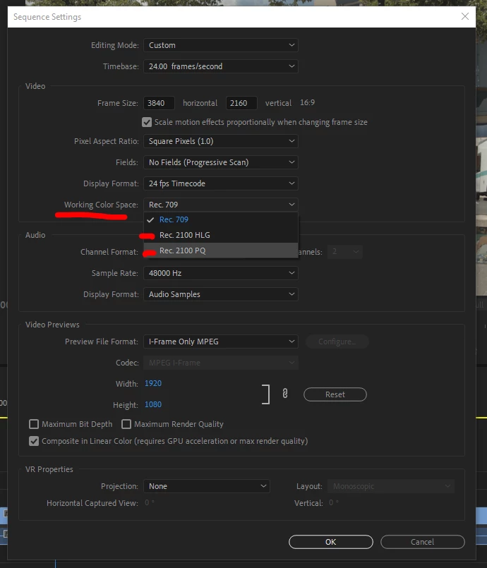

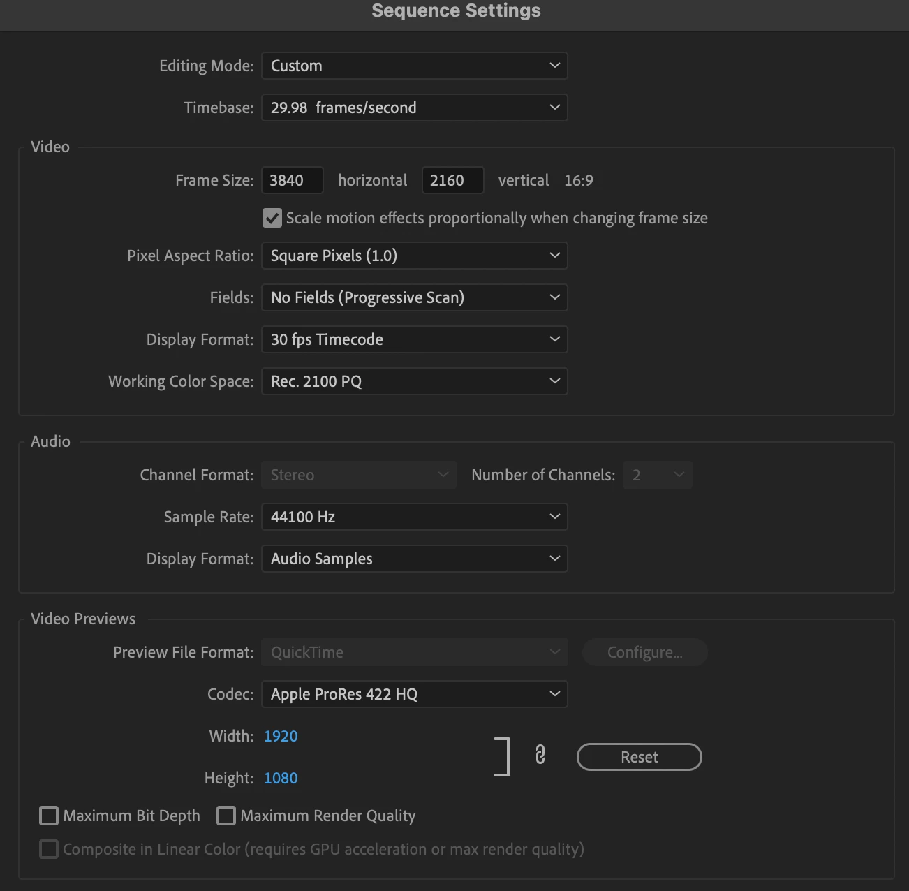

Media and Sequence Color Space Settings
In the fall 2020 release, they added color space settings at the bottom of the dialog panels for clips in a bin using the Modify/Interpret Footage. And also in the Video section of the Sequence dialog. Here's the Modify/Interpret Footage dialog:
There are now Rec.709, Rec. 2020, and Rec.2100PQ  and HLG, all in both 'normal' transforms and also Scene Referred (only, skipping the Display transform.) 
And the Sequence Settings dialog, showing the new Working Color Space options:
Use the new options above to properly tell Premiere how to 'view' your media, and your sequences. It will by default assume Rec.709, so it is up to the user to select the option if you are not working in Rec.709. Remember also to set the scopes for HDR color space as discussed below.

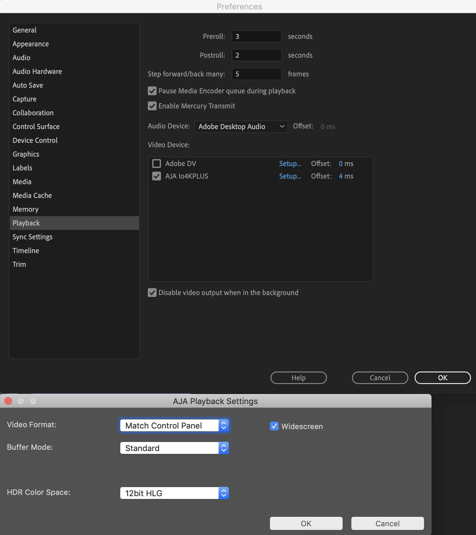

For AJA devices, it's still the following two pieces depending on whether you are on a Mac or a PC.
For the Mac OS, you must use either the io4K or io4K+ external box.
https://www.aja.com/products/io-4k
For the PC user, you must use either the AJA Kona 4 or Kona 5 PCIe internal card.
https://www.aja.com/products/kona-4
From the AJA devices, you must use an HDMI cable from the device to the HDR capable monitor. I don't know yet about connections from the BM devices to the monitor.
From the AJA or BlackMagic software controls, select the Premiere HDR signal.

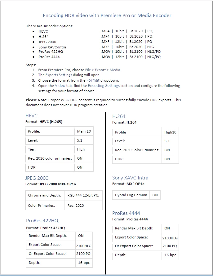

Exporting HDR Media from Premiere 2019
[Edit: 11 November 2020 changes not shown in chart!]
[There are PQ and HLG options more than shown in the following chart, and those will be added and the chart updated soon. This should still be enough information to get you to and through the options now available.]
For exporting in HDR, see the following chart.  The top part gives the basic data for the (24 March 2020) six export options. The items in the boxes in the lower section are options you need to select down in the Video tab on the right side of the Export Dialog box. The left box is the option to select, the right box is the value to use for that option.
To set some of the options in the Video tab, such as "Level", you may need to first uncheck the Level box. Then other options appear. As for example, the H.264 export. Down in the Video tab, uncheck "Profile", then from the drop-down select "High10". Make sure "Level" is set to at least 5.1.
After selecting High10, two options appear below ... "Rec.202 Color Primaries" and a grayed-out "High Dynamic Range". Select the "Rec.2020 Color Primaries" option and the High Dynamic Range box comes active and should also be selected.
The process is similar with the other three formats. Note, the XAVC option requires the selection of an XAVC-Intra option from the MXF-Op1a preset drop-down list.
There are five export possibilities in PQ, three in HLG. Four options are 10 bit, two are 12 bit.

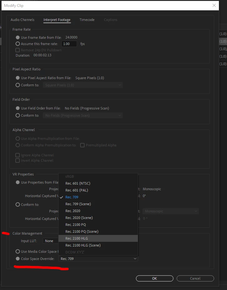

Trying to following this guide but I'm stuck at the first step.
The Color Grading tab is greyed out for me, cannot find a way to enable it like the following image
https://community.adobe.com/t5/image/serverpage/image-id/169446iE6EC6DADF3E0BF25/image-size/original?v=1.0&px=-1
I've tried this with different source files but no luck.
What is strange is that I can edit the tab and also see Lumetric Color HDR checkbox on a different machine with the same exact specs as mine (same HDR monitor, GPU, OS, Premiere version, setup - we are not using any external signal connecting gear).
Could somebody give me a push into the right direction?
What I want to do is convert and SDR video into HDR.
R Neil Haugen
March 23, 2021
That color management bit is only available at this time for RED and XDCAM media. Which is why it's grayed out for everything else.

Currently, sequences can have a working color space that includes several different versions of PQ and HLG, as they don't have any form of DolbyVision available. The scopes can be set to HDR, in several flavors.
Exports can be to HDR again in several flavors.
But you cannot correctly see the image inside Premiere outside of Rec.709 settings. So to see what you're working with, you must use the i/o device from BlackMagic or AJA to get the proper signal to your monitor.

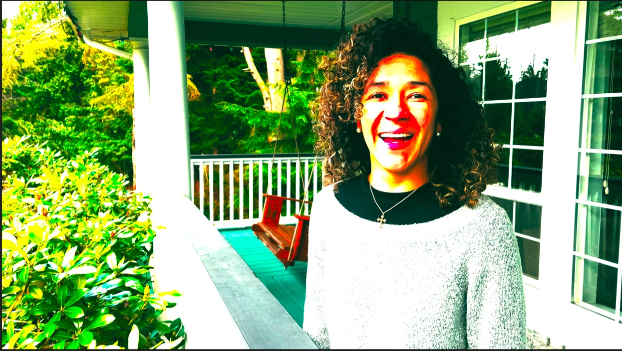

I have an issue related to this when exporting my media with HEVC format above.
Basically, it gets blown out @ export.
My goal is to take the original HDR media, edit, color, and deliver in compressed consumer format for youtube and wistia. I am flexible on the delivery as long as it looks 'good' on these platforms.
Can you help me here?
What other information can I provide for you?
Thanks for your contributions thus far. Super helpful.

Here is a screenshot ( I know it's not ideal) but may illustrate the problem better.
R Neil Haugen
January 29, 2021
What are the two screenshots from? Remember, Premiere's internal monitors cannot show HDR images. They clip out at around 102 IRE really. Up to now,  you have had to view the material either using an AJA or BlackMagic exterior device to send a 'raw' HDR signal to your HDR monitor.
Now, on Windows, you may be able to set Windows to it's HDR mode for a monitor, and use the Transmit Out from Premiere to see an HDR image on that monitor. I've tried that once, it was a bit odd to set up, but seemed to work. I think it was the Public Beta 14.9 though.
Neil
Everyone's mileage always varies ...

I understand about not seeing the material in HDR as I edit unless I have the proper setup.
The 1st screenshot is how the material looks in the premiere (not HDR) and the second is after I export it using the H.265 settings you posted above.
The only HDR screen I have is my iPhone 12 screen.
Please don't judge. lol.
All I am looking for at this point is to be able to shoot in HDR, do some basic adjustments in the premiere, and export in consumer format.
When I look at the H.265 rendered file on my iPhone 12 with the HDR screen am I seeing HDR?
If so, I would think it would look different than the clipped screenshot above (in my computer monitor).
I am looking at the Azus monitor suggested in this thread (understanding its limitations) and the AJA set up. Would this be enough to start seeing HDR as I edit?
Thank you.

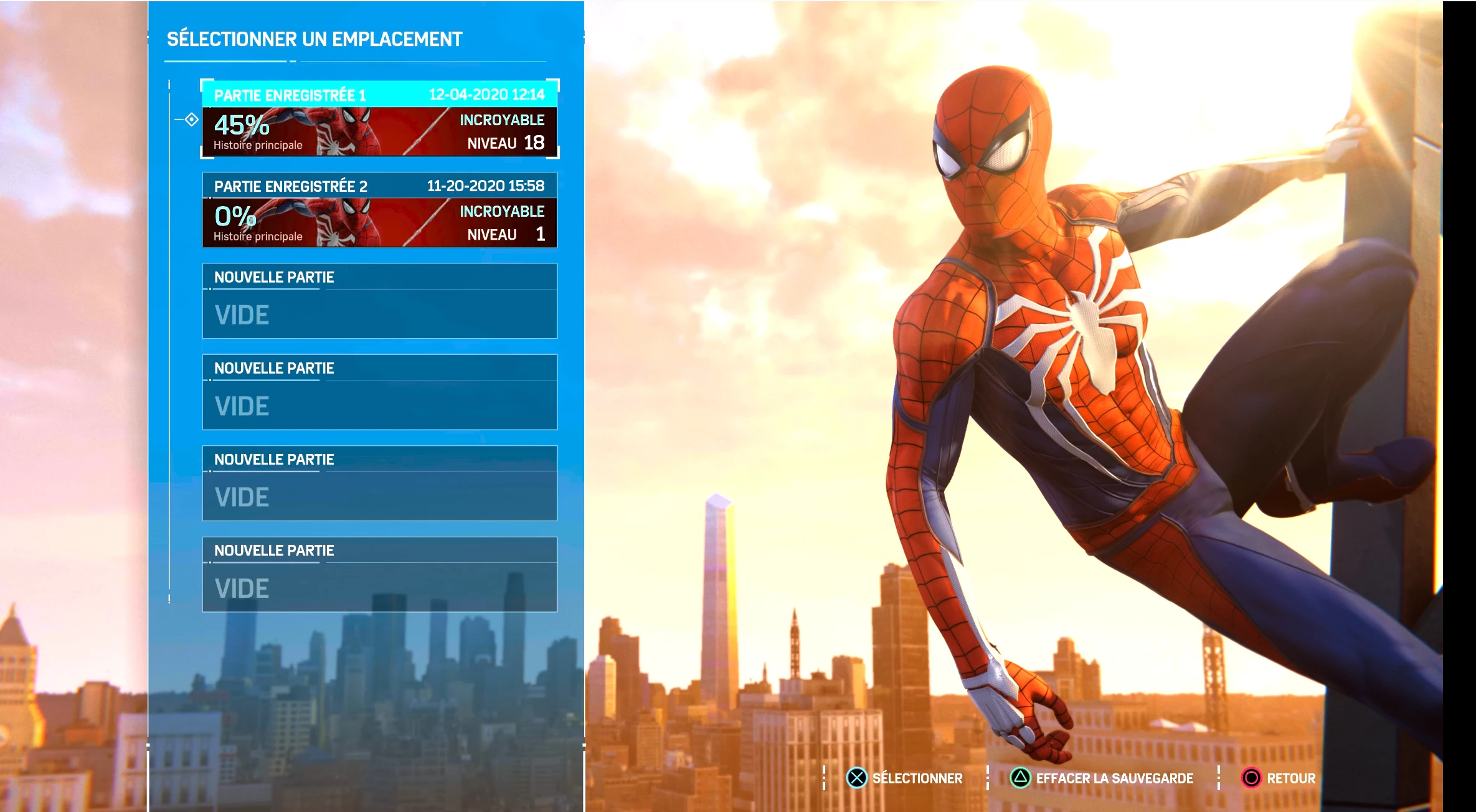

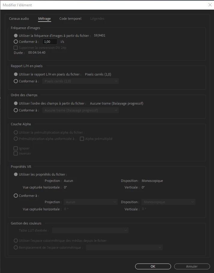

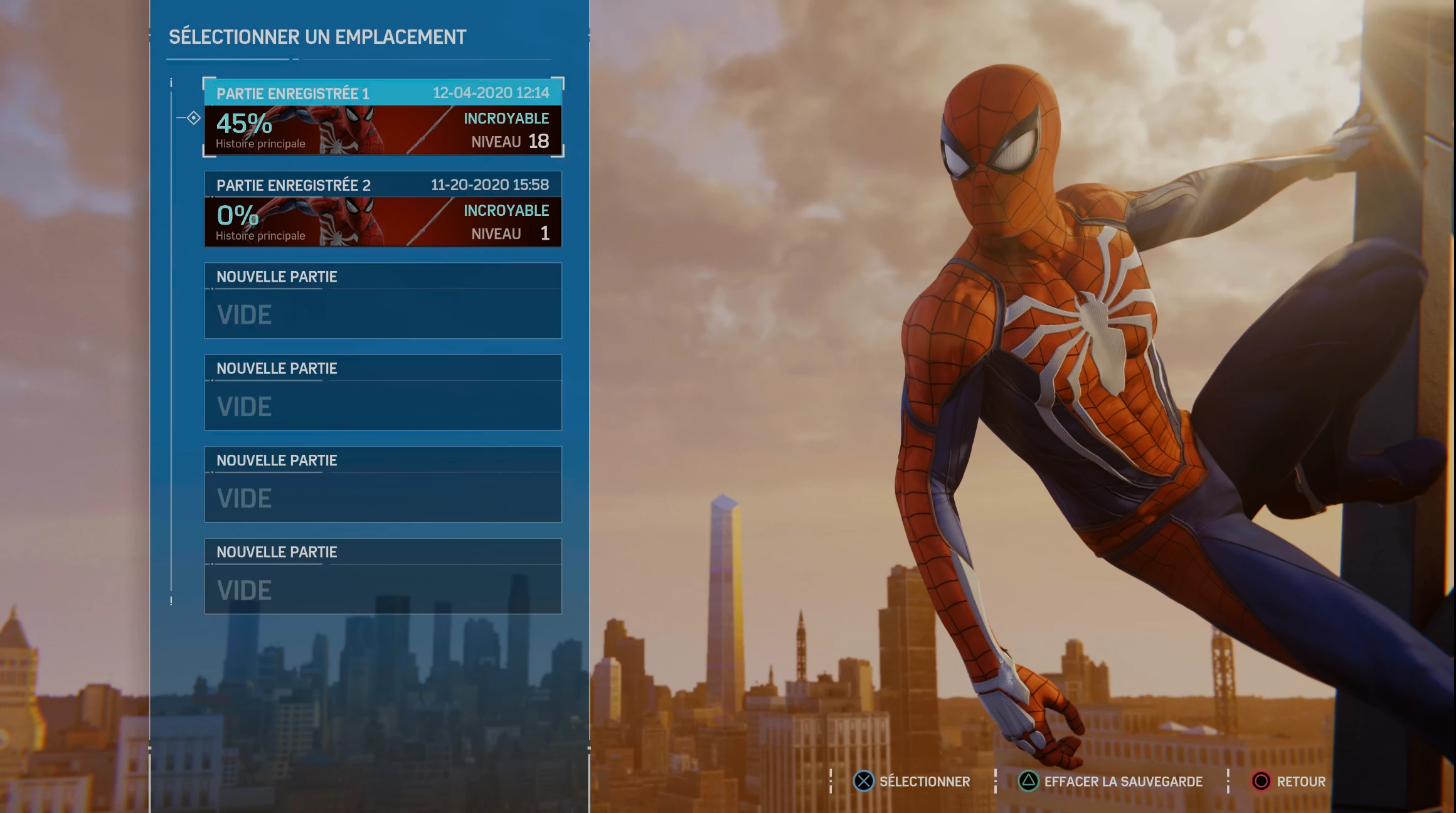

December 5, 2020
Salut,
J'ai un problème avec mon dossier
Lorsque je mets mes médias dans Adobe Premier Pro, j'ai ça, des couleurs de saturation
original
adobe premier pro définit par défaut
Je n'ai pas la possibilité de mettre en hdr. Avez-vous une solution?
R Neil Haugen
December 5, 2020
HDR is dynamic range .... not necessarily color space and especially not saturation. Though that is oft involved.
And I have no idea from your images what the file properties are, what the color space of the file is. It's the properties of the file that woud matter here. How was that created by the way? Screen capture?
And what is your OS? What is your color calibration for your monitor?
Neil

I have here an image of the Premiere and AJA settings used by Lars Borg, chief Adobe color scientist. I hope this is of help.
Neil
