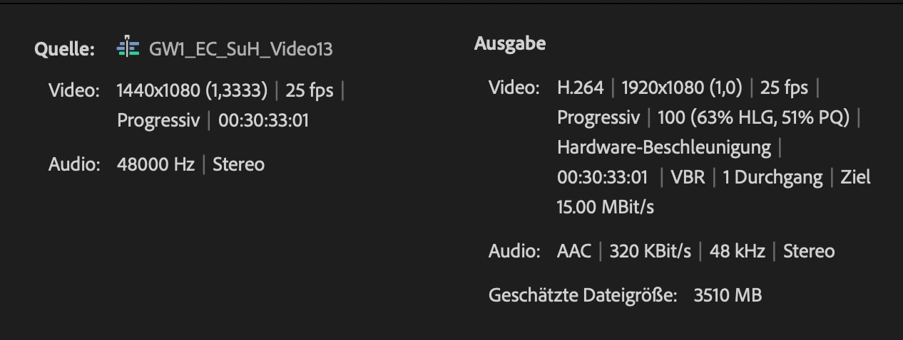

The problem does not occur with a specific project, but with several different video projects. I usually export my footage with the following settings:
High Quality 1080p HD

Are you using any effects?  Can you post a screenshot of your export settings?
