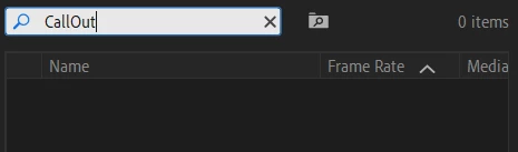

Filter Bin Content not working
Whenever I try and search something in my imported media box, nothing comes up. Has never happened before so Idk what's causing this/what happened.
I've looked through here adn the only "solution", or better said workaround is trying to duplicate my project.
Would that literally just be, go to where I have my PRPROJ file saved, copy it and open the copy??
Having to scour through 700 files just to get what you want is not really efficient.

Alright so this fixed it.
I found posts going as far back as 2017 with this same exact problem. Pretty crazy.
But it "fixed" it. Until it happens again that is.

I'm on version 24.0.3 so I don't even have that Search Panel thing.
I'd add more details but I really don't know what else I can say or show.
I could go to the tab where I imported media, type something and it would give me a match (or not) but now it ONLY gives me no matches, even if I write the name file word for word.
Never had to use another form of searching for a file cause this was always right there....faster and easier.
