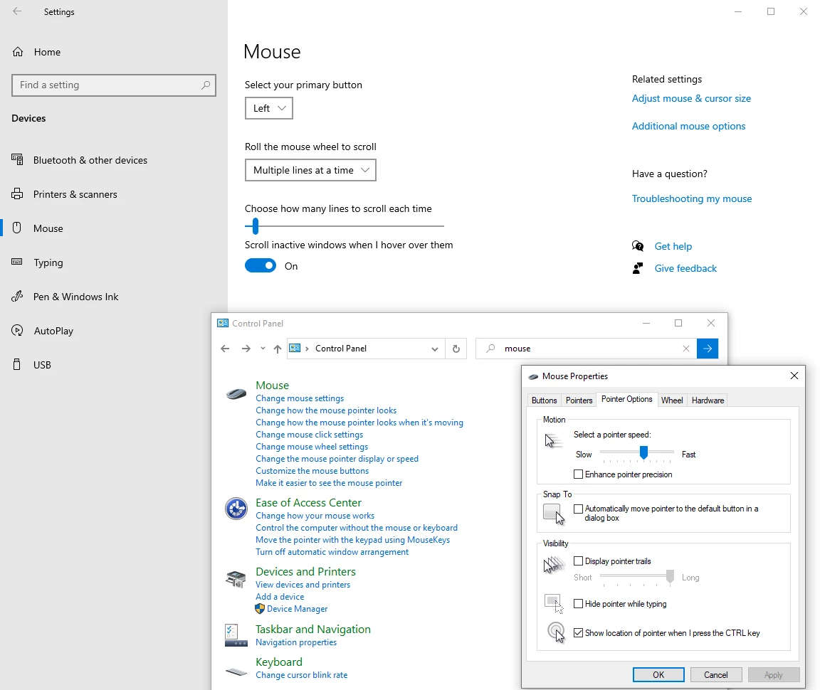

THERE IS A FIX FOR THIS.
In Windows, go to the control panel.
Go to "mouse"
Click "Additional mouse options" or "Change the mouse pointer display or speed."
The "Select a pointer speed" value must be on the 7th notch or higher.
I also recommend turning "Enhance pointer precision" OFF.
See the attached .png.
However, if your cursor is now moving too fast for you, this means that you need a mouse that can independently adjust its own "sensitivity" or "dpi."
If you love your existing mouse and don't want to get a new one, then you can use the linked AHK script at the bottom of this post.
Go to "mouse"
