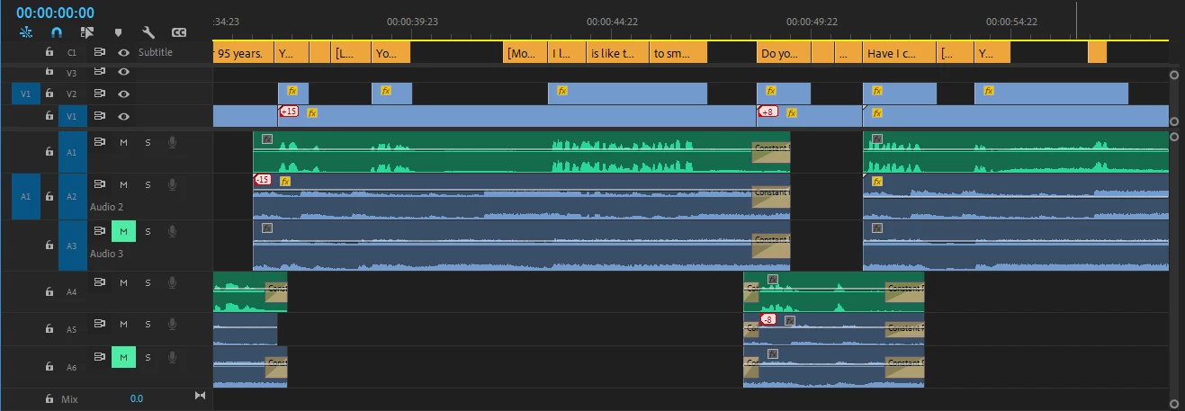

Hello all! This is my first post here on the forum, as I've tried to find a solution online but am at a complete loss.
I'm video editor working on social media clips for a stand-up comedian. I primarily edit 1-2 min crowdwork videos on my home computer (a custom-built PC), then once a week I transfer the sequences to an external hard drive, then over to my client's computer (a Mac) for final touches and posting.
My process has been as follows:
File > Project Manager > Collect Files and Copy to a New Location > Then I'll save it to my harddrive, and download it onto the Mac.
However, occasionally when I view the sequences on the Mac, some of the audio and video is out of sync. Not just out of sync, every single Clip is playing the same segment of the source video: the very beginning. Every one of the affected Clips has the little white triangle in the corner, indicating the start-point, and the red numbers indicating the video is out of sync with its linked audio. [In the attached image, it is only effecting V1 and A2/A5, all from the same source]
I've tried making the clips offline, and re-linking them, but to no avail. I can't seem to find anyone else discussing the problem, and I'm not sure if it's a Bug or an issue with my export or project manager settings.
I'd love some help, if anybody knows anything, please help!
Jun 6, 2023 10:25 PM UTC
Brief Addendum: Although this problem doesn't occur when I load up the project on my home computer, if I make the clips offline and relink them, it happens here too...
