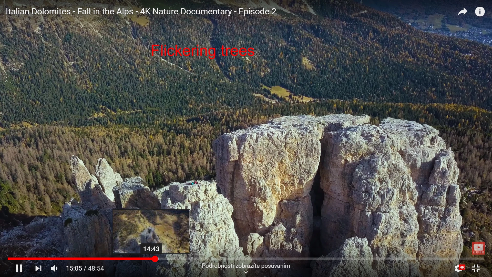

    I have simillar qestion.
    WHY 4K video flickering? First of all on forest with many trees or gravel rocks panning?
    Example Italian Dolomites - Fall in the Alps - 4K Nature Documentary - Episode 2 - YouTube     from 15 minute
    I have spend many many hours with 25 to 50 or 60 FPS decoding. Also Flicker removal, field order anti flicker, lot off plugins like  deflicker,auto levels, video moire,...I have 3 types 4 K not professional video kameras.
    Only one help but contraproduktive - desharpen video -10 or -20.
    I think it, is done by camera senzor. Probably it is video moire.What can I do with this? I have lot of nature videos.

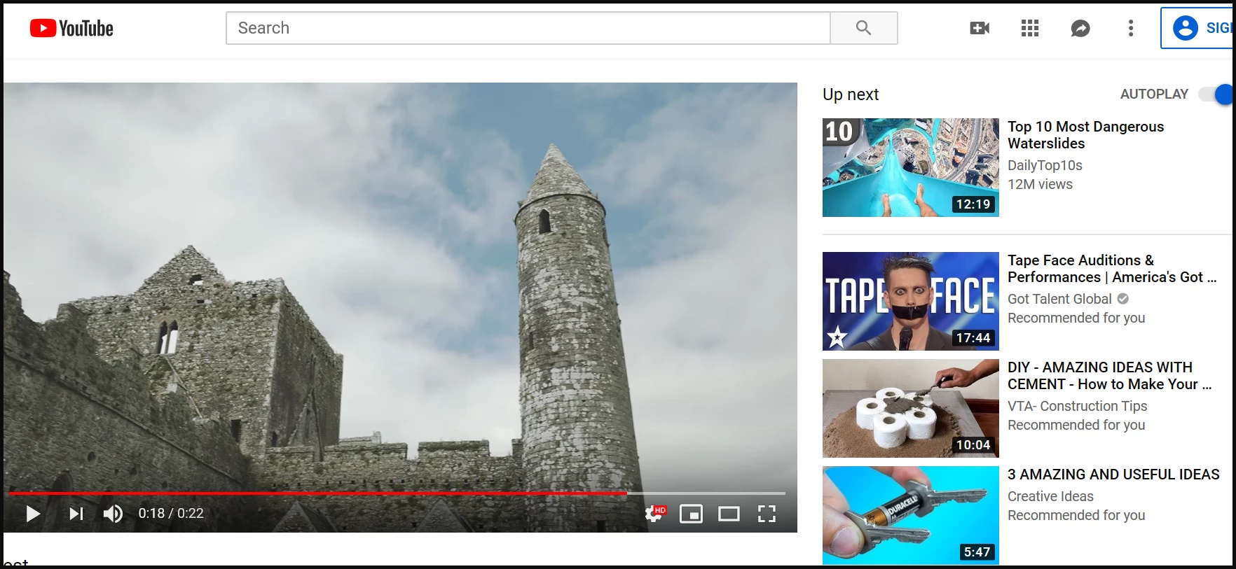

    July 13, 2019
    on my computer (laptop with internet that is not very fast ) it looks fine.  I don't see choppy stuff or lag or nothin.
    Movement is movement.. it is what it is … but in your case ( your sample) I'm focused on going up to see bird landing on building and back down to seeing some people or stuff on ground to right of tower. I am NOT looking at the tower but what you are 'directing' my attention to' … so who cares about every frame not being perfectly IN FOCUS etc.. it's the nature of the movement.
    When I watch in my usual way ( see image ) it's great. If I go to FULL SCREEN it gets a bit more blurry... ( I have full HD monitor on laptop). I still think its fine.
    You are over thinking it in my opinion...  focus more on the static shots that make your story come to life.

    July 13, 2019
    rodneyb56060189​, Strange you don't see anything. I fid it really noticeable and thought the footage may be unusable. When you pause it looks fine. You can really see what I'mtalikng about when I pan back in the double window just below the apex. It almost seems like it's vibrating.
