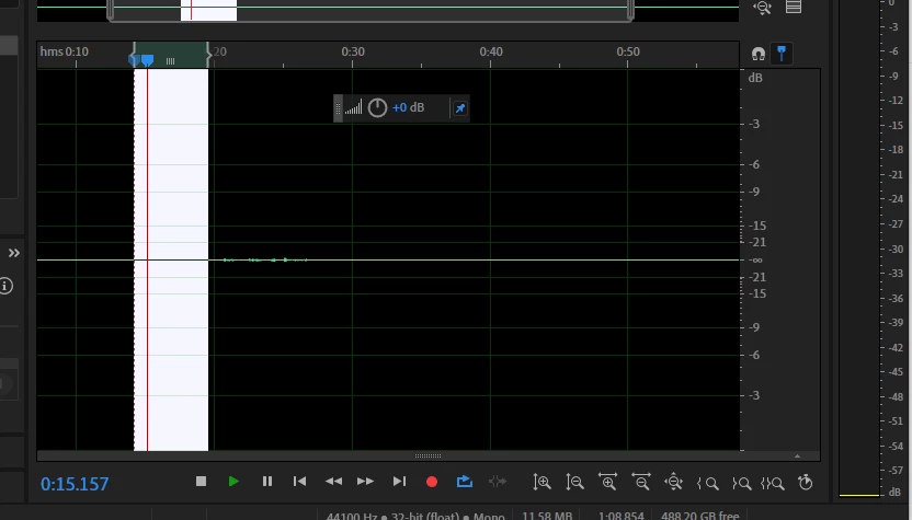

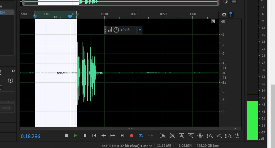

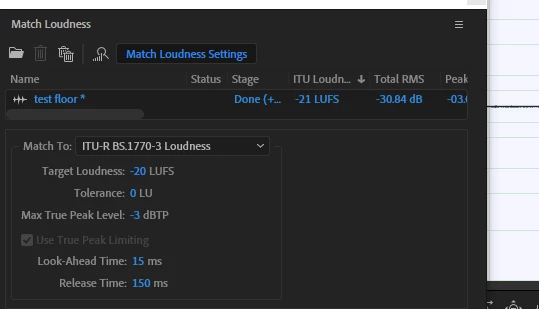

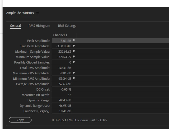

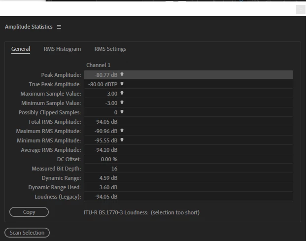

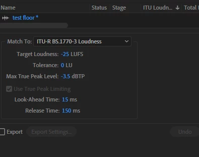

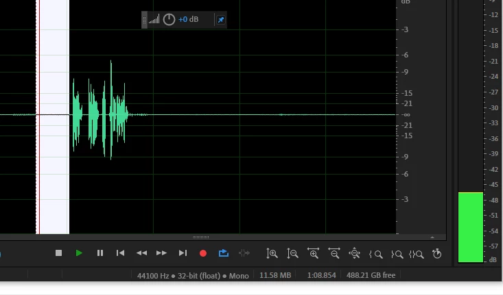

I am trying to get my recordings to meet ACX standards without success despite trying everything suggested in the community forum. I recorded my floor noise and it is very clean - below -60 dB. However, after I record and run the Match Loudness, my stats for ACX look much better but the floor noise suddenly is popping up into the -50's to -40's dB. I try denoise and that does not fix it. See my screenshots for before and afters. Has anyone else had a great base floor of -60 dB then made adjustments to meet the Peak and RMS for ACX only to have their floor noise go haywire? HELP
Baseline floor stats
 Punched and rolled voice into the baseline floor recording
First settings I used to match the loudness to meet ACX standards
As you can see the floor dB was hitting the -40s after the adjustment and denoised it as well.
I then tried these settings after resetting back to the original track
 Results after application of the setting Match loudness and denoising. As you can see the floor is still too high.

The Audio/Amplitude and Compression/Dynamics effect has a Gate on the left side. The other two tools of that are Compressor and Expander. It's a very useful tool.
You set the Threshold for the dB level you want to cut below, and of course the typical attack, release, and hold controls.

It's only showing the main part of your images, not the side-ways part that would show the floor stats.
Have you tried using a gate to cut off below X dB?
